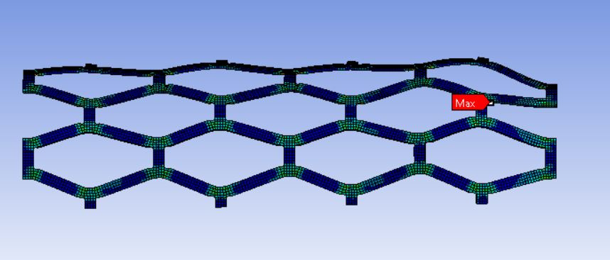

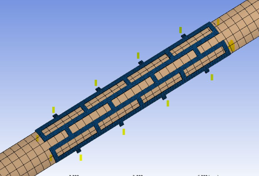

SubscriberPlease show what you mean by bent deformation only on one side.n -
August 9, 2020 at 7:49 pm
aqibdrmc
nHi peter,nnthis is the model. I have used friction less connection between balloon's top surface and stent's bottom surface. The stent has friction less support on highlighted 12 faces. I have used displacement (X=1.5,Y=0,Z=0) on the bottom surface of the balloon with cylindrical co-ordinate system. The radius of the stent is 1.5mm and I am trying to expand it by increasing the balloon radius. The model works fine with steel and Magnesium with bilinear isotropic hardening. But it does not work for PLA with tangent modulus of zero. If i expand the radius by 0.5mm, the simulation works for PLA and I get deformation on one side as the picture.n
Moreover, if I increase the displacement of the balloon to 1.5, the simulation fails only for PLA. Steel and magnesium does not show this type of deformation.n
