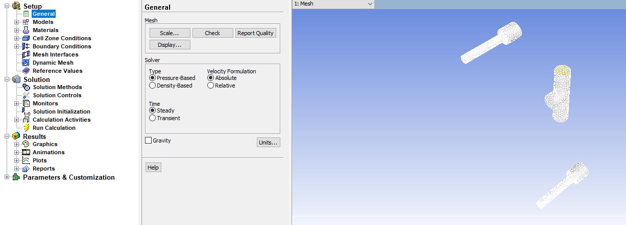

I an very new to ANSYS (engineering student), never used the program however I have been tasked with conducting a CFD for a project. I created the model with solidworks, saved it as a IGES file and import the file to the program. When I am creating my mesh and selecting my conditions i notice that under geometry i have solids and surface bodies. Once i enter the setup phase, only the solid bodies show up. I need everything so my question is how to make those surface bodies solid or if there is any other method i can go about doing this. I'm not sure what information you may need, so please ask and I'll give.Â

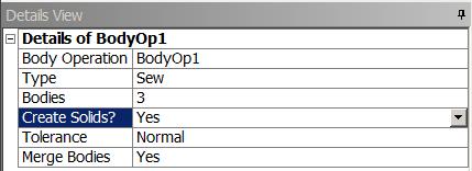

In SolidWorks, use File, Save As and set the file type to Parasolid.
In DesignModeler, use File, Import External Geometry File and point to the Parasolid file.
This is more likely to result in Solids showing up in DM since both DM and SW are using Parasolid.
When you convert from SW to IGES and then from IGES to DM, there are extra conversions of the data and something is lost in translation.
If that doesn't work, then you can take the surfaces and in DM, Create, Body Operation, Sew, and set Create Solids? to Yes.

SubscriberThanks for the advice however both methods failed. It isn't able to create the sew operation.Â
