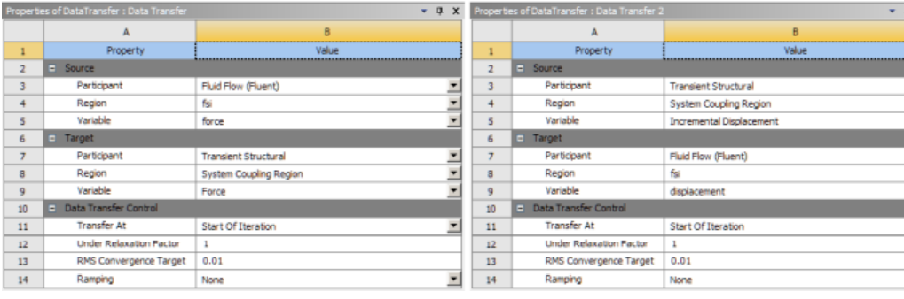

April 25, 2022 at 4:08 pmStephen Orlando
Ansys EmployeeAre you wanting to transfer displacement from Mechanical to Fluent, or pressure force from Fluent to Mechanical.
If you want to transfer displacement from Mechanical to Fluent, you'll only need the data transfer shown in the second image.
If you want to transfer pressure force from Fluent to Mechanical it would be better to use a direct connection and not use System Coupling:

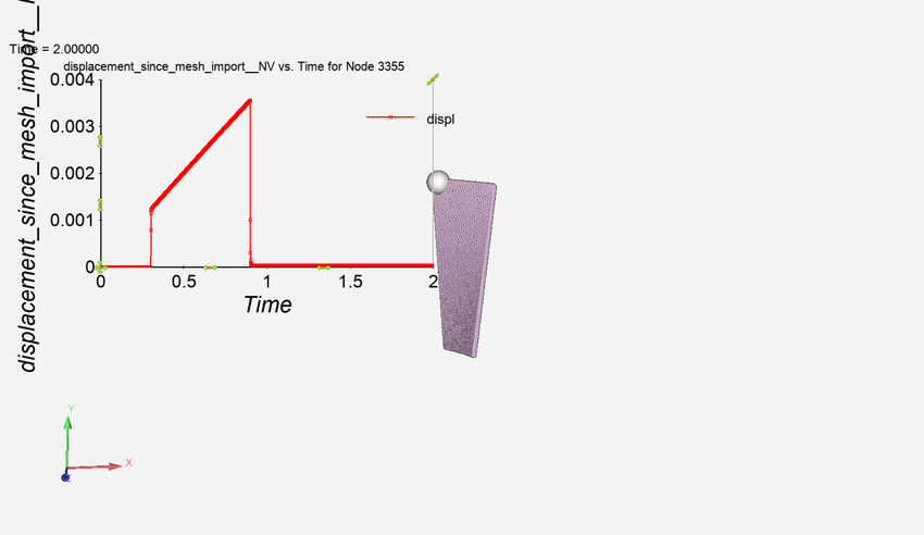

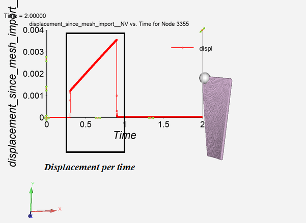

yet I tried two way FSI, to plot displacement of this blade tip per time.

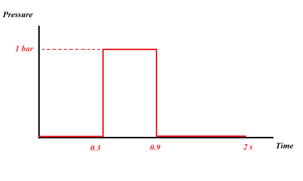

The Fluent has a transient pressure inlet with a step function where at 0.3 sI used Static structural.
the step time was 0.001, the full time was 2 s and the relaxation factor =0.55 for both side.
I used Ensight to visualize the results
I have two questions:
I expected that the result (picture below) should be a step function not a ramp in the interval between 0.3 and 0.9 ? what would be the reason for that? I performed one way FSI using external data transfer and it seem that the feedback was a step function so why there is this divergence in results between the two methods?
How to make System coupling GUI work with more than 2 solvers? it is so so low and I need it faster to run for different Pressure inlet functions
May 29, 2022 at 10:46 pmUniversityofQLD
Subscriber@Mohammedlamine
Where are you measuring your pressure? If you impose a step function at the inlet, areas downstream need to build up to that pressure over time so you will see a ramp. Can you post pictures of your inlet condition, your measurement and where you measure it?

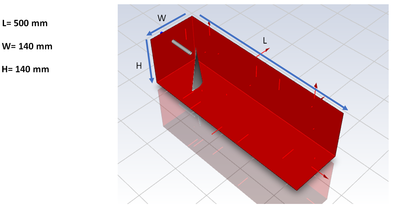

May 30, 2022 at 11:29 ammohammedlaminemekhalfia
SubscriberThanks again for the feedback.
for the pressure, I am measuring the pressure at the boundary (Blade surface) and the Inlet, The pressure evolution shows a step function.
My inlet function is shown in the below picture.
The Domain is as follows: The inlet is the pipe Inlet
For the Displacement, I am measuring that on the Blade tip. and this was the problem why the result is showing a ramp at the top
