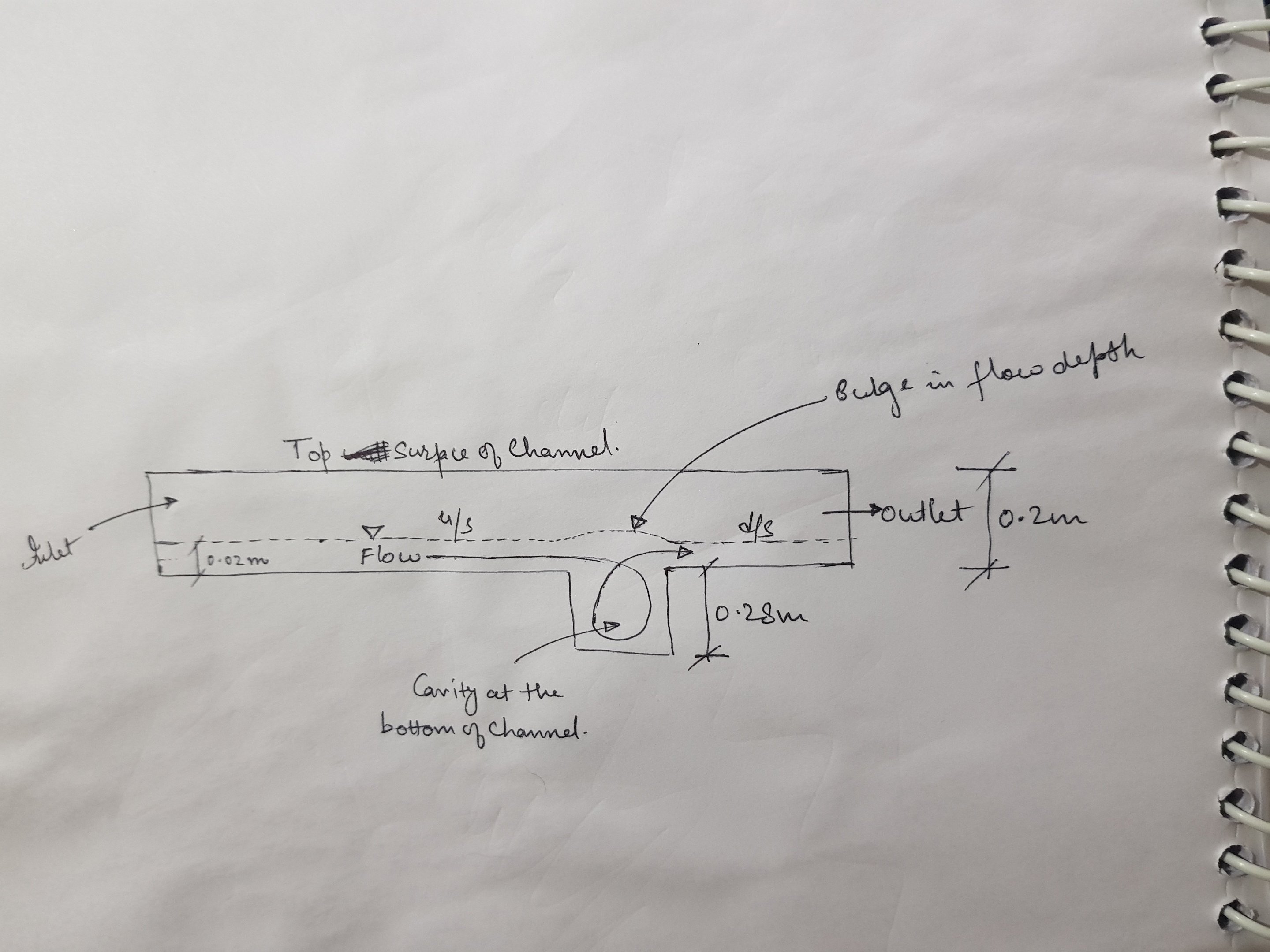

      I want to perform steady-state flow simulation in 2D open channel using VOF model. Can I use the SYMMETRY boundary condition at the top wall of the open channel? The image of the model is attached. I am a beginner so somebody please kindly help me out. I have used pressure inlet and pressure outlet at the top wall of the open channel but nothing worked.
    • Karthik Remella
      Administrator
      Hello
      Yes, you can treat it as a symmetry condition as long as the normal gradient at the boundary is zero. Please have a look at both Rob’s and Amine’s answers. If you expect the waves to interact at this boundary, then modeling it as a pressure outlet makes more sense. It depends on what you expect would happen at this boundary.
      Hope this helps.
      Best Karthik
    • SALMAN
      Thank u very much for your guidance.
      While performing experiments under uniform flow conditions, I observed a small increment (bulge) in the flow depth above the cavity (see figure) but the depth of flow remains uniform in an open channel at upstream and downstream of the cavity.
      Actually water is flowing horizontally in an open channel from inlet then it goes into the cavity and when the cavity gets filled with water than water will start flowing towards the outlet without wave formation.
      Can I use symmetry bc for the top surface of channel?
    • DrAmine
      But put it far wary from the region of interest. You can model it as symmetry. Actually I usually natural pressure opening but again as far as possible to avoid affecting the flow through flow reversal. Symmetry can affect if put very near through artificial reflection.
