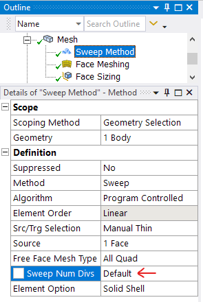

I have this simple CAD part ( parallelepiped). I am trying to sweep it with automatic thin/manual thin taking element as solid shell. I am not able to, Ansys gives me the error message as shown in the figure. But I think the part satisfies the source and target but still not able to mesh, I do not know why ! Can anyone help me?

Forum ModeratorYes, you are correct, only thin sweep creates solsh elements. Have you defined sources correctly in manual thin method? Also, the model looks a bit thick to me for thin meshing:n-AniketnHow to access Ansys Online Help DocumentnAugust 7, 2020 at 7:16 amApurbaDeka
SubscriberHi Aniket! Yes, I tried all possible source selection. I am attaching the CAD file. I let you try to do thin sweep. Please let me know what do you think? Model dimension as follows:nlength: 800 mm and thickness: 60 mm. nI think it qualifies for the solsh element. I will go through the link you sent. Thanks!nnAugust 7, 2020 at 10:48 amApurbaDeka
SubscriberHello !nThe problem is resolved thanks to your link ! It was failing the third requirement of thin model sweeping - The model must have an obvious "side" that is perpendicular to the source and target; all of the side areas must connect directly from source to target. nIn the model if you notice, the angle between the largest and smallest faces are 90.1 degree in one side and 89.9 degree in other side. So when I create a new body with 90 degree it works.nI have another doubt regarding mesh size in the same problem. If I use mesh size less than equal to 27,8 mm my mesh fails and if I use mesh size more than equal to 27,9 Ansys creates mesh with solsh element. Is the mesh size relate to the thickness and the lenghth of the model? Here thickness :60 mm and length:800 mmnArrayArraynAugust 7, 2020 at 4:22 pmAniket Chavan
Forum ModeratorAugust 9, 2020 at 2:40 pmApurbaDeka
SubscriberHello Aniket ! Thanks for the reply. I changed the sweep number division upto 20 ( through gradual increasing and checking) but it does not help. It seems like for a particular thickness, the mesh size is limited to a particular size. nViewing 7 reply threads- The topic ‘Sweep meshing with solid shell element’ is closed to new replies.
