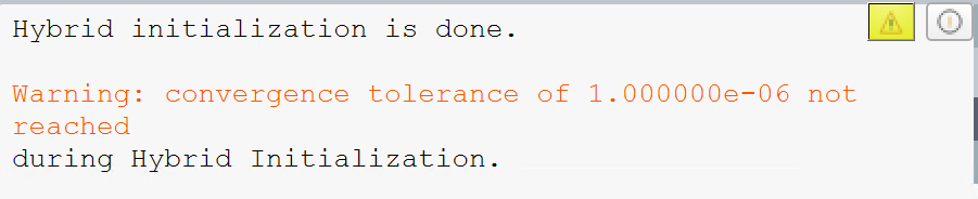

      Thank you for your help. On performing initialization, theres a warning says below screenshot. Can this affect my simulation, if so how to resolve this. Thank you.
    • NickFL
      Hybrid initialization is solving an Euler solution for your problem to help orient the velocity field better than a fixed value everywhere in the flow field. There are several reasons why you could encounter the error. Look at the flow field that is produced simply by the hybrid initialization (meaning, do not iterate any further). Does it make sense? Sometimes there will be a false boundary condition or other problem that is apparent due to this warning.
      If everything looks alright, then you can continue. Keep in mind, this is only an initial "guess". We will iterate towards our final solution. The final solution is independent of the initial guess (well, it should be in most cases).

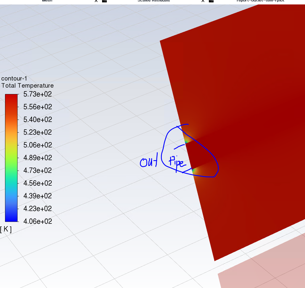

      Thank you so much for the help. I continued the simulation. But why did my contour display seems all are red. Is it reasonable? I made the same question in this thread Heat transfer result for pipe outlet (ansys.com)
      Inlet temperature 573K and computed temperature around 571K. Pipe diameter is only 1.219meter and land is 10m diameter. I expect this should not became all red.
      Another thing is does contour display also one of the basis of a good simulation. I came up converged model. Appreciate your help always. Thank you
      • NickFL
        Where/what is your heat sink? If you are running a steady-state simulation, without a heat sink everything will move towards the inlet temperature.
        As for you question about convergence, we cannot say. You have to take a look at the residuals and see if they are decreasing to a constant value. It is also best to monitor several other relevant quantities during the simulation to determine if the solution is converged.
