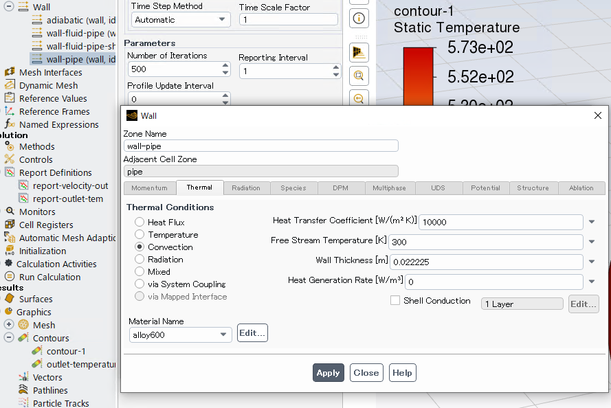

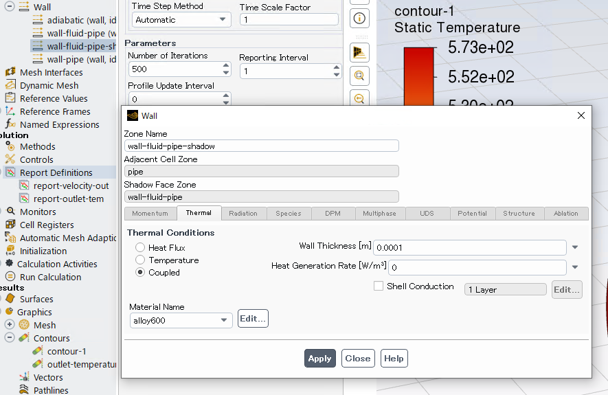

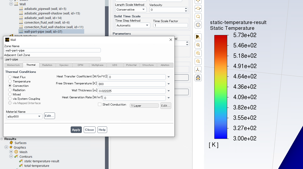

      I do like to ask question, as I set my boundary conditions, it seems that what I inputted in the free stream temperature is also the outlet temperature of pipe.
      What I would like to discover is the outlet temperature of above mentioned conditions. Assuming inlet temperature of 300deg celcius 500m below ground. with assumed pressure of 28Mpa what should be the best way to discover the outlet temperature of my case.
      Appreciate your help and to anyone who may have an idea really appreciate.
      Thank you so much
    • Nikhil N
      First thing, be aware that you have selected convection under thermal condition. This signifies that there is convection on the outer side of the pipe wall, and it is not for inside. Moreover, you have set the heat transfer coeff. to 0 which I think won't make any sence here. If you want to give constant temperature, select temperature under thermal condition and set appropriate value. Once the simulation is over, you can use report definitions to find out outlet temperature.

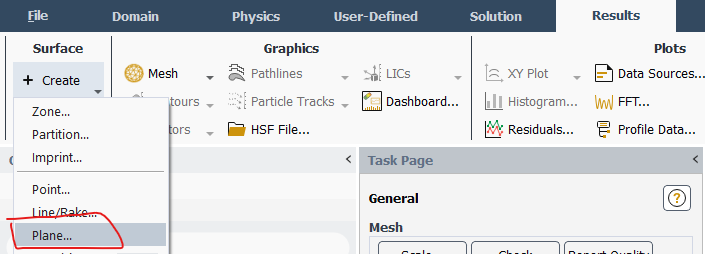

      Another question I`d like to ask is I would like my contour to be displayed in a way that it will be section in the middle of my solids. Aside from creating semmetry plane in the design modeller, is there any way that I can show it.
      Appreciate your help always.
      Thank you.
    • Nikhil N
      It is not recommended to create a plane in DM or at the CAD level. Instead, create a plane in Fluent itself and display the contour on it. To do so, navigate to Results - Surfaces - Create - Plane. Please refer to the attached image for guidance.
    • Mae Kristine Labendia
      Hi Nikhil Narale,
      Thank you again for your help. It works.
      Hi Nikhil Narale

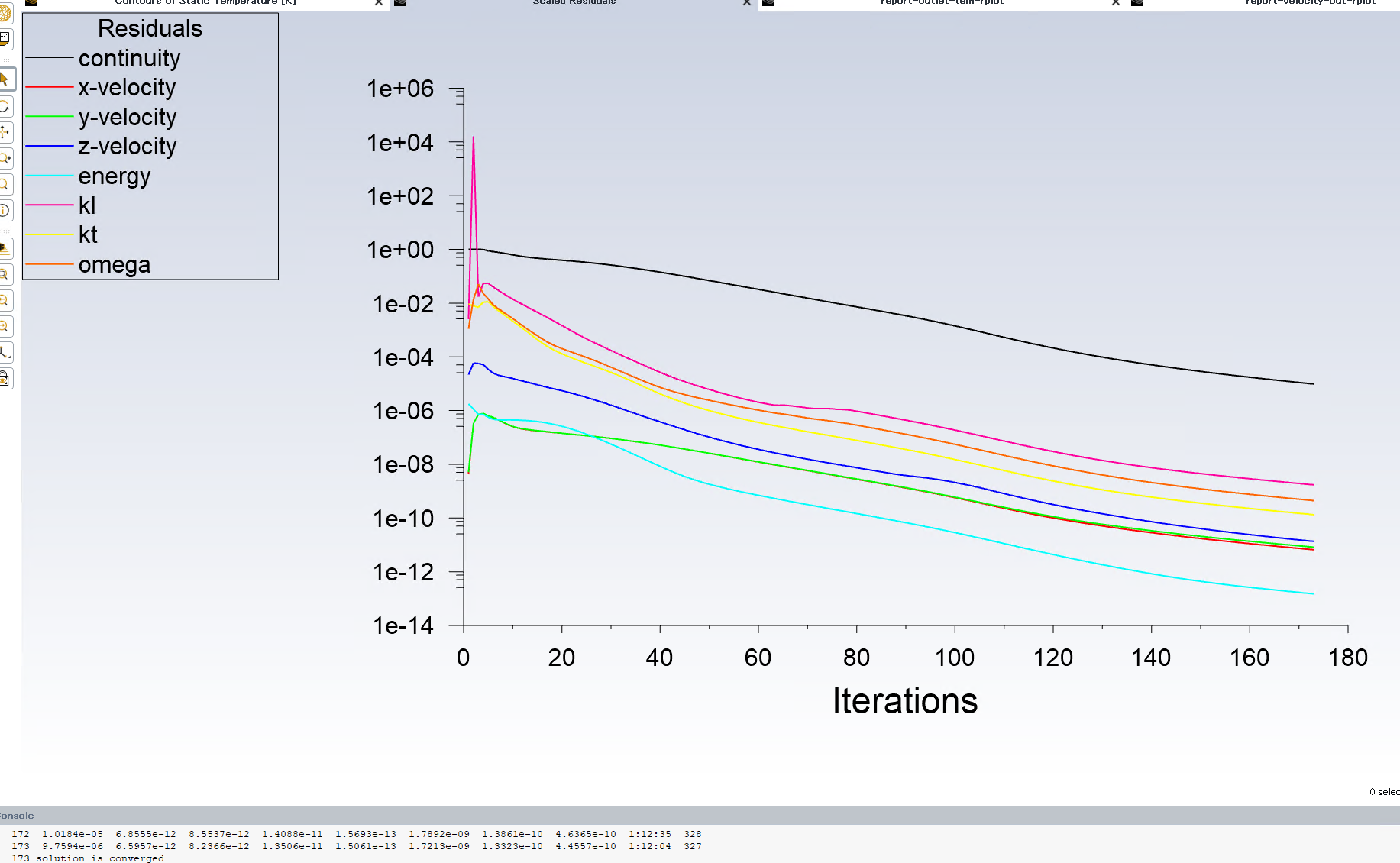

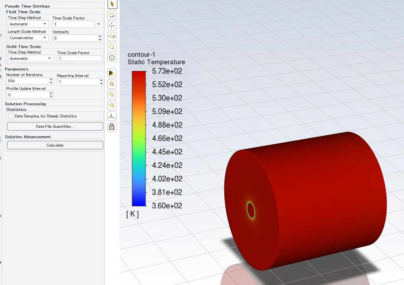

      Sorry for lot of questions. I always get losed since this my first ever analysis experience. Why did my simulation contour have all same color? I had the result, from inlet temperature of 573K  and inlet velocity is 5m/s flows through 10m pipe and result temperature outlet is 571.4K but the color of my simulation are all red in contours though my solution is converged. Is it reasonable or does something wrong with my input. Pipe with water vapor and assuming drysoil sorrounds pipe. Kindly see attached. Thank you always for your help.
    • Nikhil N
      The temperature on the wall appears to be constant due to the boundary condition. However, you may want to check the temperature contour on the mid-plane.
      The temperature drop from 573 K to 571.4 K, which is a decrease of around 1.6 K, it seems like a small drop in temperature. Is this what you expected?

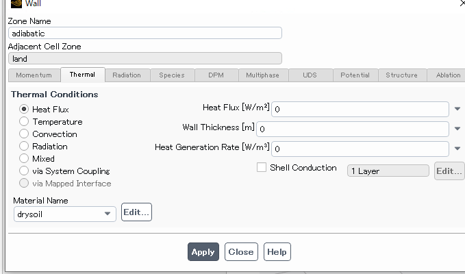

      Hi Nikhil Narale

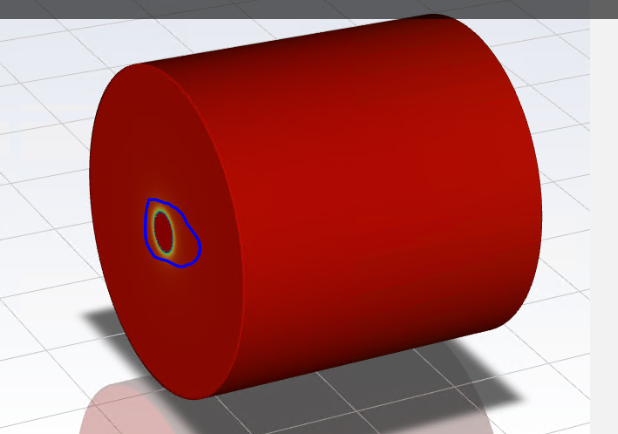

      Why is it that my land also getting red in color. I think it should not be as wide as that cause the fluid that carries hot liquid is only at the encircled one. The red one inside the yellow green circle is only the fluid that has 573K temperature
      Thank you.
