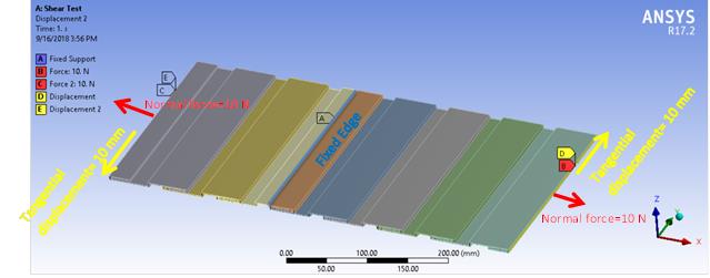

      We need to perform shear test study. Our model consists of multiple components that have capability to slide on each other. We need to define No separation or frictional contacts type between certain surfaces. Model fails to run!
      Please see the attached pdf file for clarification.

      Not everyone here can open attachments, so below is an image of what you attached above.
      The reason the solver fails in this shear force model is that there is no resistance to the force, therefore the displacement is infinite, which causes the solver to stop.
      You can have a solution if you use Frictional contact with a non-zero coefficient of friction, AND apply an X direction tension force to create a normal force on the contacting faces, so that there will be something for the coefficient of friction to be multiplied by to generate a shear force AND apply a shear displacement, not a shear force, since if the shear force is greater than the frictional force, you will again have an infinite displacement.

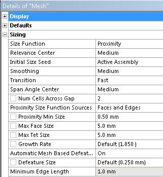

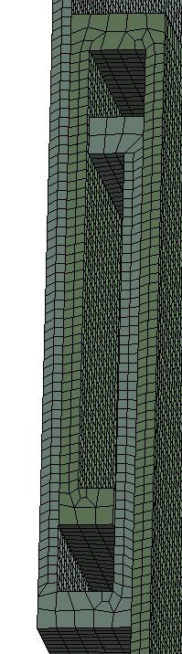

      You have to set the mesh to have more than 2 elements through the thickness. This mesh has only 1 element through the thickness, which is inadequate.
      Use the Mesh Sizing setting for Proximity with 2 elements across the gap with a minimum gap of 0.5 mm.
      Unfortunately, this is going to create a very big model that will take a long time to solve.
      You will be better off extracting the midsurface from this solid body and meshing shell elements on a surface body.

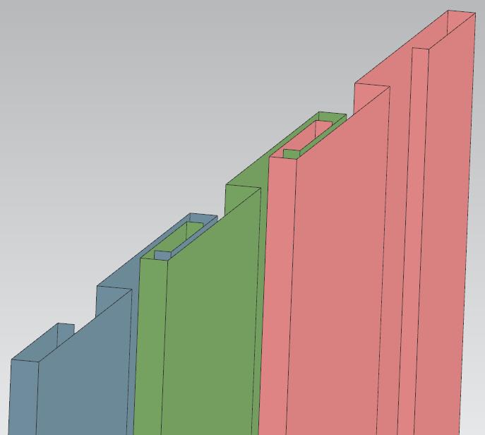

      Hello Peter,
      I made your suggestions, 3 components of shell. Issues are, I couldn't make more than one layer of mesh elements as you did for these shells.
      Also, I had to define surface contact regions manually since the system couldn't detect them automatically.

      The solver failed because the contacts were not closed when it started.
      The contacts were not closed because you didn't turn on Shell Thickness Effect.
      The contacts were not closed because you didn't expand the geometry until the point where the faces are touching.
      I explained previously that you can only start solving when the faces that have to push on each other are touching.
