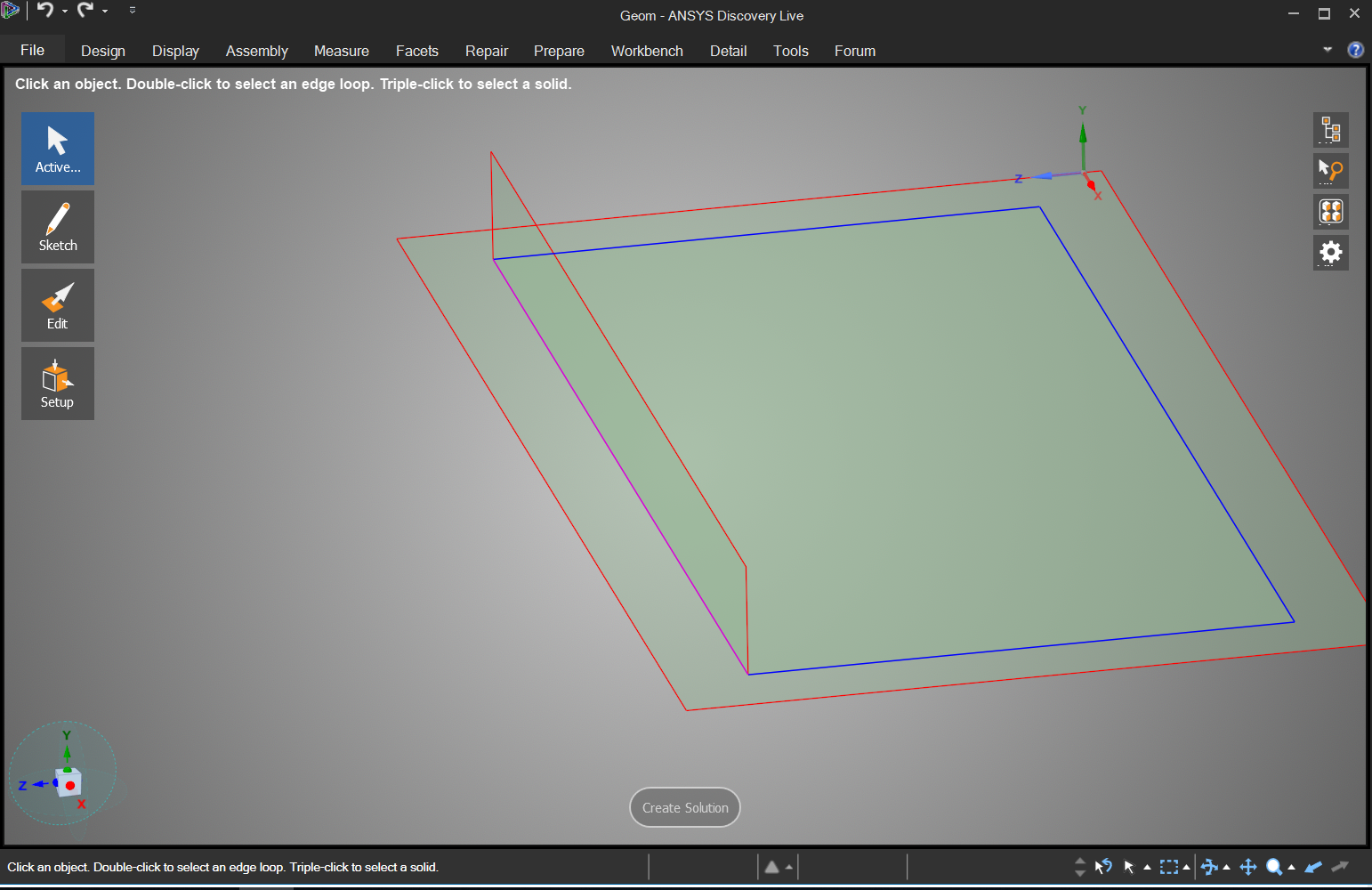

      Hi
      Is it possible to work with shell models, surfaces in discovery live or in discovery AIM?
      I tried it in Live but there is not possibilities to launch any simulation workflow.. it remains grey...
    • Naresh Patre
      Hello SandorToaso
      Surface bodies are not supported in Discovery Live. However, they are supported in Discovery AIM.

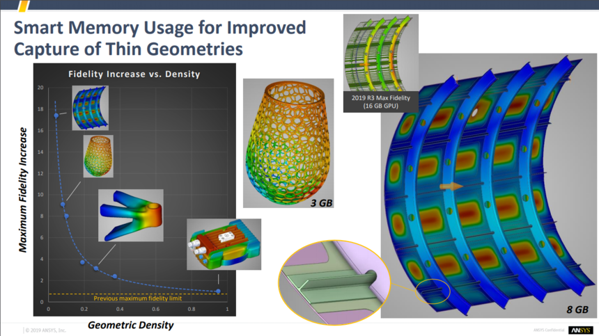

    • Ethan Geometry Rabinowitz
      Hi SandorToaso , Discovery Live is now much better at capturing thin geometry, so you can always thicken it to a solid with Pull or FacetsThicken if pull fails and then simulate it.
