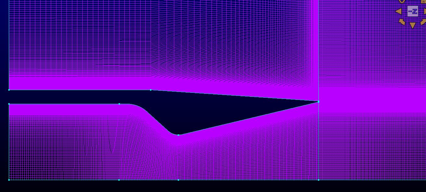

      I went from a simulation where I wasn't satisfied about the results I got regarding the pressure coefficient results and the flow separation position. So I came back to my mesh and refined it nicely, with y+ consideration. My new results with a pressure-based method are way better than before, the target y+ is good and the pressure coefficient near the wall finally fits the experimental one.
      BUT, when I switch to Density-based method, things go wrong. Simulation fails to start well and diverges very quickly. I tried everything : CFL number variation, changing from AUSM to FDS, using standard or hybrid initialization etc.

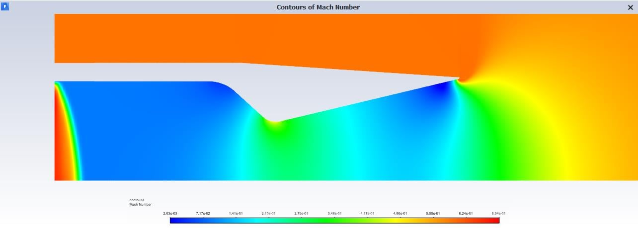

      I screened the first iterations :
      Do you have any idea what could be the origin of this failure?
      Best regards.
    • Kalyan Goparaju
      Can you try using 1st order schemes to launch the simulation and if/once the solution settles, change them to 2nd order?

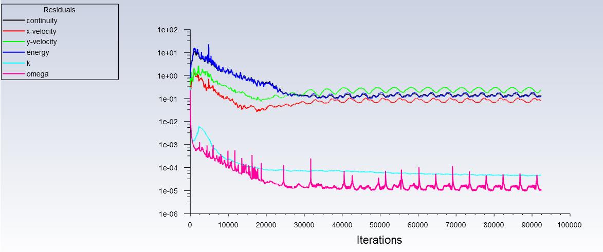

    • killian153
       After 9355 iterations :

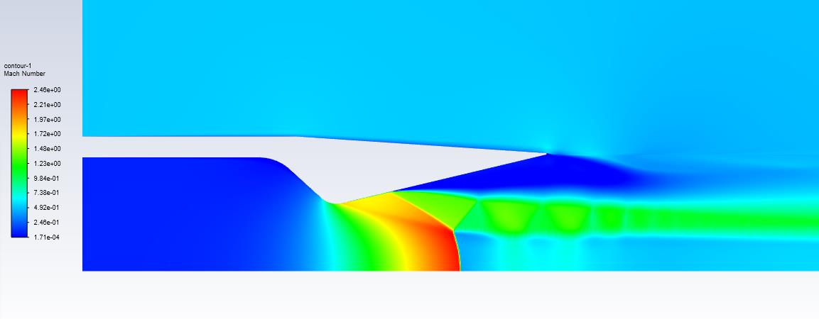

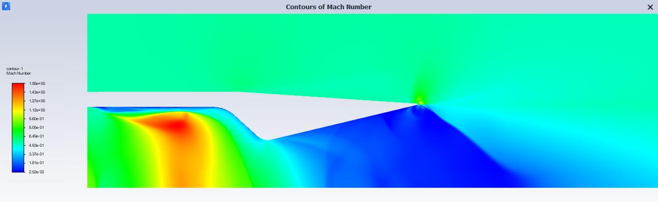

    • killian153
      Hello rahkumar,
      Here's what I get with a 1st order to 2nd order simulation (Implicit):
      The solution looks good but the result is not right, as you can see below with the orange curve (the flow separation occurs too early):
    • Kalyan Goparaju
      Shock waves are discontinuities in the flow which create instabilities. By using first order, you are artificially adding a lot of dissipation and ensuring that any numerical instabilities/disturbances are smoothed out. It is always best to "establish" a reasonable flow-field and then switch over to high order schemes to ensure stability of the numerical scheme.

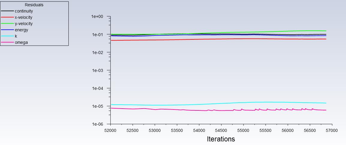

    • killian153
      Hello Kalyan,
      So to solve my problem I went back to the mesh as you recommended. I decided to reduce the number of boundary layers at the nozzle wall, in order to make the shock diffusion easier while keeping my targeted y+. Indeed, my thoughts were that too many thin boundary layers could make shock wave attachment to the wall really difficult.
      And it worked! I reduced the boundary layers to 20 with a 1.2 growth rate and now I have good results even when starting directly with 2nd order.
      Just a question: how do I know when my solution is converged/finished? I mean, as you can see below, it seems that after 40000 iterations I have a some stability and cycle pattern.
      Thank you!
    • Kalyan Goparaju
      I am glad that you were able to work things out. The default setting for convergence is for the residuals to fall below a threshold of 1e-03. If there is any unsteadiness in the flow, the residuals generally start oscillating. This behavior is usually the cue for conducting a transient analysis to check for the cause of unsteadiness. If you know for a fact that you should get a stead-state solution, but the residuals are flat/oscillating instead of monotonically going down,  I would recommend reducing the under-relaxation factors for the 'higher' residuals and checking if that helps stabilize the simulation and take it to convergence.
