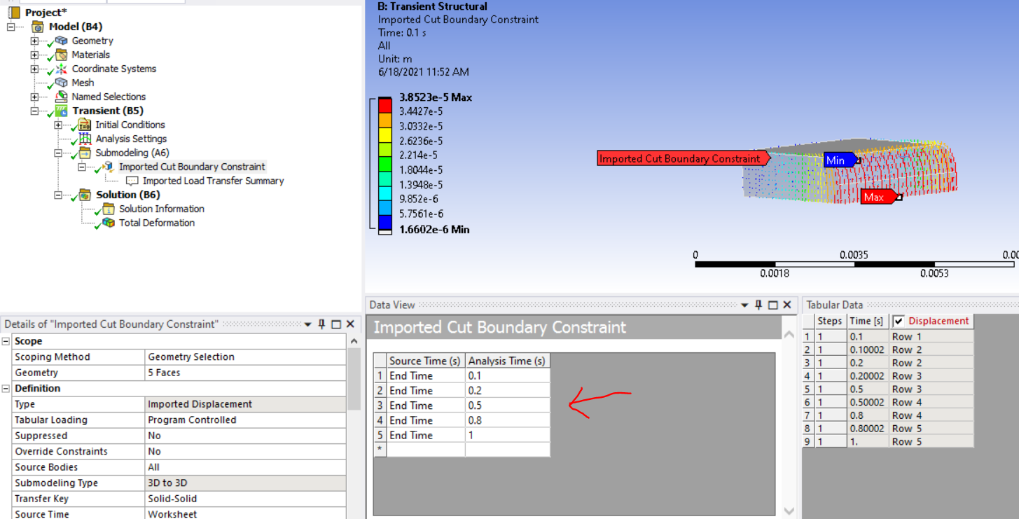

      I use submodeling in static analysis and import displacement for submodeling...
      If I run a dynamic transient analysis, is it still feasible to import the displacement with time history to do submodeling?
    • 1shan
      Yes you could map cut boundary constraints at multiple load steps or time intervals while performing a sub-modelling analysis.
