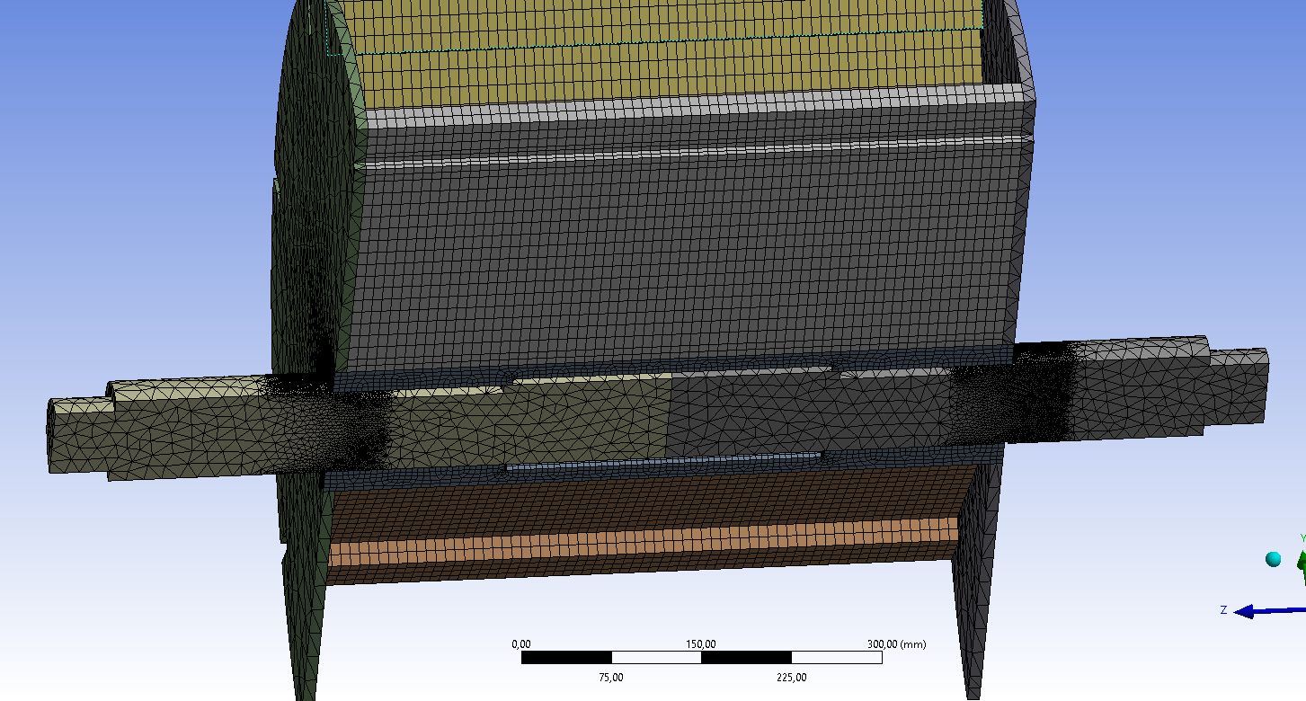

      this is full model (axialsymmetric) with remote displacement on bearings and pressure load on top of rotor

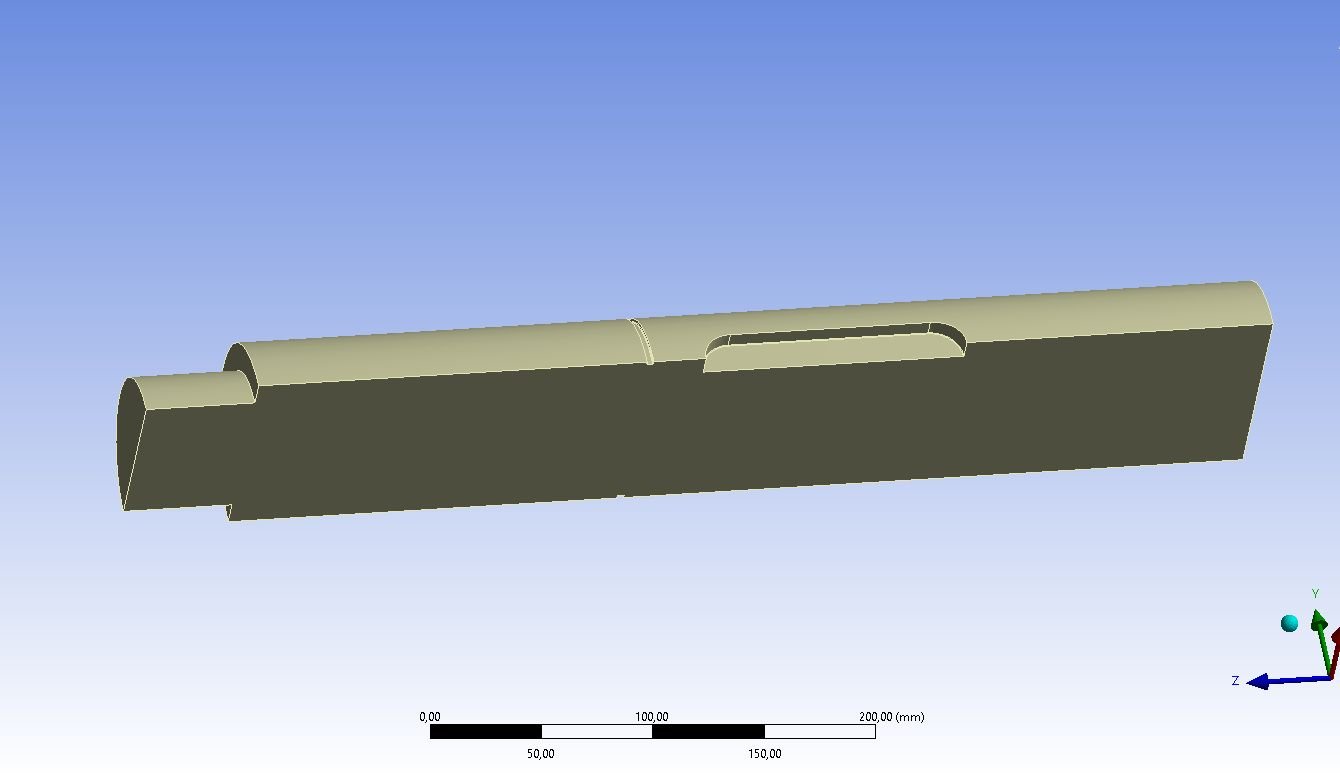

      this is the part of shaft i want to analize

      How to set up sub-modeling and insert displacement for the above shaft? Which face i have to select to transfer displacement: Symmetry plane, contact area, cutted face? Thanks
      Have you solved the coarse model?  You must have a solution on the coarse (large) model.
      You must cut away from the coarse model, using planes or surfaces, all the parts that are touching. You can't just pull the shaft out on its own.
      Show the solution of the coarse model and the geometry of the cut away submodel.

      Already done, the only problem I have is that when I right click on submodeling-insert I have 3 options: insert cut boundary constraints, insert cut boundary remote force, insert cut boundary remote constraints. I choose the first option, but I don't know which face to select
      insert cut boundary constraint.
      You pick the faces that were created when you cut from the full model.
