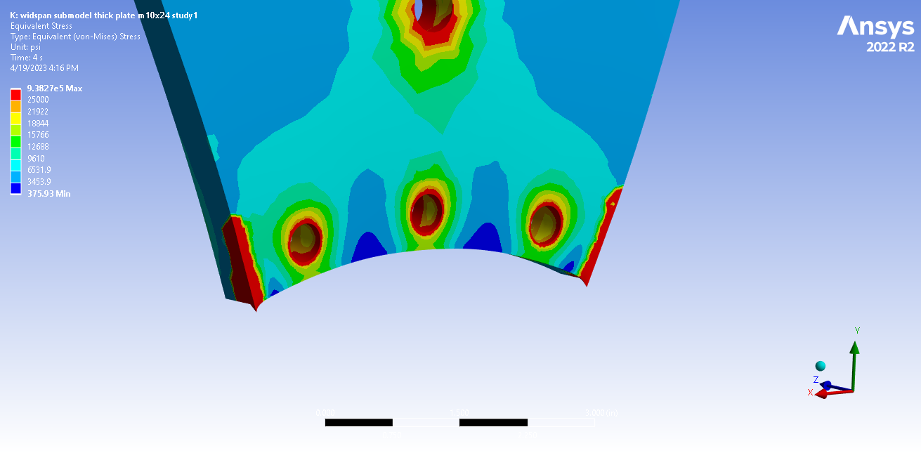

      I am having particular issues with singular-ish behavior at the edges of my boundary cuts... below is a screenshot of the behavior.
      There is additional geometry not shown, but essentially it is a flange that bolts into the 3 holes shown...
      Would cutting through a contact region(s) like this on the edges (contact = plate to flange) cause this behavior?

      Hi Stuart,
      You should not have cut bcs defined at the region of contact/ cut through contact region.

      Thanks Ashish.
      If i place the cut boundaries "far enough away" from the region(s) of interest (stress concentration), is the simulation results still valid around the stress concentration?
