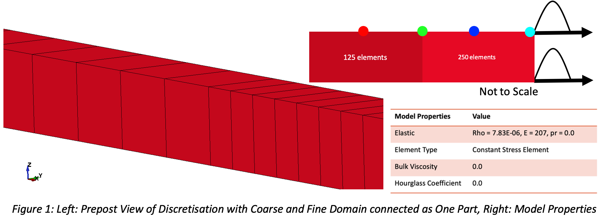

      To help depict the issue, a benchmark of 125 coarse elements and 250 fine elements has been created. The coarse elements are of dimensions 1x1x1, whereas the fine elements are of 0.5x1x1, both discretising a submodel of 125x1x1 (but one part ID). A typical half sine pulse has been applied to the fine domain at those four nodes at x = 250.

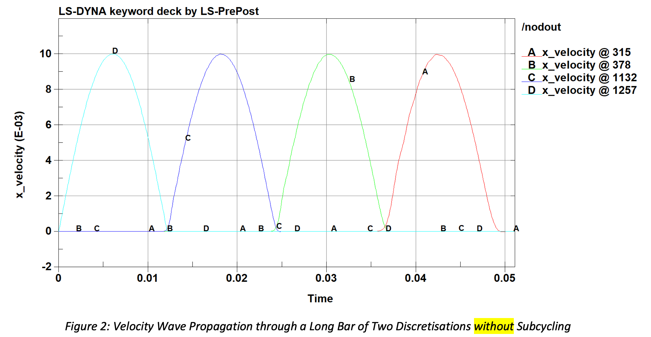

      Without the CONTROL_SUBCYCLE keyword we see the half sine pulse propagate smoothly through the bar, seamlessly passing through the boundary. Plots correspond to the 2D model depiction above where the coloured circles are nodes on a selected edge.

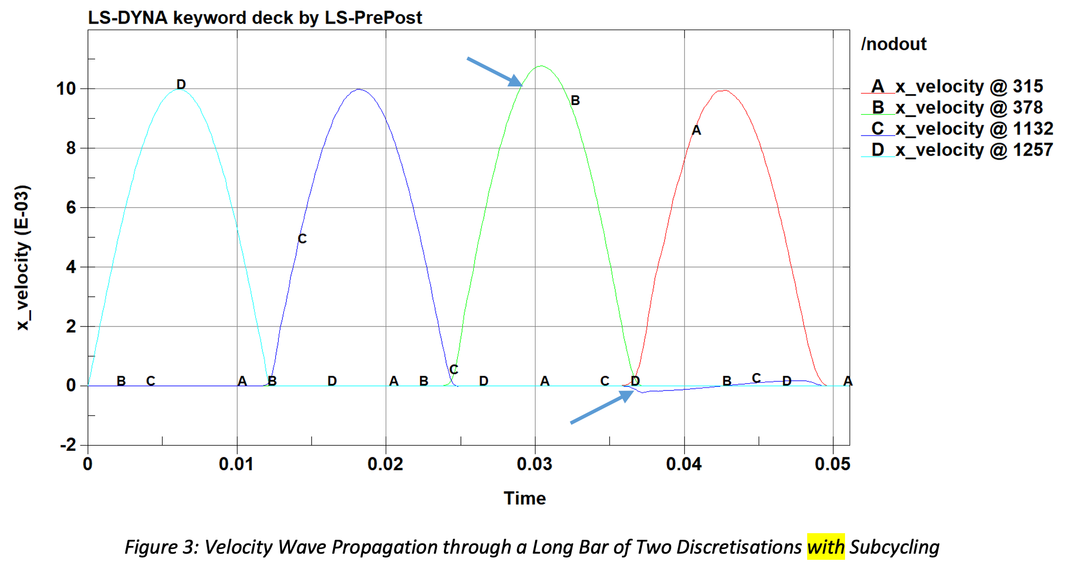

      With the inclusion of CONTROL_SUBCYCLE_2 we see an increase in velocity (Figure 3), solely at those nodes at the interface (as depicted by Node 378). One also observes nonzero values at those nodes in the fine domain once the wave has propagated to the interface between the two submodels.

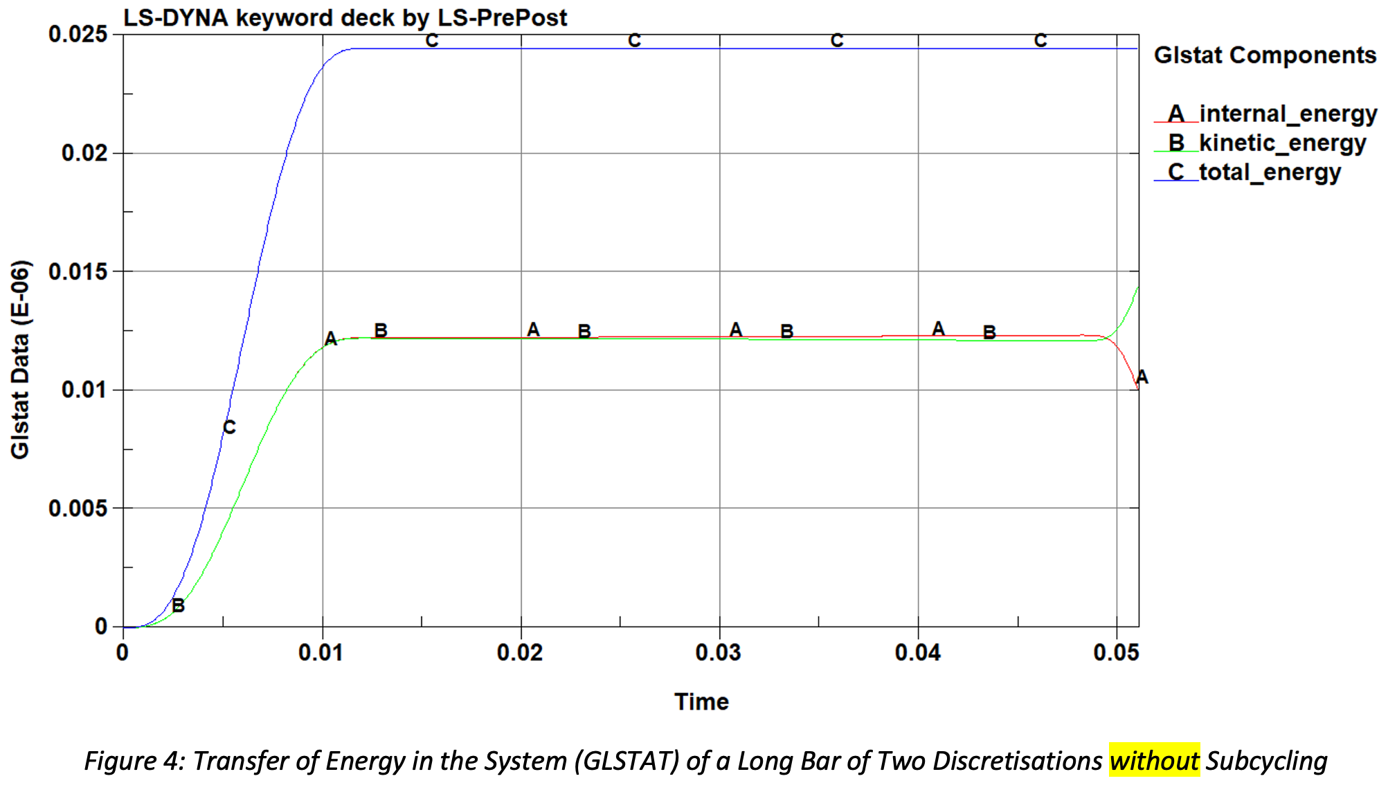

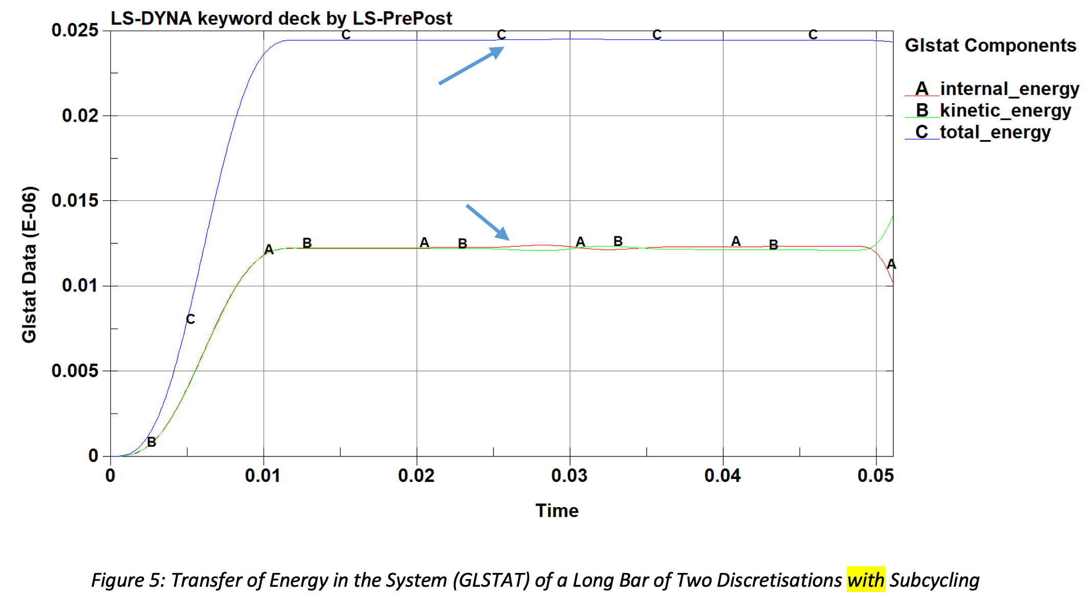

      To try to understand the algorithm implemented in LS Dyna, we have also analysed the energy transfer throughout the system in Figure 4. Once the half sine velocity pulse has been fully applied to system (after 0.01ms), a nominal change in energy is observed.
      However, once again if we look to compare the simulation with the CONTROL_SUBCYCLE_2 keyword, one observes an increase in total energy when the pulse interacts with the interface (around 0.03ms). From Figure 5, it is evident that there is a transfer of energy at the time of arrival of the pulse at the interface, leading to an increase followed by decrease in internal energy, simultaneously an increase and decrease in kinetic energy. This oscillation is not seen when the CONTROL_SUBCYCLE keyword is removed.
