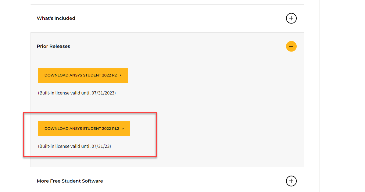

February 2, 2023 at 7:35 am
Shi Kun
SubscriberHello, Vishal Ganore, I have try to grab the license-extended product from the website of your company, however, I fail to it. Can you help me and give me the website of the Ansys student 2022R1 license-extended product .
Thank you so much.
February 2, 2023 at 9:15 am
Shi Kun
SubscriberRe-install ANSYS is a good choose and you can install the new version directly without uninstalling the old version. Initially, I am worried that there will have trouble in opening the old case and data, however, everything is ok.
February 2, 2023 at 11:04 am
vganore
Ansys Employee-
February 3, 2023 at 1:18 am
Shi Kun
SubscriberThanks, you're really efficient. I've found it according to your guidance.
