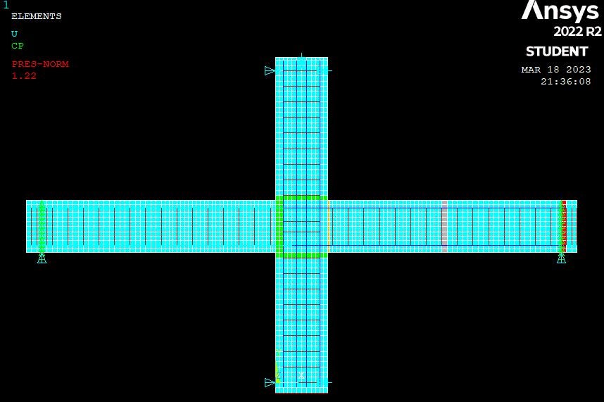

Stuck at load step 1
TAGGED:
    • H Nor

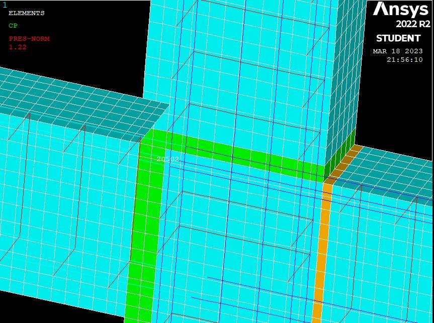

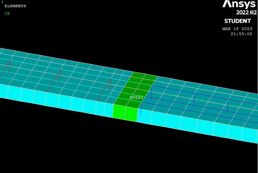

      I have a problem of unconstrainted model with error "  *** ERROR ***     SUPPRESSED MESSAGE    CP =     286.375   TIME= 17:51:27
       There are 2 small equation solver pivot terms (e.g., at the UX degree
       of freedom of node 20502).  Please check for an insufficiently
       constrained model. "
      This is a half model of interior beam column joint. i am not sure how to fix it.
      from the J12_1.out file.

    • Chandra Sekaran
      May be unconnected to your question but why are you getting load step 1 again and again with increasing time. Are you getting out of /SOLUTION module after the SOLVE command and then getting back in? If you are, you are not continuing the analysis from time 10 to time 20 to time 30. Instead you are solving new at time=10, time=20 etc.
    • mjmiddle
      It seems you also have rigid motion, because not enogh constraints. Can you upload the input file or database?
    • H Nor
      Thank you for the replies. What happen was that there was element with wrong nodes, and i have already fixed it. Thankyou for your times.
