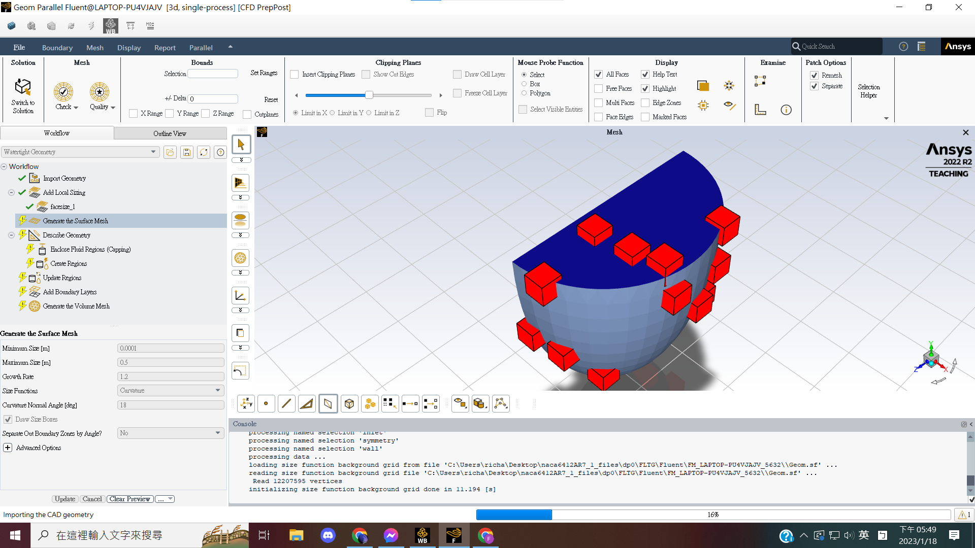

Forum ModeratorI'd look carefully at the minimum cell size, given I can't even see the marker I'd question how sensible a choice it is. The courses tell you how to use the code, the size markers (usually) tell you that you're about to overcook the cell count.

SubscriberI got the same problem : it gets stuck on “importing CAD geometry” for a couple hours.. I tried different sizings, same thing.. very weird

Forum ModeratorCan you test a simple geometry? Just means we can eliminate the CAD readers and/or path as possible causes.
