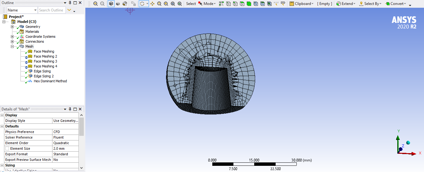

SubscriberI am trying to do the structured meshing inside out on a Femoral Head but I am getting bad results. Wondering if anyone can suggest to me how to overcome my errors.
May 11, 2021 at 4:46 amKeyur Kanade
Ansys EmployeeYou will need to do more splitting in DM or in SpaceCLaim to get good structured mesh.
Please check following videos
Ansys Meshing Sizing:
https://www.youtube.com/watch?v=w4q6q8nKF3U
Ansys Meshing: Decomposition for hex meshing:
https://www.youtube.com/watch?v=P19GOTQWmc0
Regards Keyur
