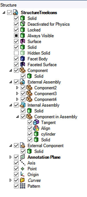

      Do you have a chart which outlines the explanations of the differences on structure tree icons. Say when an icon has a circle with a slash through it ?

    • mg
      BKokosza
      This is about 2 years old, for SC, but may help.  The 'circle with slash' could be the 'Deactivated for Physics' icon.
