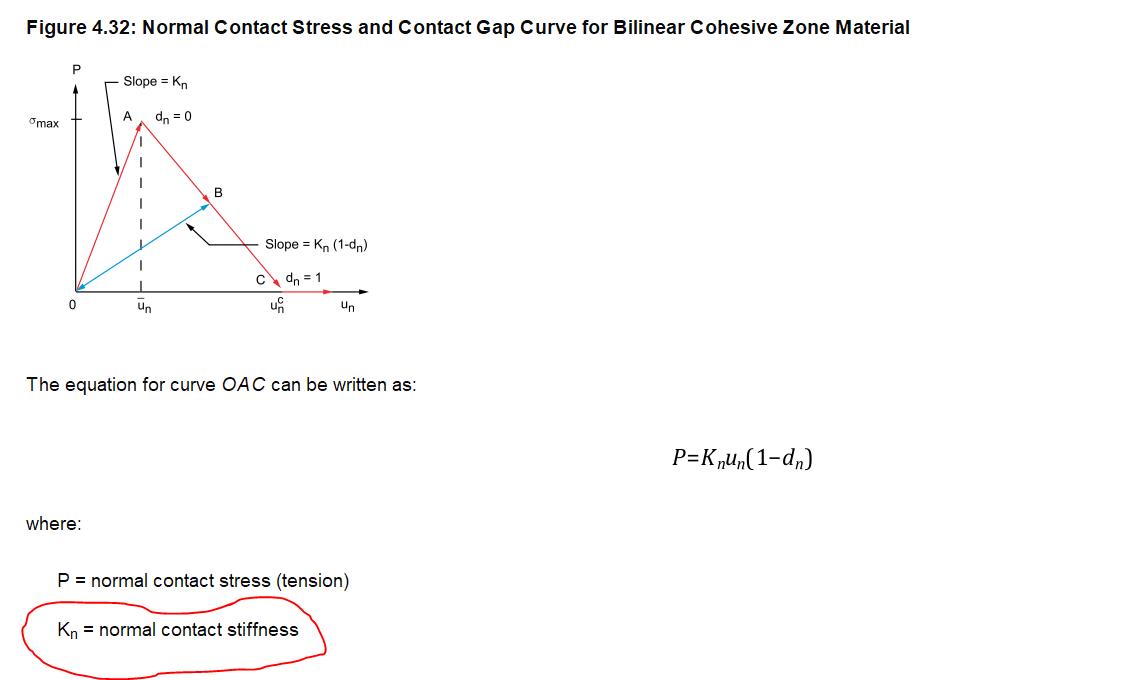

      Isotropic elasticity will be used for the base materials not the cohesive zone materials. So you cannot combine it with CZM.
      If you are using the Separation Distance-based debonding option of CZM, that Young's modulus you applied in Isotropic elasticity for base material will influence the normal contact stiffness, and in turn affect the initial slope Kn of the CZM.

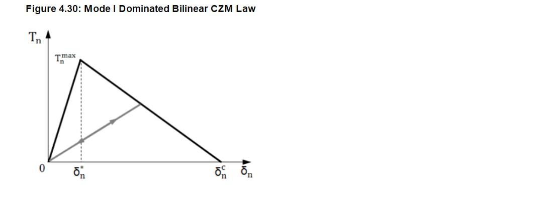

      To achieve your purpose, you can try "bilinear for interface delamination" in CZM. Although the initial stiffness is not a direct input, you can control it by defining the "Ratio", which is the ratio of delta_n_c over delta_n_star shown in the figure below. This Ratio is the same for both mode I and mode II. Please let me know if this is clear. Again, you can refer to this page for more information: cohesive zone model

      Yes, the ratio is correlated to the elasticity of the interface. The initial stiffness (the slope of the ascending part of the line) in bilinear law can be taken as Young's modulus. It equals sig_max/delta_n_star, and delta_n_star = delta_n_c*Ratio. (Sig_max, delta_n_c, and Ratio are inputs)

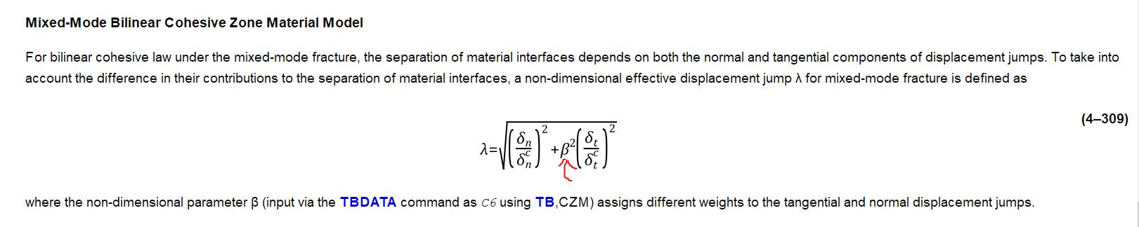

      When there is mixed mode, the mixed-mode separation is calculated using mode I and mode II separation by the following equation, and beta in the equation is the weighting parameter. This can also be found in the link I shared in the previous post.

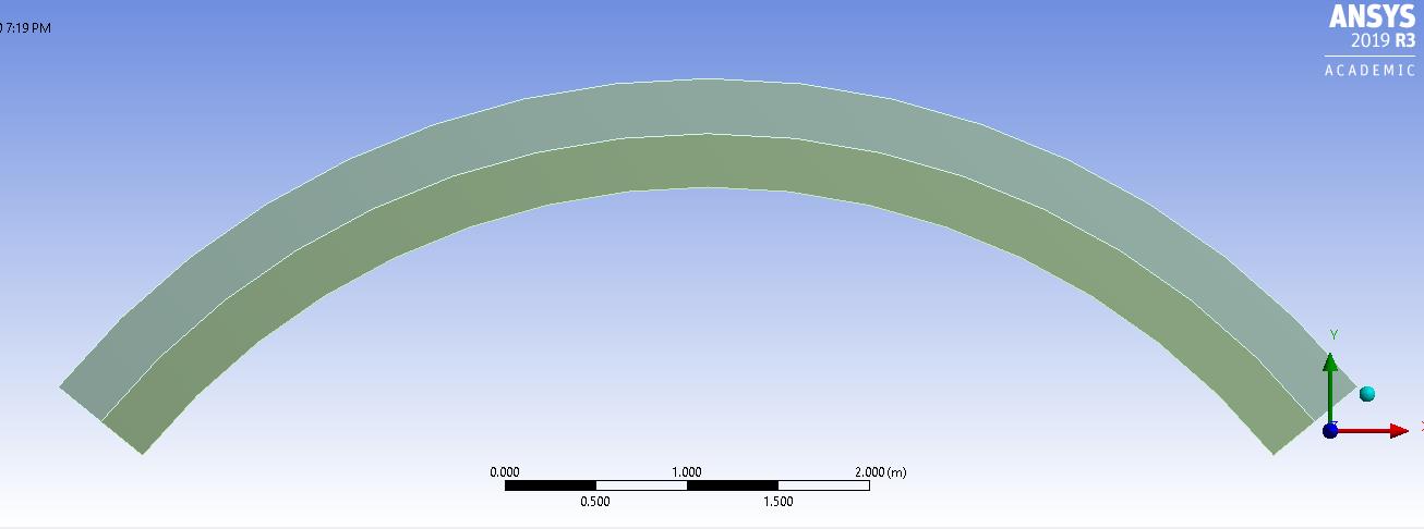

      I tried to import the interface delamination in my model but problems occured both for matched meshing and node matching.For instance, in node matching option I got the message "An error occured while trying to find matching element faces for interface elements.Please ensure that a matching element pattern exists on delamination faces." Below a picture of my geometry is attached.Do you know why this happens?(At the side of interface delamination in project settings, I get the sign that it is properly designed.)
      Kind regards.
    • Wenlong
      Hi konsmi,
      I found this discussion about the same issue. Please let me know if it is helpful.
      https://www.researchgate.net/post/Help_with_ANSYS_Interface_Delamination
      Wenlong

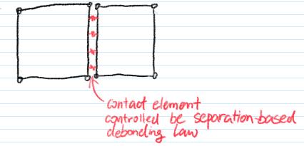

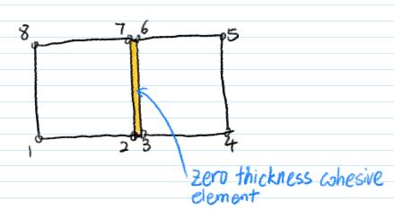

      There are two approaches in Ansys Static Structural I know of to simulate delamination using CZM: interface approach and contact debonding approach, and these two are exclusive
      The interface approach uses "zero-thickness cohesive elements (also called interface elements)" to model the interface properties (an illustration is shown below). In this approach, two solid elements are connected by a cohesive element, and that cohesive element has some stiffness (the initial slope we talked about before), thus no contact is needed.
      The second approach is using contact debonding. In this one, the CZM is modeled by contact element (you don't need to manually create contact element, the solver handles it in the backstage, all you need is to create penalty-based bonded contact).
