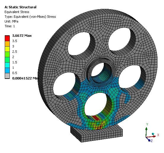

SubscriberGreat detail! The question about what do the wheels roll on should have asked if the wheels ever leave the ground! Impact loads from landing can be significant. Either landing or rolling into a threshold would result in impact loads that can be analyzed in a Transient Structural analysis, but that would come later once the initial Static Structural analyses have been done.
The bodies in the Static Structural analysis are generally Flexible (the default), and are only changed to rigid or gasket for special cases.
What I meant by adding a ground in CAD is something like this:
The piece of ground has a joint to ground, and a joint load applies the force that the wheel should support. Then center of the wheel takes a compression only support. Below is the von Mises stress result.

SubscriberThat's a funny looking deformation. I attached my model above in an ANSYS 17.2 archive if you want to open that.

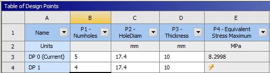

SubscriberI made a parametric version of the wheel, which has 3 design parameters.
Numholes is the number of additional holes after the first. So Numholes = 5 has 6 holes.
Investigating the tradeoff of Stress with number of holes or HoleDiam is now in a table.
The first model was of the full wheel, but all the stress is in the lower half.
The number of nodes and elements is less than the Student limit, but I cut the model in half to increase the mesh density. Note that the Maximum Stress increased due to the smaller elements. This refinement should be continued to ensure the true maximum stress is captured by the model.
This could be cut in half again through the thickness if there is no need for a side load.
