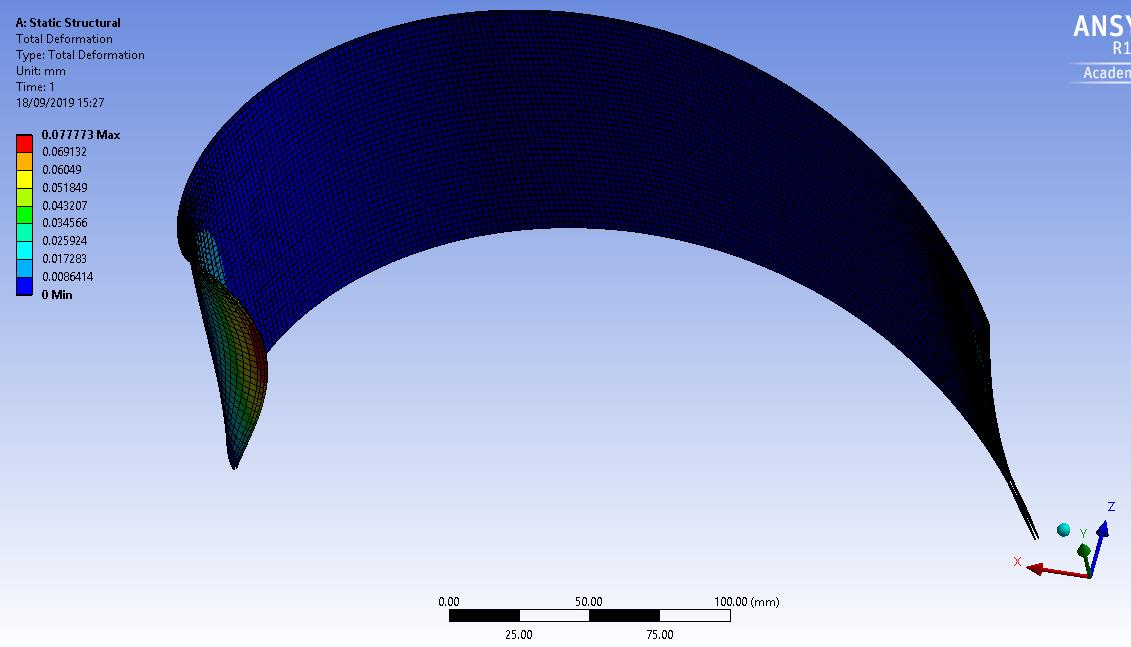

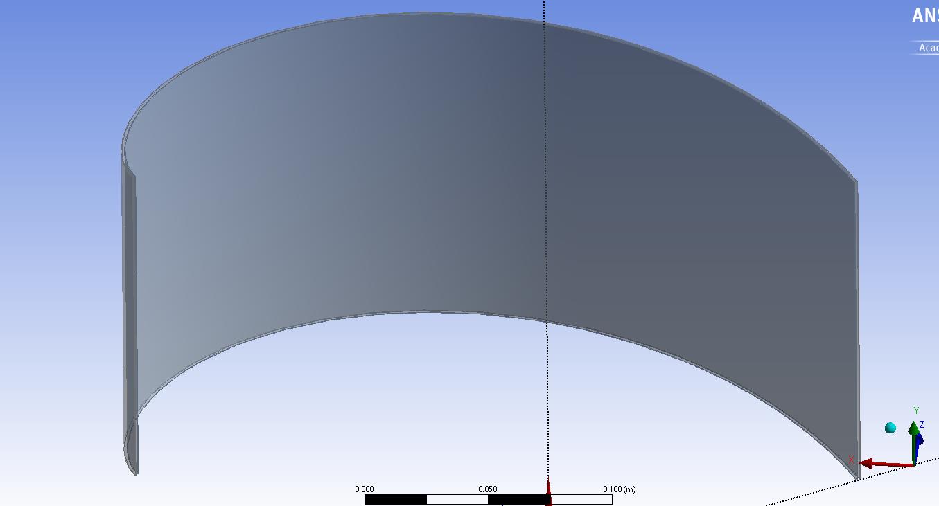

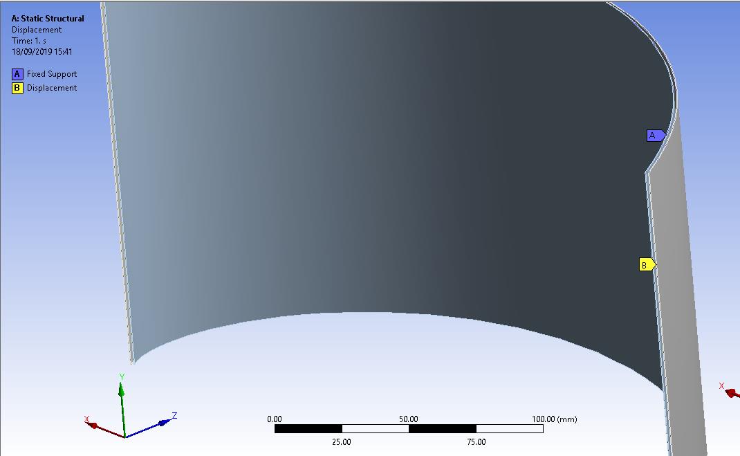

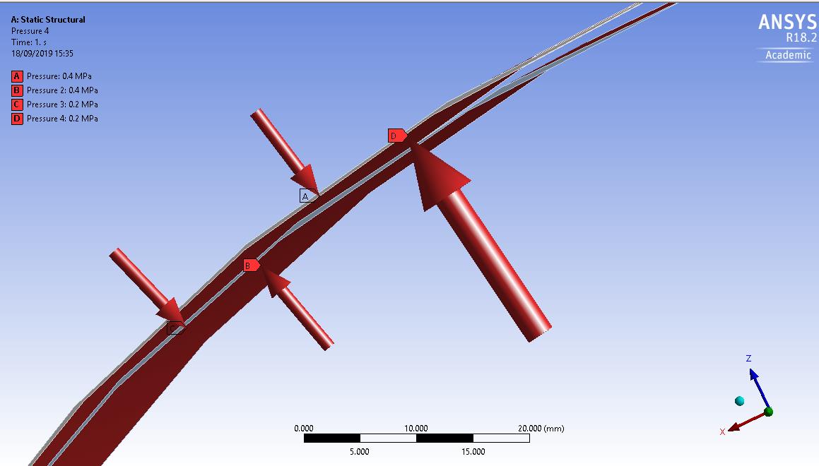

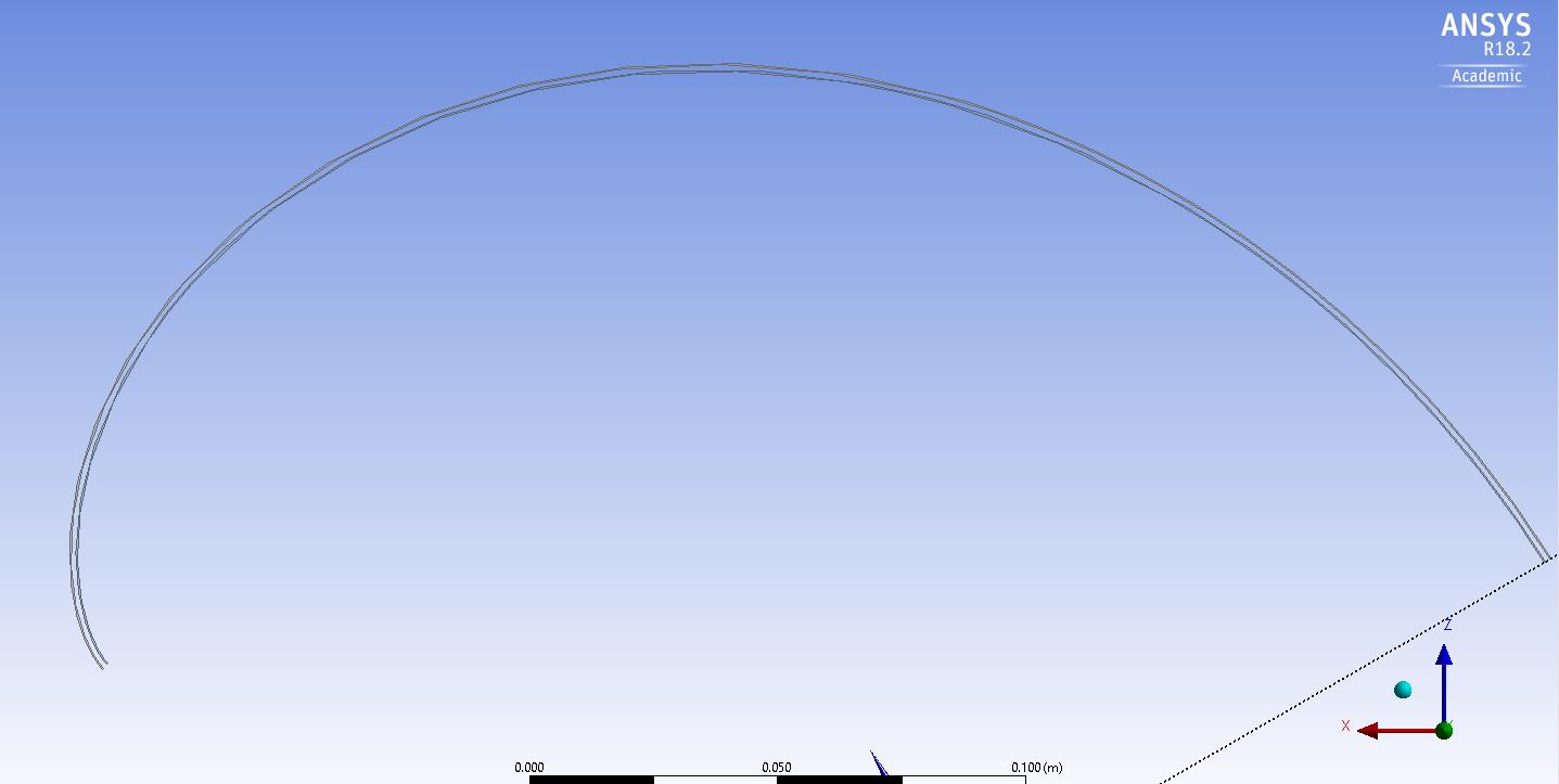

      Hi, I am doing structural analysis for curved stainless steel plate 0.3mm thickness. The gap between them 1 mm. the top and bottom ends fixed support, and other ends zero displacement in Y direction.  the results show not logic direction of deformation because in need to be toward inside 2bar boundary conditions. Also not sure if the value of deformation is correct because it is too small.
    • Khalil
    • Khalil

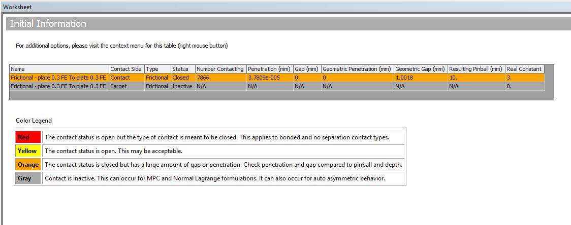

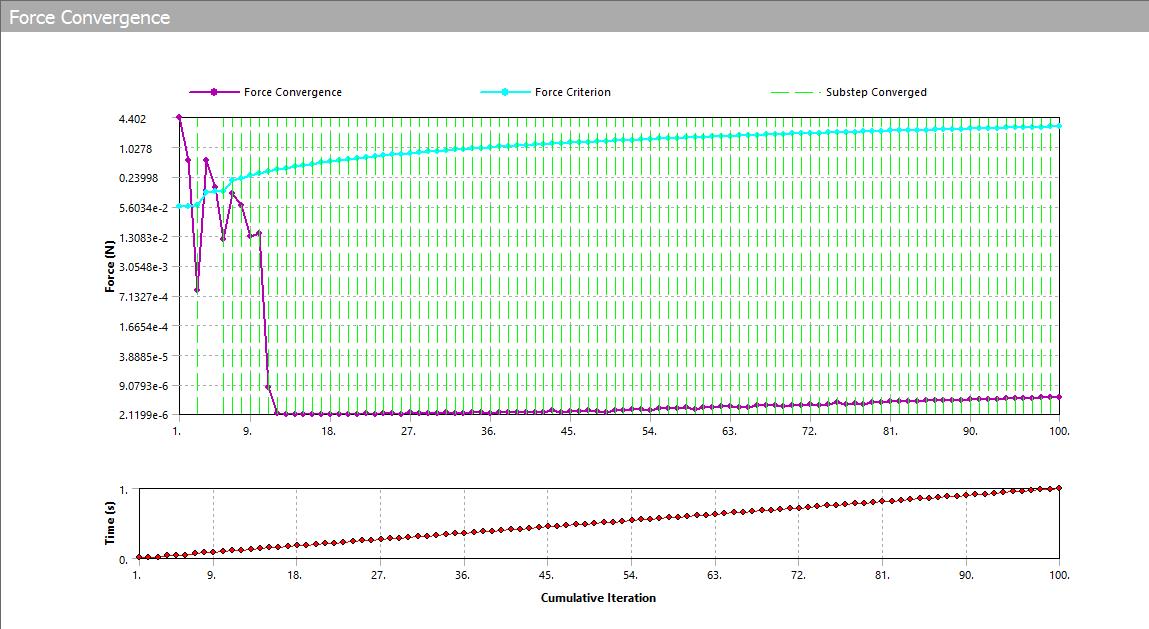

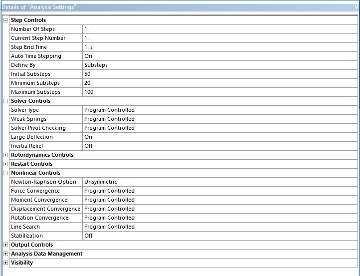

      when I used  Add Offset, No Ramping in contact details the direction become logic but i couldnt have convergence.
    • Khalil
      Any help please.
