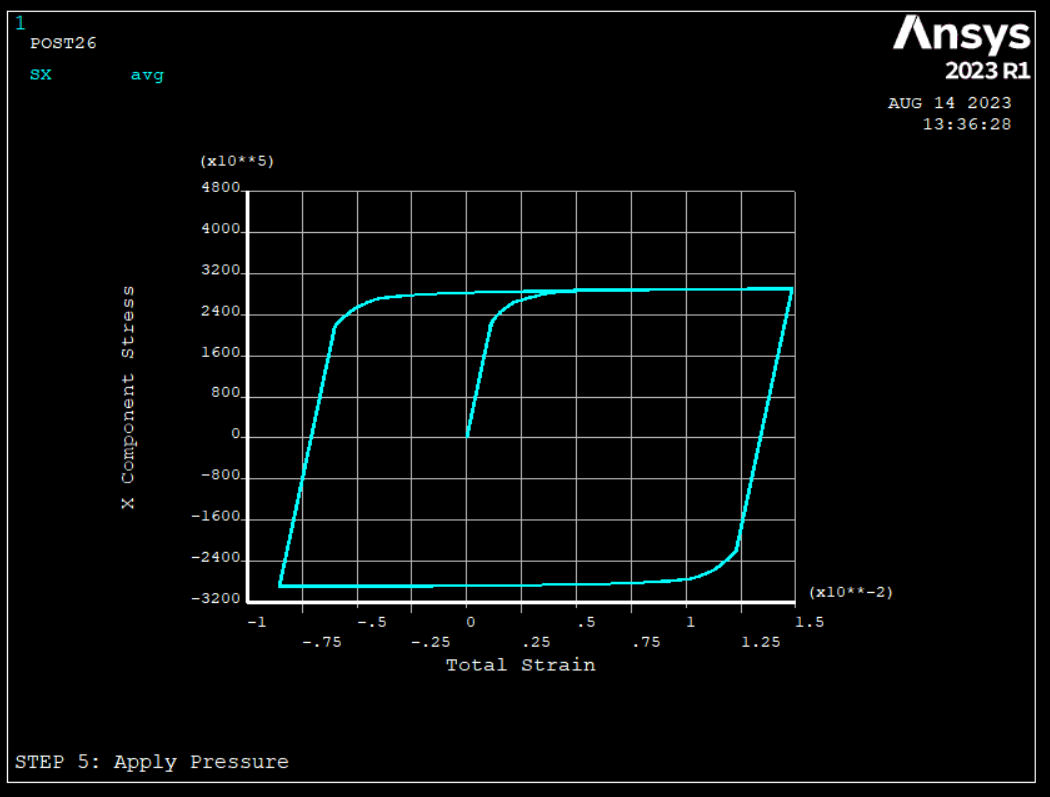

SubscriberHi, I am looking to simulate uniaxial cyclic loading on a specimen to generate the stress-strain hysteris loop through the loading and unloading phase. I am considering multi-linear hardening for plasticity. Is it possible to achieve this graph using Mechanical APDL?Â

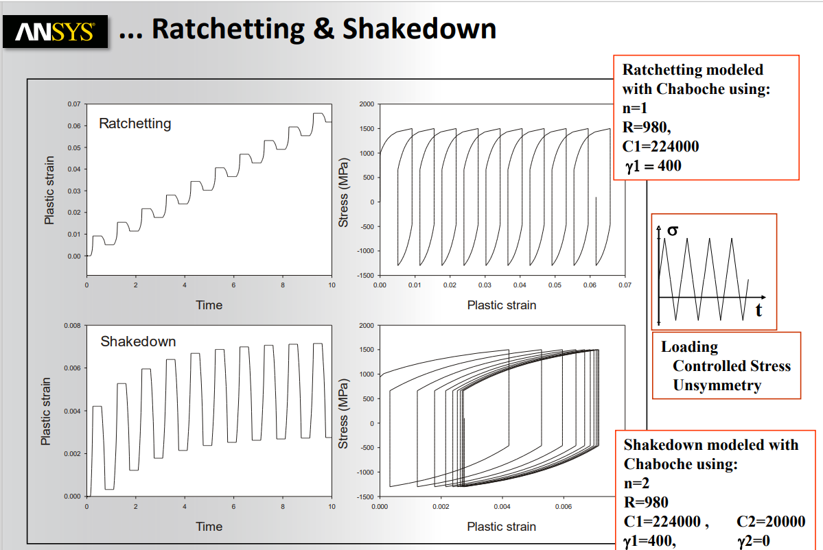

Ansys EmployeeWhat is the source of the hysteresis? Is it rate dependent? Is it large strain or small strain? Is it like ratchetting and shakedown? If so, perhaps you need a Chaboche plasticity model. Please refer to Section 4.4.4.2.3 of the MAPDL Material Reference Guide for more details.

wrbulat
Ansys EmployeeIf you don't intend to mimic the shakedown of ratcheting phenomena that John mentioned...
if you're content to model material response that does not change each cycle, then the input below might suffice your needs:
fini/cleÂ/vie,1,1,1,1/vup,1,z/pbc,u,,1Â/sys,del file*.pngÂÂC******************************************C*** PARAMETERSC******************************************l=0.100 ! LENGTHw=0.015 ! WIDTHt=0.005 ! THICKNESSÂE=2e11 ! ELASTIC MODULUSSy=2.5e8 ! YIELD STRESSÂP=23e5 ! APPLIED PRESSUREÂÂÂC******************************************C*** MODELC******************************************/prep7Âbloc,,l,,w,,t ! GEOMETRYÂet,1,185 ! ELEMENT TYPE, MESHvmes,allÂnsel,s,loc,x ! CONSTRAINTSnsel,a,loc,x,lnsel,r,loc,zd,all,uznsel,r,loc,yd,all,uynsel,r,loc,xd,all,uxÂÂmp,ex,1,E ! DEFINE ELASTIC MODULUSTB, PLASTIC,1,,4,MISO ! DEFINE MULTILINEAR ISOTROPIC HARDENINGTBPT, ,0,1.00*Sy ! YIELD STRESSTBPT, ,0.00005,1.10*Sy ! FIRST STRAIN, STRESS POINTTBPT, ,0.00105,1.20*Sy ! SECOND STRAIN, STRESS POINTTBPT, ,0.00305,1.25*Sy ! THIRD STRAIN, STRESS POINTÂtbli,all,allÂfiniÂÂC******************************************C*** SOLVEC******************************************/soluÂautots,offnsub,250outr,all,allnlge,onÂ/title,STEP 1: Apply Pressurensel,s,loc,z,t,sf,all,pres,PallssavesolveÂ/title,STEP 2: Ramp Pressure to Zeronsel,s,loc,z,t,sf,all,pres,0allssavesolveÂ/title,STEP 3: Reverse Pressurensel,s,loc,z,t,sf,all,pres,-PallssavesolveÂ/title,STEP 4: Ramp Pressure to Zeronsel,s,loc,z,t,sf,all,pres,0allssavesolveÂ/title,STEP 5: Apply Pressurensel,s,loc,z,t,sf,all,pres,PallssavesolvefiniÂÂC******************************************C*** POSTPROCESSC******************************************/post1plns,eppl,eqv/sho,png $plns,eppl,eqv $/sho,close $/wait,2finiÂ/post26 ! PLOT STRESS VERSUS STRAIN HYTERESIS LOOPÂansol,2,node(l/2,,-t),s,x ! SX: X COMPONENT ELASTIC STRESSansol,3,node(l/2,,-t),eppl,x ! EPPLX: X COMPONENT PLASTIC STRAINadd,4,2,3,,eptot,,,1/E,1 ! TOTAL X COMPONENT STRAIN = SX/E + EPPLXÂ/axl,x,Total Strain/axl,y,X Component Stressxvar,4plva,2Â/sho,png $plva,2 $/sho,closeÂ/eofÂ

I am bit confused in implementing the cyclic load. Instead of ramping pressure up and down at each step, I want to used cyclic load with ratcheting phenomena, for example, 100 cycles of stress ratio -1 with frequency of 2. I had a look at Chaboche plasticity model, I will be alright to simulate it but I am not sure to implement the cyclic load.Â

Thank you Bill. I want to mimic ratcheting on my model as well but this would really help me to kick start my modelling.Â
