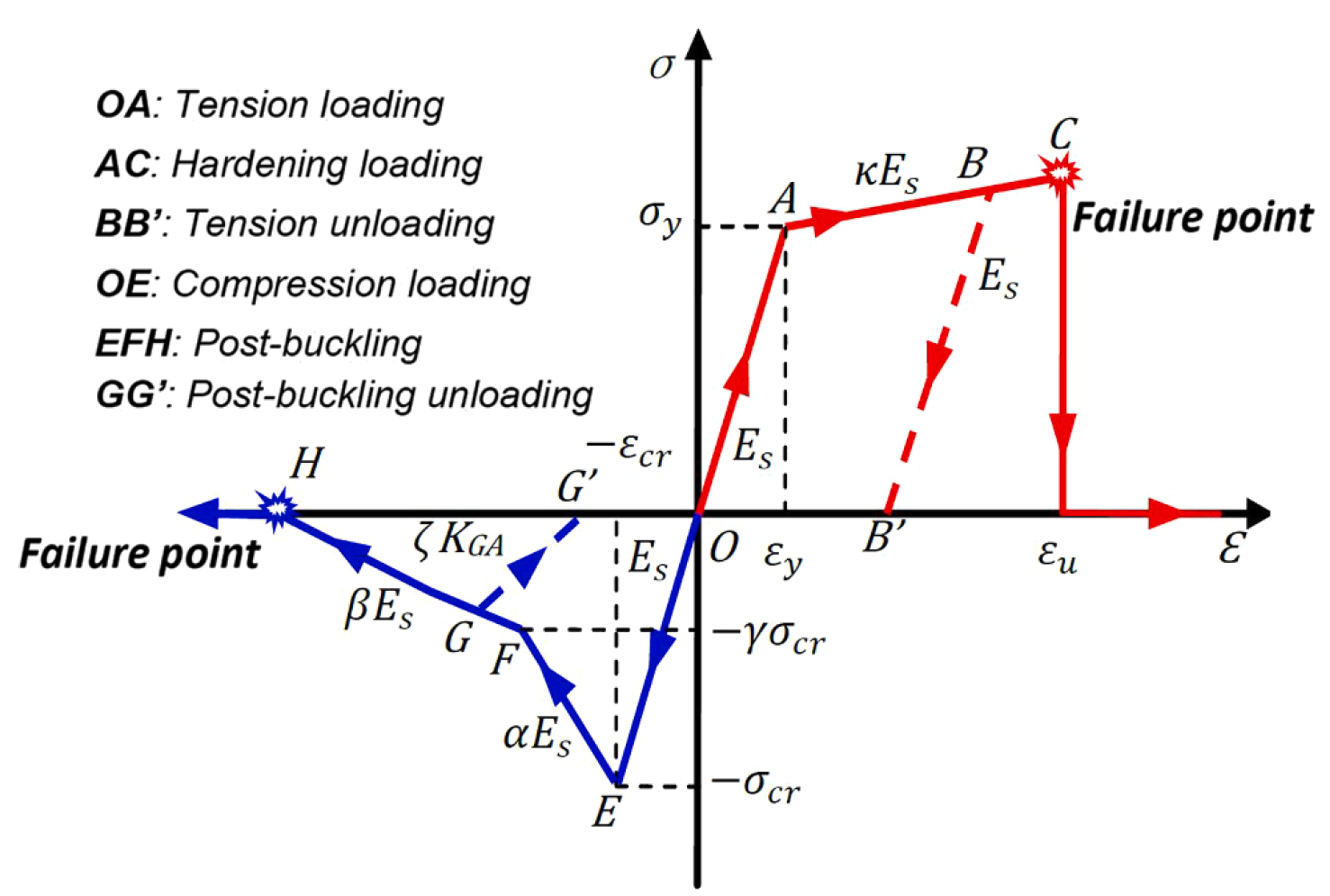

      Hi Ansys Community,
      I have a problem modeling the following strain-strain curves in ANSYS.
      From this curve, it is known that there is a negative stress-strain curve. I want to know how to model this material law in ANSYS.
      The purpose of using this stress-strain curve is to capture the buckling and post-buckling effects of the columns (I use beam188 element for the model).
      Are there any suggestions?
      Thanks,
      Xiao
    • John Doyle
      For metal plasticity, the input should be True Stress-True Strain.  If your test data is Engineering Stress-vs-Strain, you should convert this to True Stress-vs-True Strain.  If you really need to model material softening, you can do this with the Voce Hardening model (Nonlinear Isotropic Hardening).  See TB command (TB,NLISO,,,,VOCE) and Section 4.4 of Material Reference Guide for more information.
      For post buckling simulation, consider Stabilization Damping and/or Arc Length Method.
