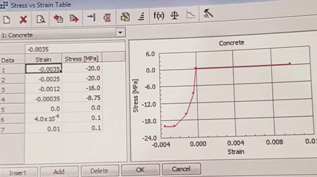

I am trying to model a concrete material which I have a complete strain/stress curve from an experiment ranging from -0.0035 (compression strain) to 0.01 (tensile strain). In the workbench, the closest thing I can find is the hyperelastic "Uniaxial Test Data". Should I enter my strain/stress curve directly to the "Uniaxial Test Data"? If so, would this overwrite the existing data such as young modulus?Â

Forum Moderatorkindly take a look at /forum/forums/topic/entering-non-linearity-in-workbench-for-concrete/
and see if that helps.
