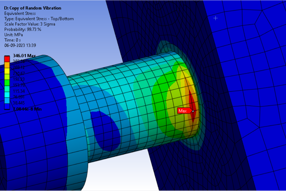

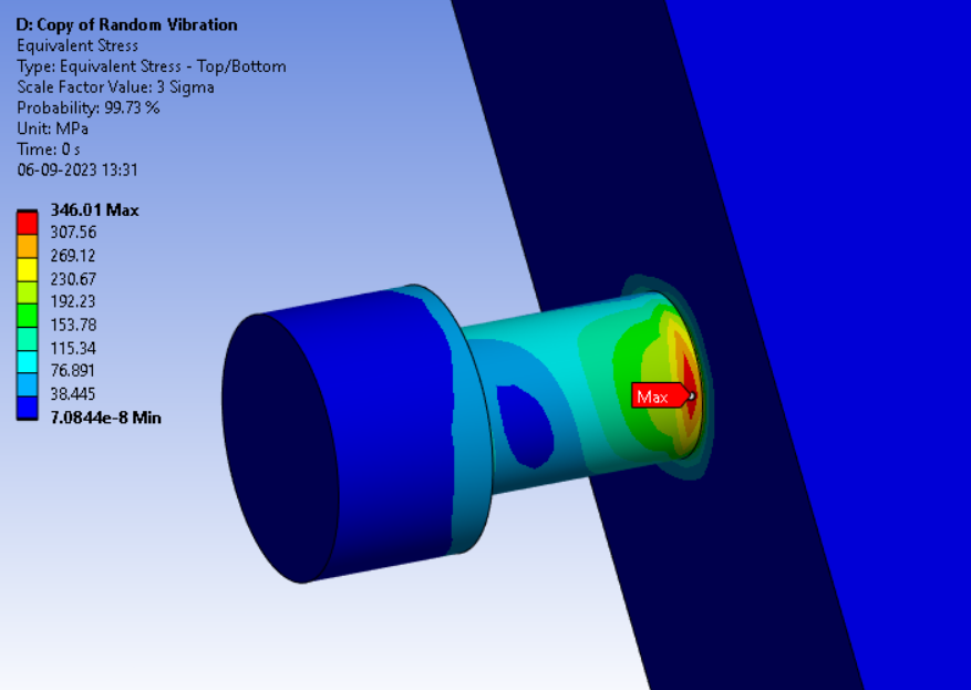

      Hello all,
      I am doing random vibration analysis of one assembly , here the bolts are holding two plate i have considered the contact between the bolt and plate as bonded. I am getting very high stresses in perticularly concentrated the bolt and plate edge area. I feel this is a stress singularity as it is concentrated to very narraw but why it is coming bcz its not an sharp edge.
    • Aniket Chavan
      You can refine the mesh further to confirm if it is stress singularity. It could it be because of the edge of the plate digging on the bolt.
      -Aniket
      Forum Rules & Guidelines
      • BALA
        Thank you sir for your prompt reply, I did mesh refinement and found that its value is increasing rapidly. In this which stresses we should consider as real one?
