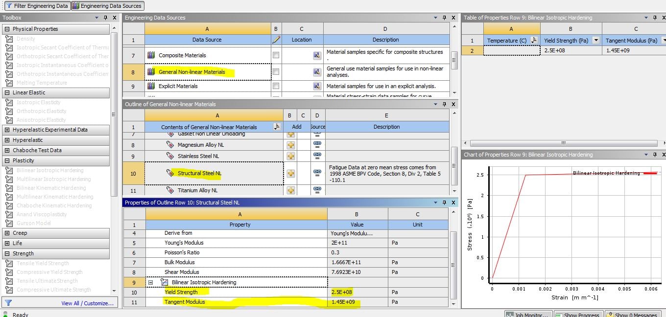

    • jj77
      No worries - good that you are looking at DNV - many times also naval engineers know the critical areas so an area like this they will know if it is important or not - I assume that comes with experience and after having designed many ships
      The video you have is for nonlinear cast iron which is not what you want.
      In engineering data, one can select a bilinear isotropic hardening curve, e.g., go to engineering data sources and nonlinear materials and pick one (StrSteel NL) - one would need to set the yield stress and tangent modulus. See below where it is set to 250MPa. Just press the yellow plus button and it will be added to your material - you can then choose to assign it in Mechanical (For these surface bodies or for all).
      See also this video:
      https://www.youtube.com/watch?v=oShBSiIVi8Q

    • jj77
      It is very likely due to the extrapolation - NL things are enforced on the Gauss Points (GP), but when we extrapolate depending on the mesh, and the stress variation between elements we might go above yield stress.
      First check that we actually do get yield and that it is OK. So check plastic strains (results strains).
      Then if that is OK, we can look at non extrapolated results - inert a command in solution saying ERESX,NO (this command forces copy of GP values to nodes).
