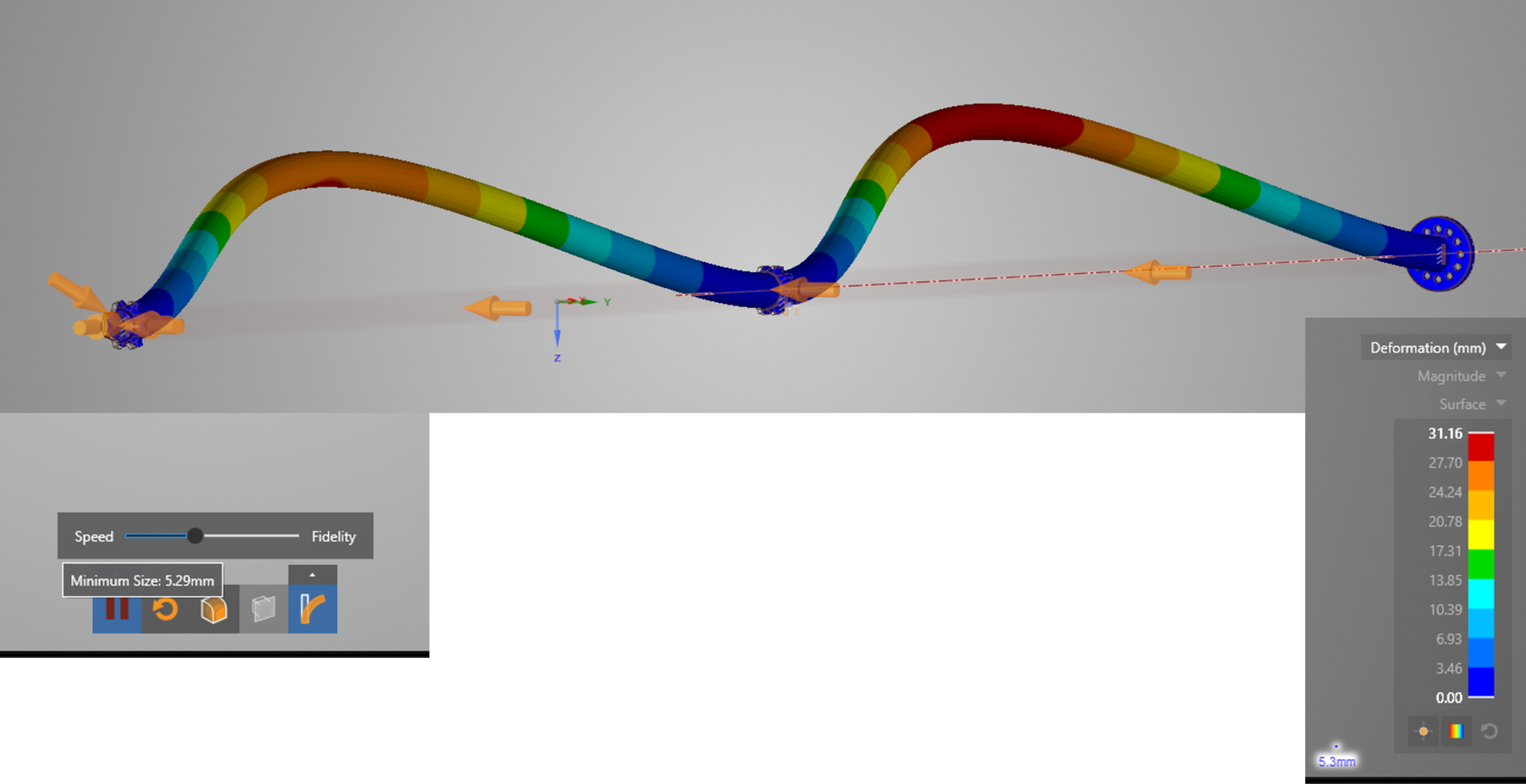

      Hi all,

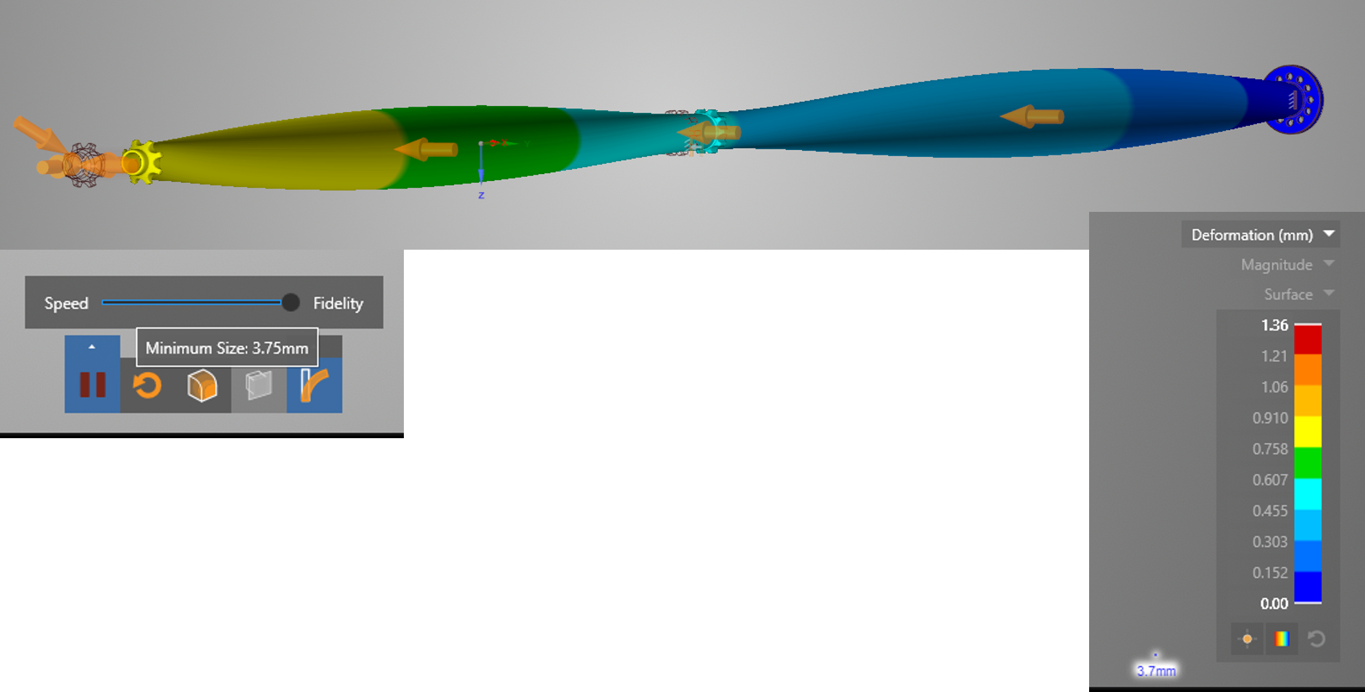

        One of our customer is experiencing a very strange behavior of Discovery Live. The model is similar to a long slender pipe subjected to internal and external pressure, it is fixed at one end and guided axially at the other end and halfway of the length of the pipe. I have attached the model. The results changed drastically depending where the fidelity bar is. Low fidelity and high fidelity seems to give reasonable results, deformation shape and magnitudes seems to be OK, however at some intermediate fidelity locations the results are totally wrong. see pictures attached.

      Also when reviewing displacements in the Y and Z direction, the results seems to be wrong in the cases where the overall solution seems to be correct. It looks like the values are 1 order of magnitude bigger that it should be and also Y and Z are interchanged.
      Any Idea why this behavior? in this particular case is quite simple to detect that the solution is totally wrong but what about in a more complicated assembly? identifying this behavior could be very difficult.
      Any idea to avoid this problem is very welcome.

      The wall thickness of the pipe is 8 mm, and the overall length is 7100 mm.  The fidelity within Discovery Live depends heavily on the size of the model.  In this case, the difference between these two values is huge, so it's not surprising that the results are behaving strangely.

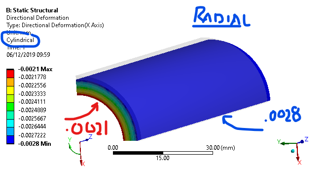

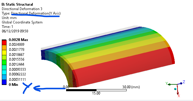

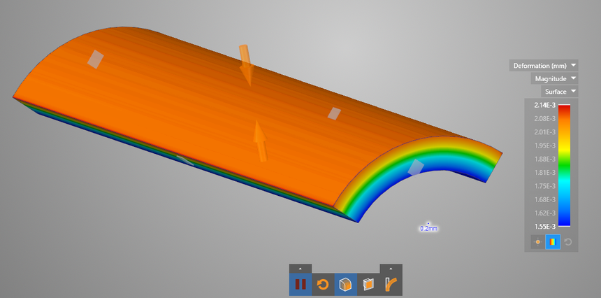

    • garias
      Hi Brian Bueno ,

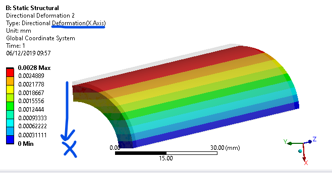

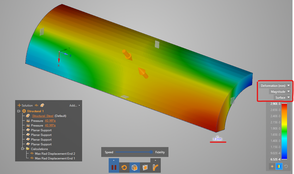

         Any new comments on my last replay. Also I've changed the model to make more simple and also to reduce the big Thk/Length ratio. still the results does not look good. the model Attached is a 1/4 of a straight pipe  100mm long thich a 5mm thickness wall. Looking at the radial displacement resutls you could see that the model is not behaving correctly. Would you be able to comment on this? what is the max ratio length/thk that Discovery Live can handle?
        Again thanks a lot for you help.

      • Brian Bueno
        Gabriel Arias
        Sorry for the delay in responding.  I will have to consult with the development team about this to see what their conclusion is.
        What results are you expecting for the Small Straight Pipe model?  The maximum deformation in Y on my PC is .00347 mm
        I did notice that your calculators are set to measure the deformation along a curve at each end.  However, for this calculator to display results, the statistical operator setting needs to be None.  The values will then be displayed along the length of the curve.

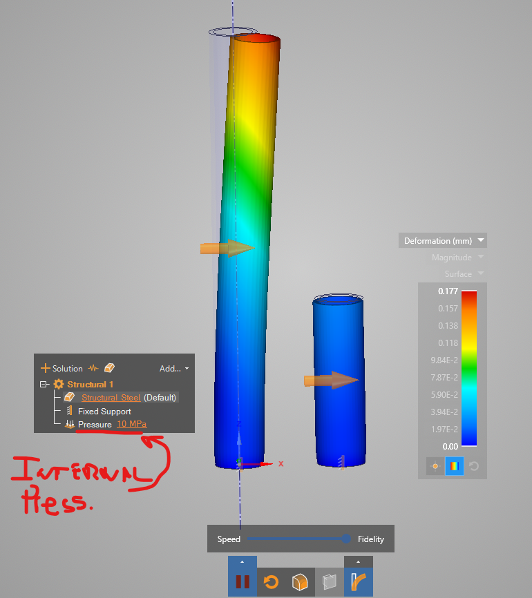

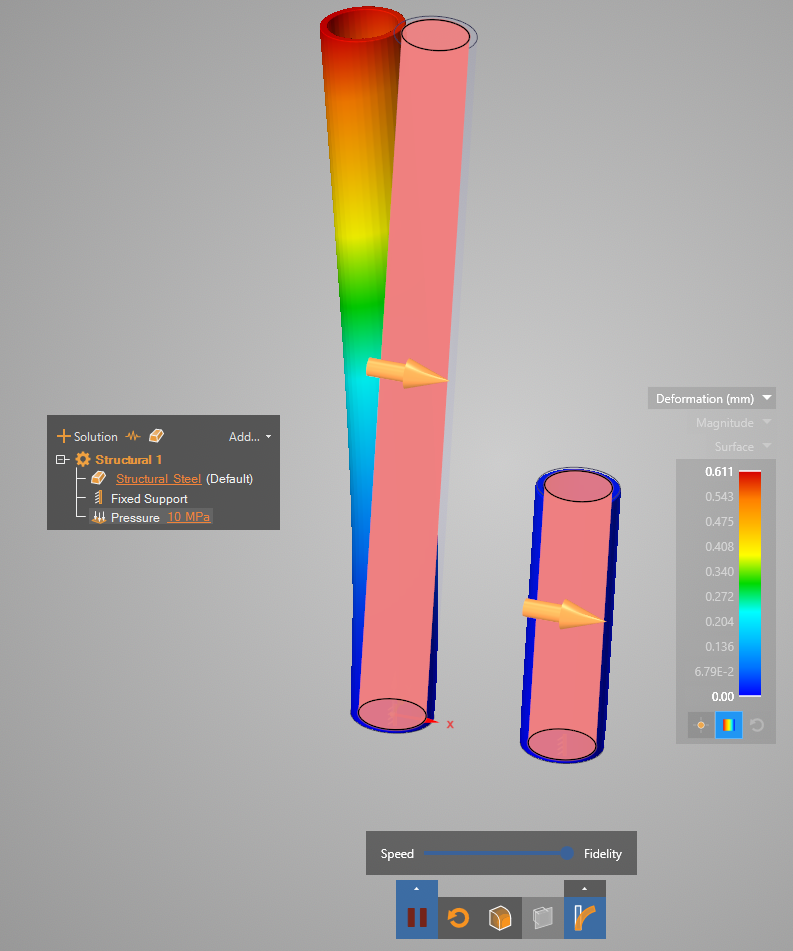

    • garias
      Hi Brian Bueno

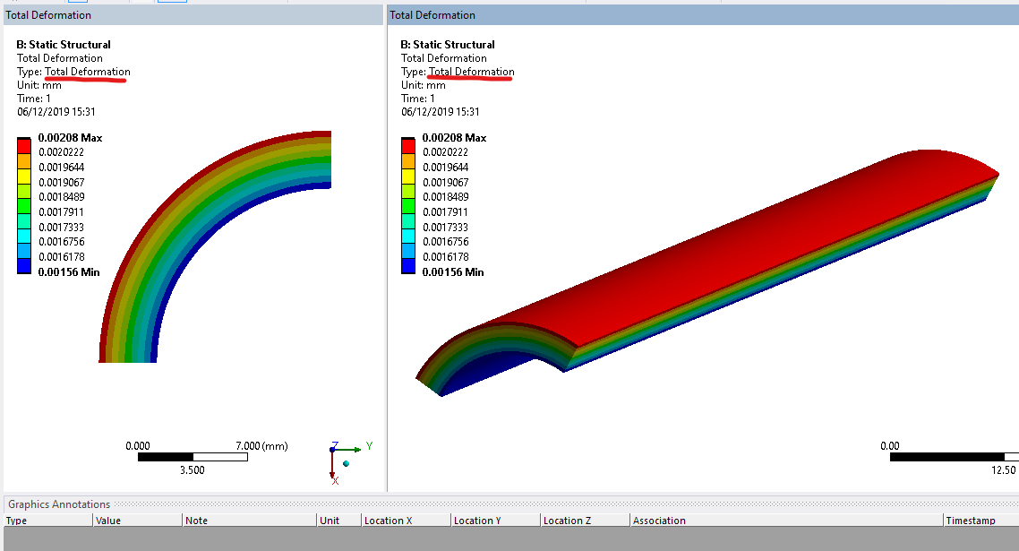

        Thanks for getting back to me on this issue. The correct results for this case should be an uniform radial displacement on the outer face of 0.0028mm and in the inner faces of 0.0021mm. The two calculators I've used were to give me the radial displacement, due to the symmetry this can be done measuring max disp in X and or Y. But you could see that the displacement in X or Y is not uniform it should looks like stripe of uniform colour along the pipe axis as shown in the pictures attached.
        Also in a different example, a simple straight pipe with internal pressure and fixed at one end, there solution produces, with Max fidelity, the pipe to bend which is obviously wrong, and the longer the pipe the more obvious the error is. I've also attached a model that shows this behavior and a picture.
        Hope this helps to debug the problem.

      • Brian Bueno
        Gabriel Arias
        The overall displacement magnitude rendering is correct because the red area is where the pipe is getting longer.
        The pictures shown with the radial color bands are using a “cylindrical” coordinate system. Discovery Live does not support rendering with this method.
        For the longer pipes it is a matter of having enough GPU memory to capture the geometry.
    • garias
      Hi Brian Bueno
        There are a few issues open which I feel are not answered yet.

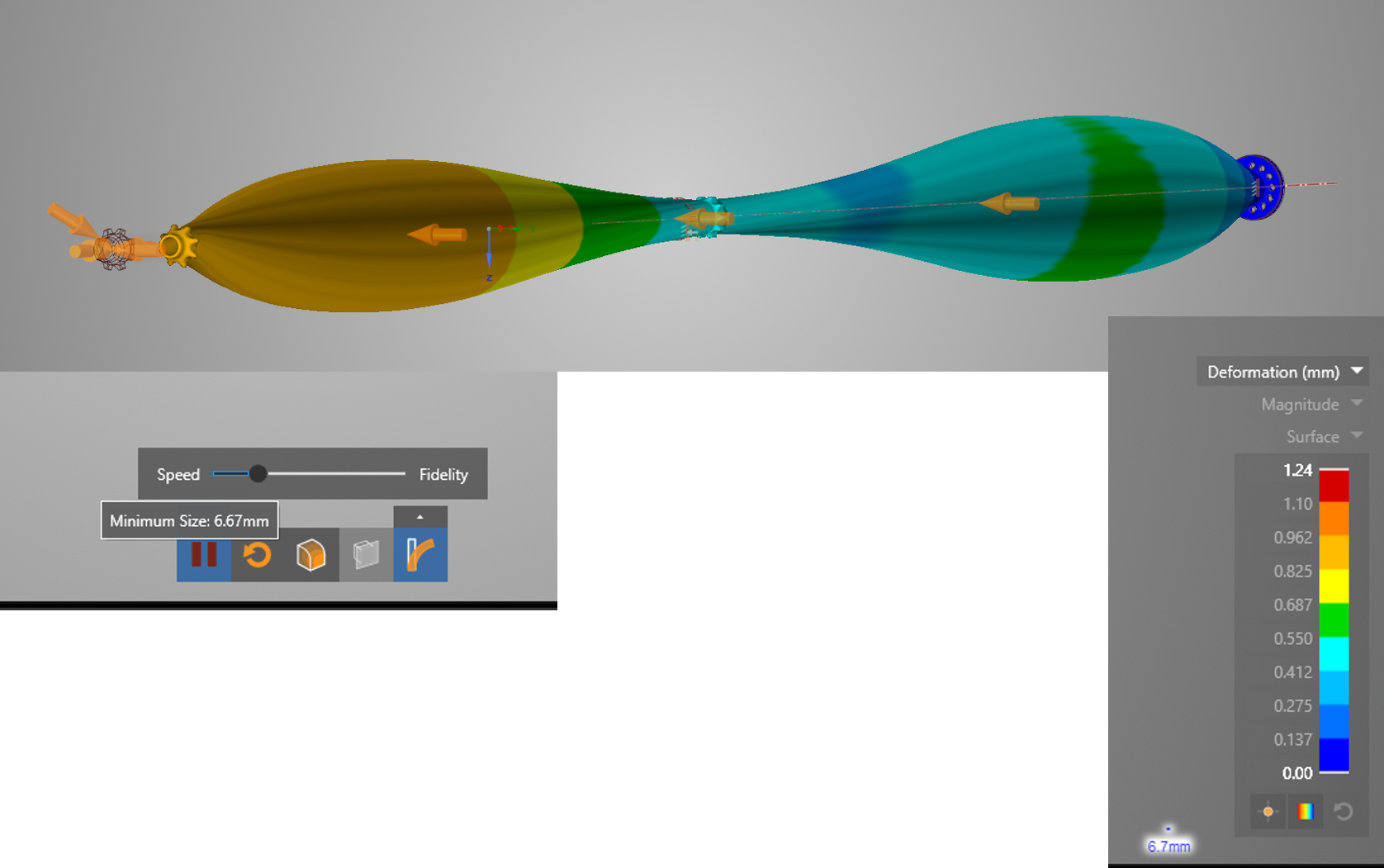

      1 - Original long hollow pipe drilling bit model.
            The total deformation at some fidelity points is totally incorrect however it is roughly correct at low and high fidelity. This behaviour, from a user point of view, does not make sense and it is quite puzzling.
      2 - In order to avoid the problem of a large thickness/length ratio I've created the second model. This is a quater of a short pipe. It has symmetry boundary conditions, and equal internal and external pressure and it is axial fixed at one end. You are right, the overall displacement is correct, however beacause it is one order of magnitude bigger than the radial expansion it is hidding the problem of the radial displacement. If you run the same problems but fixing axially both ends the problem is highlighted. The element size this model is using in my machine is 0.2mm which is 25 time smaller than the actual thickness, small enough to capture any details. (I have attached picture and database).
      In order to evaluate the radial displacement using Live I've used the two calculation to ask for X and Y displacements and I check the max or minimum at the symmetry planes.
      3 -  The last model I've used to debug/investigate this behaviour is a simple straight pipe with only internal pressure and fixed at one end. The model should not deflect at all, only radial expansion. the element size is fixed to 1.5mm and the thickness is 8mm, so again the element size is small enough to capture any detail. An yet the longer the pipe the bigger the bending.

    • garias
      Thanks Brian,
        I will test it and I will let you know if the issue is resolved.. Thanks for your reply
    • garias
      Hi Brian,
        I've download the new version and it seems that works better in some of the problems but in the simple case of a pipe 8mm thickness with internal pressure only the piple keeps bending which is not right, see attched picture. The element size set on my analysis was reported to 0.97mm

      • Brian Bueno
        Gabriel Arias
        Sorry for the delay.  I see the issue you're referring to when I go to maximum fidelity for this model, but up to that point the results are OK I think.  My minimum feature size was about 0.65 mm and the deformation was .136 mm.  I will follow up with the development team to have this investigated because it is a bit strange.
        Please keep in mind that Discovery Live is intended primarily for design exploration.  The goal is to generate the results quickly to allow testing of multiple concepts.  The trade off for this speed is accuracy.
        For design validation and the highest accuracy, you should use Discovery AIM.
