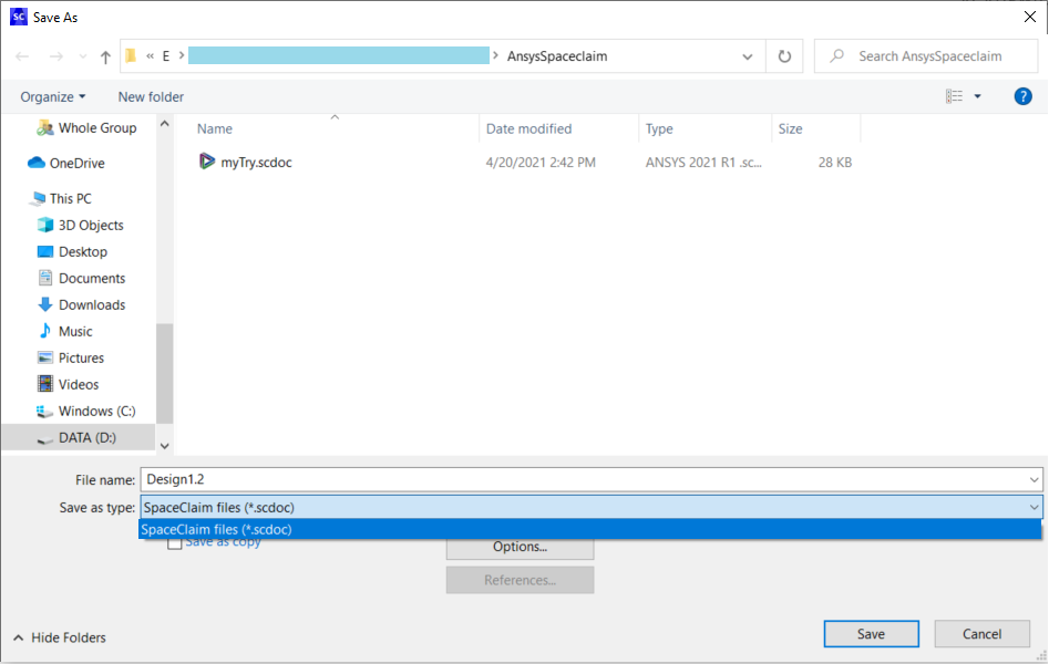

      Save as option only has these file types after upgrade: Spaceclaim files, auto cad dwg, dfx, spaceclaim template, bitmap, gif, jpeg, png, tiff. Nothing useful for a 3D cad software.

      The File Save As command is context sensitive, which means you get a different list depending on what is in your file.
      When you have no geometry in your file, it gives you a short list.
      When you have Solid geometry in your file, it gives you a longer list.
      When you have a Facets, then it gives you the STL file format.
      If you have surface or solid geometry, click on the Facets tab, then click on the Convert button to create Facets.

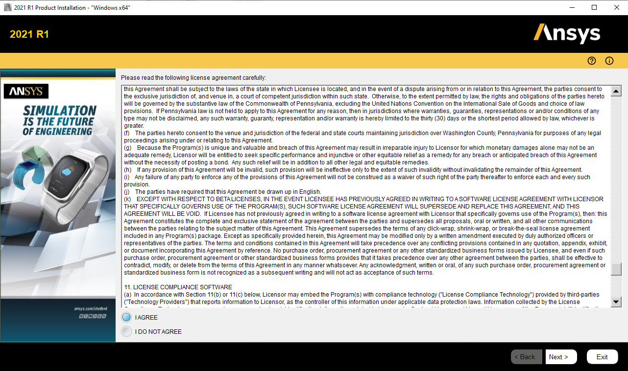

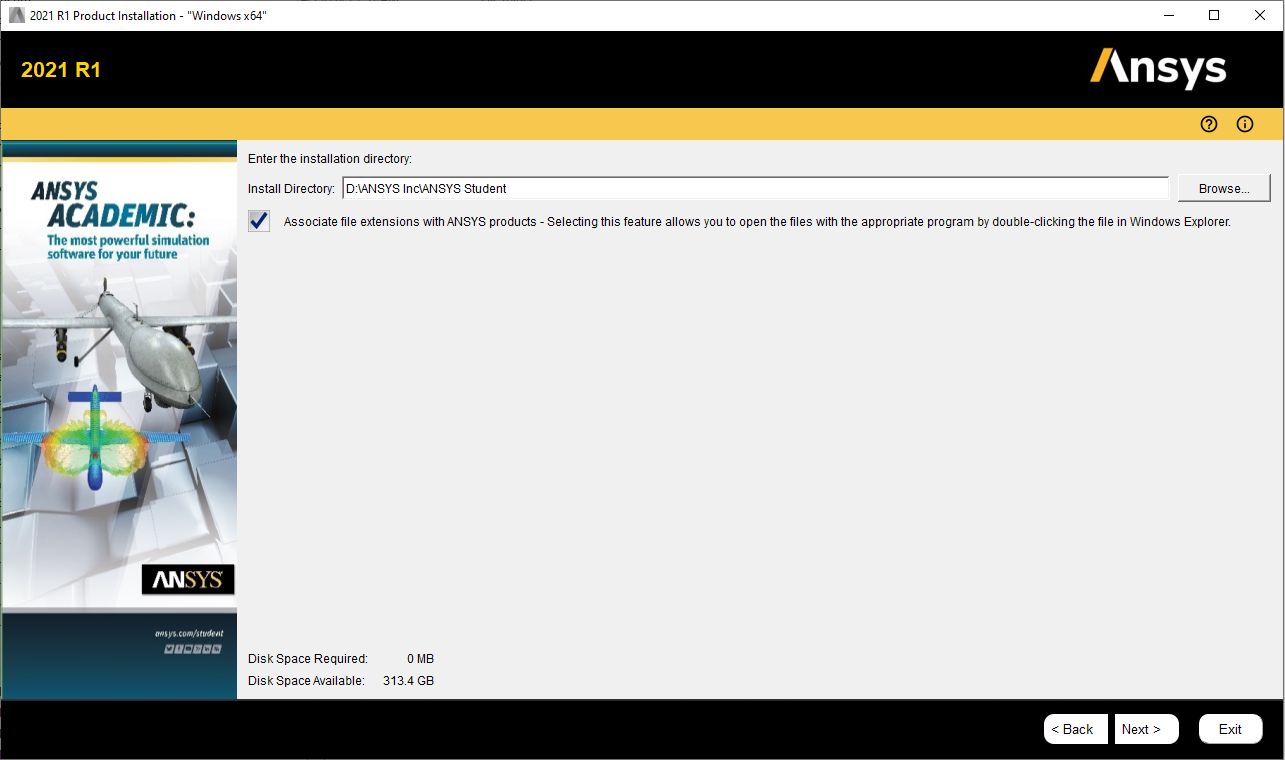

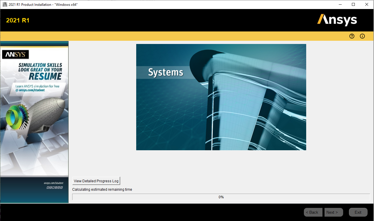

      nHi,nIn my case, I only have the 'SpaceClaim files (*.scdoc)' choice as the image shown below.nnWhen I install the software, I only have the 'setup.exe' as the installer and there is no such a choice asks about 'Translators'. Once I check the agreement and select the folder for downloading, it immediately start the installation without any other choices. I have run the 'setup.exe' as an administrator and it over-wrote my previous installation, yet no changes happened.nThe next of this page is the installation.nNothing else I could do.nMay I know is there a way to manually check the 'Translators'?nThank you so much.n
