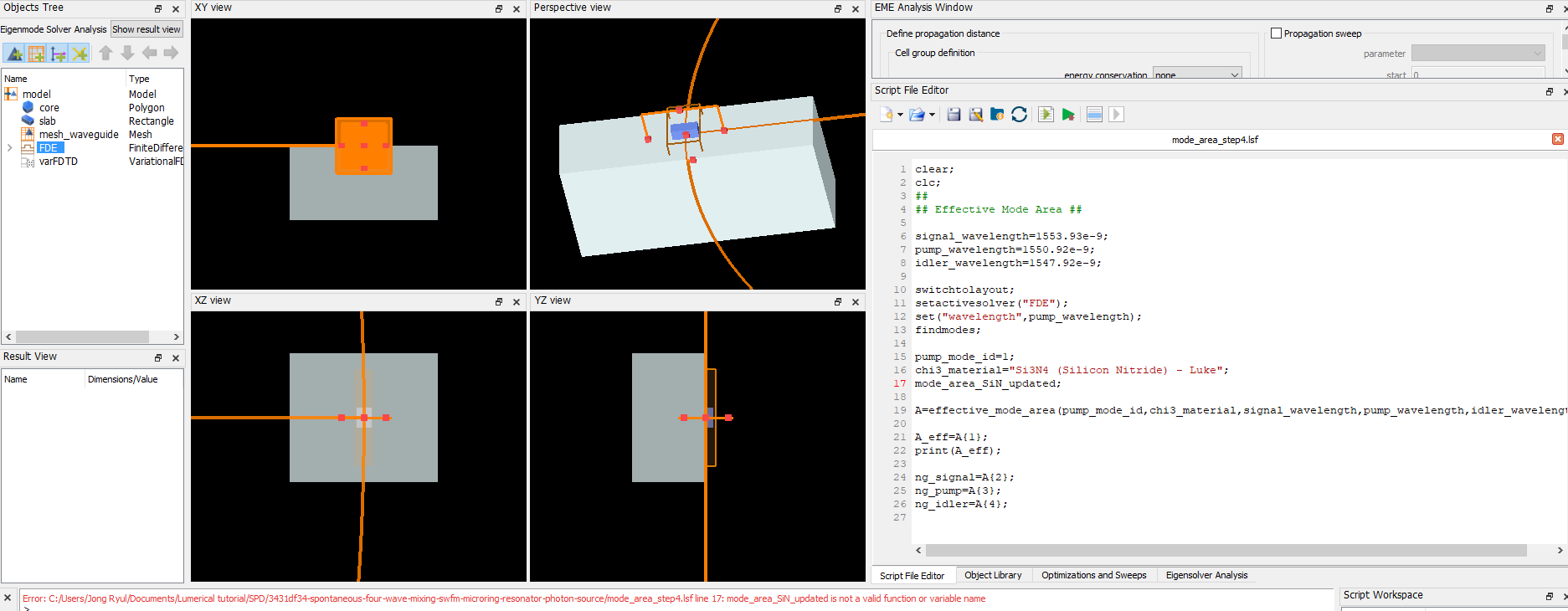

Ansys EmployeeThank you to bring this issue to us. The "mode_area_SiN_updated" file is missing. Once found we will update the website. Â

Ansys EmployeeI believe the website has been updated and file name also changed. Please check and see if it works.

SubscriberI also encountered this problem. I just downloaded a new file, but I found that the script has not been modified. This issue still occurs after running.

Ansys EmployeeThank you for pointing out. Please do the following modification:
1: rename file effective_mode_area.lsf to be effective_mode_area_function.lsf;
2: open mode_area_step4.lsf ;Â
2: modify the function name from " mode_area_SiN_updated" to effective_mode_area_function. eg
#mode_area_SiN_updated;
effective_mode_area_function;
