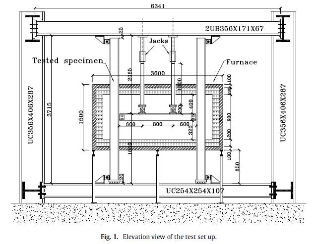

      I'm trying to model a fire test simulation (Assembly as shown in Figure) to analyse the stress and strain performance on the connection plates under fire. I've got the geometry modelled (I only modelled half the assembly as it is symmetric and to simplify the model, I've only modelled the column, connection and half the beam with the 40kN loads). I'm a bit lost to model the fire conditions. Do I use transient thermal analysis? How do I model the temperature to simulate realistic convection through the beam and whatnot?

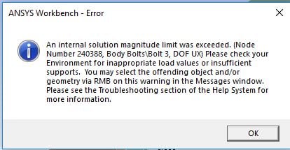

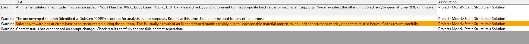

      I've got the test modelled (only modelled half of it since it's symmetric). I can't seem to successfully solve it. Keep running into errors (please see picture attached).
      I've modelled all the contact between bolts and nuts to bonded and every other contact friction (I specified the geometric adjustment to fit). I've modelled the boundary conditions of the column to be fixed at the bottom end and horizontally fixed at the top end to allow for expansion. The free end of the beam is modelled as frictionless support as it represents symmetric face.

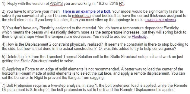

      Thanks for the reply Peter,
      1) I'm working on 19.2
      2) Can you relink the "example of a bolt" so, I can have a look at it for reference? Can you please explain how do I do the conversion as I'm not familiar with that?
      3) I will add in tabular data for multilinear isotropic hardening based on temperature in Engineering Data.
      4) Yes, I put that displacement 2 to help with convergence.
      5) I will try and solve Static Structural alone first
      6) I will try that method of loading. Is it better to have a loading plate on top of the beam flange as shown in the test setup and put the load on the face of that plate?
      7) So, in my timestep, step 1 should be when the Imposed Force is equal to 0 but the pretension load is applied. in step 2, the imposed force is applied. Is that correct?
      2) see previous post.
      4) If the structure buckles to the side, that is a valid failure mode. Delete this constraint.
      6) Yes, you could have a loading plate instead. Still use a Remote Displacement.
      7) In step 2, the Bolt Pretension has to be set to Lock and the imposed Displacement is applied.

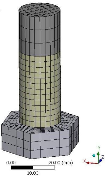

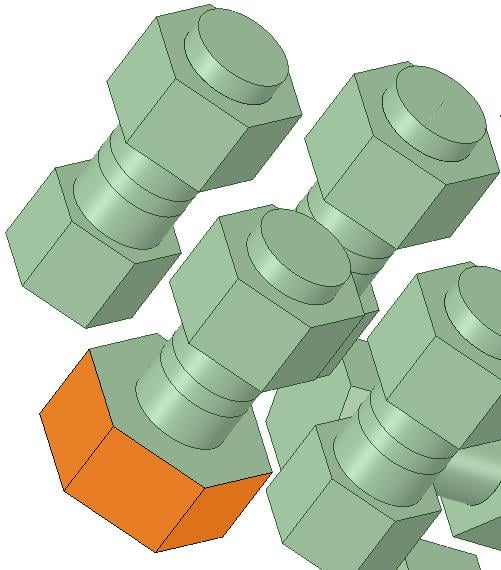

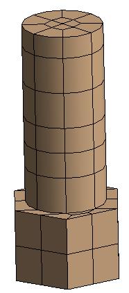

      The example bolt I gave you is on the left compared with the mesh on your bolt on the right.
      The head on your bolt is too small and you don't have enough elements on the face of the head.
      The example has more elements than necessary, but one element is not nearly enough.
      If you pick all six faces on the head (or nut) you can pull it to a larger size.

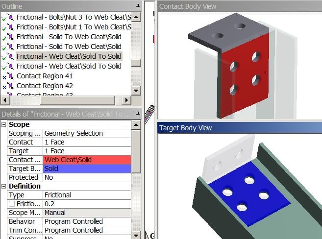

      You also have a contact that was near open. You have to fix the near open contact.
      I duplicated the contact and made it a contact to the center web of the I-beam.

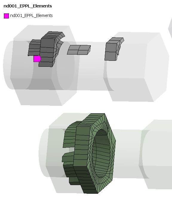

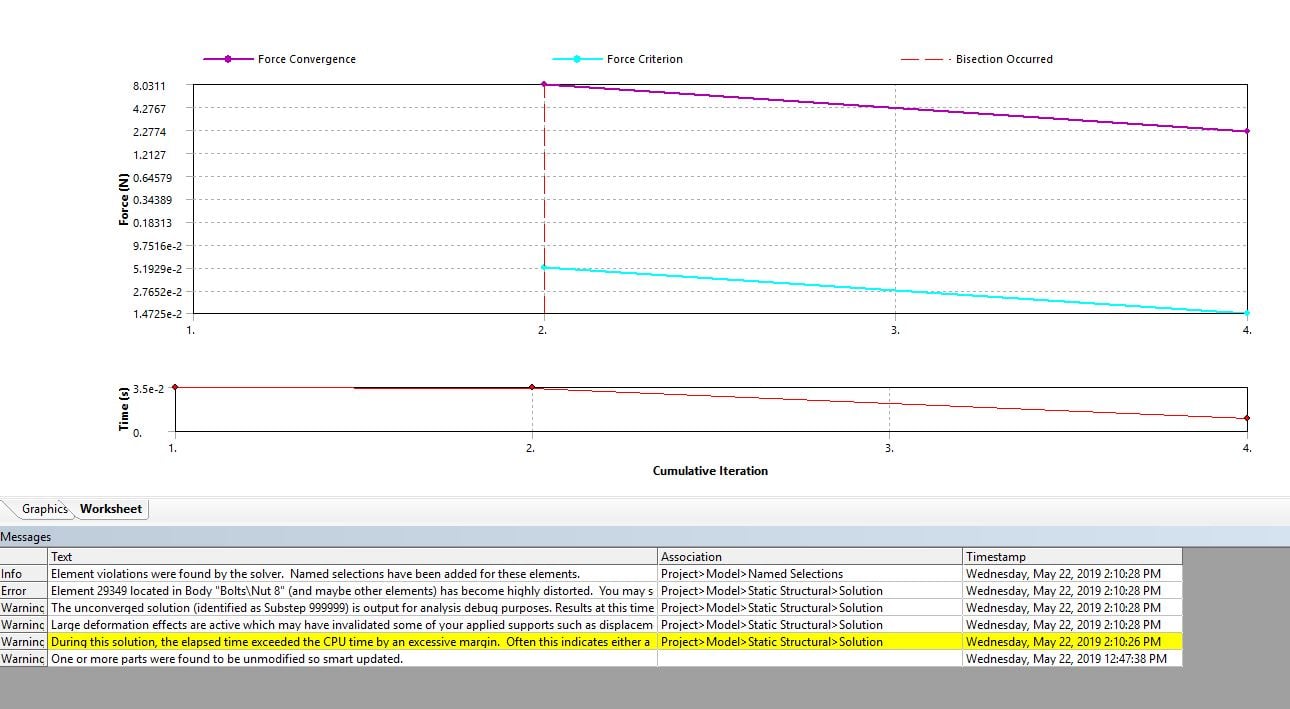

      I've refined the mesh on the bolts and nuts and fixed up the contacts (no more near open contacts). This is the error I'm gettng now.
      Can you please have a look at what might be giving the errors? Thanks
      The elements are highly distorted. If you pick Solution Information, you can type a 1 in the Identify Element Violations. Then after a Solve, it will automatically show you elements that are highly distorted.
      You must use even smaller elements around the nut and bolt head. Also, keep those faces on the Contact side, not the Target side. You can use Adjust To Touch on all the nut faces and bolt head faces to help it get started.
      To get a solution, you could change all contact to Bonded, and suppress all the contact of the bolt shanks to through holes.
