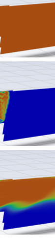

      I have a model wherein I establish steady state condition by flowing a two-species mixture and then introduced discrete particles in transient simulation. After steady state simulation, I get concentration of both species as contour plot. Upon starting the transient simulation with very small  time steps such as 1e-07, I find that the concentration of species in the domain drops to zero except at the inlet. The inlet velocity is about 25 m/s. the length of the domain is roughly 60 mm. Is this normal? I expect the concentration of the species not to be zero after I switch from steady to transient flow. I specify the inlet flowrate, total pressure, static pressure, and total temperature at the inlet.

      Rob- After running the steady state model, I moved copies of the case and data files (Set 1) in a new folder. Then I added the DPM settings and saved the case and data files as new files (Set 2). When I am running the simulation, I saved the files with a new name at different time intervals – 0.1 ms (Set 3), 0.2 ms (Set 4), etc. I can plot species concentration in the domain from all three four sets of case and data files.
      Set 1 – Species concentration is correct
      Set 2 – Species concentration is correct
      Set 3 – Species concentration is nearly zero, except near the inlet where the species enter.
      Set 4 – Species concentration is nearly zero, except near the inlet where the species enter.
      Hope this explanation is helpful.

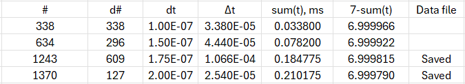

      Note that Set 3 was run for 1243 time steps and Set 4 was run for 1370 time steps.

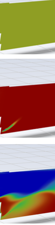

      That shouldn't be possible. Can you post some images?
    • sjohn
      Here is a snapshot of the species concentration – Set 2, Set 4, and Set N, which was obtained 3263 time steps of varying step size.
      Here is a snapshot of the temperature – Set 2, Set 4, and Set N. In Set 2, you can see the effect of the atomizer as a lower temperature plume. In Set N, the high tmeperature is due to the heat released from the reaction between the species (released from droplets upon evaporation) and the one of the species from the fluid flow starting at the inlet.
      Did anything change in terms of mixture templates when you added the evaporating droplets? Ie it's not a case of the species got scrambled because you've changed something?
    • sjohn
      I thought I had not changed anything major but upon reviewing the log file, I discovered that the case was hybrid initialized (accidentally). I think that may have caused the species concentration to zero out. I will have to rerun the simulation.Thank you for asking the right questions.
