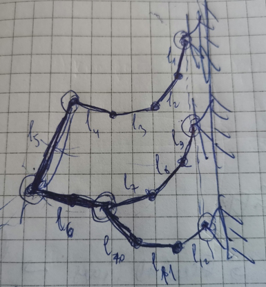

SubscriberThanks @peteroznewman for your answer! Here I apply the photo of the system I want to model. Briefly, there're 3 rods (on the right side of the picture) that have a spherical joint with the ground. All the other joints between rods should be also spherical with non-zero stiffnesses (that's what I meant when I wrote about springs) . I actually haven't quite understand your note about 6 springs. Could you please explain it more? Is the structure on the picture appropriate for Static Structural?
There is also a problem here with the spherical joints. I read about this type of joint and how the friction moment is calculated based on radius, friction coefficient and surfaces of the joint. I didn't understand is it valid to define the joint between the ground and the top face of the cylinder as is shown on the 2nd picture (and also if I want to create a joint between 2 consecutive rods, I would need to define a joint between the bottom of one cylinder and the top of another). The problem here is that here the center of the joint is located in the center of the face and the radius of the joint is 0, so, as I understand, the moment would be 0. All I want is just to make some kind of connection between rods that would produce a counteracting moment that is proportional to change of angles in this joint. (like in a revolute joint, where we have M = c*phi, but here in spherical joint we have 2 angles, as I don't want to account intrinsic rotation of cylinder around its axis). Maybe I just need some other type of joint for this purpose?

March 11, 2022 at 3:37 pmpeteroznewman
SubscriberI see you have 12 rods that you want to connect with a spherical joint and a spring that creates a restoring moment proportional to the angle change. This can be achieved by using a COMBI250 element.
Open ANSYS Help and paste the following into the Browser window.
https://ansyshelp.ansys.com/account/secured?returnurl=/Views/Secured/corp/v221/en/ans_elem/Hlp_E_COMBI250.html
This element defines 6 spring constants between two nodes. Three translational spring constants and three rotational spring constants. By using large values for the translational spring constants, such as 10^8 N/m and small values for the rotational constants, you will effectively have created a spherical joint that has a restoring moment to return the rods to their initial angles.
Open SpaceClaim and create 12 new Components. Draw one rod in each Component as a line body. Separate components assures that when two rods meet at a common point, they each get a node on the end and don't share a node as that would weld the rods together into a single structure. Create an extra Component call it Ground that has three nodes to connect with a node on one end of rods 1, 9 and 12. You can draw the triangle defined by the three ground points. For the rods, if it is easier to draw solids than lines, you can do that and use the Prepare tab to convert the solids to Beam elements.
Make an exploded view sketch with shortened rods so that there is a gap between the ends of the rods to leave room to draw a short COMBI250 element. Number all the nodes and elements (Ground nodes, Rod nodes and elements and COMBI250 elements).
To make the connection where three rods: 6, 7 and 10 come together, there will be two COMBI250 elements, one connecting 6 and 7 and another connecting 6 and 10.

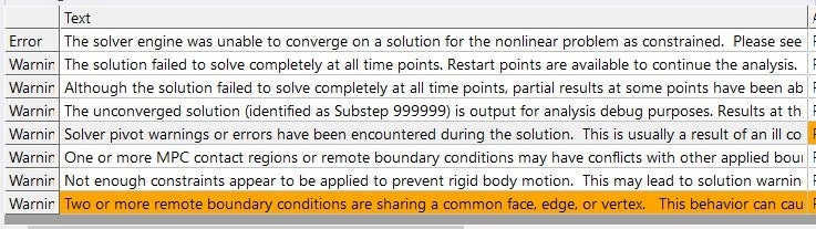

And here another question arised. I've read in Help that Bushing joint uses COMBI elements inside so I've tried to import just 12 beams into Mechanical as stiff beams. Then I've defined body-body Bushing joints between the beams and body-ground Bushing joints between 1, 9, 12 beams and the ground. But then I got error message that Static Structural analysis doesn't support joints with bushing formulation.
Then I've tried to change the formulation of the joints to MPC and I got a pack of errors shown on the picture below:
Does that mean that I can't model the problem with joints and that I need to use COMBI elements directly? And I don't know will there be a problem of preventing rigid body motion if I will use COMBI elements.

March 15, 2022 at 11:30 pmpeteroznewman
SubscriberYes, you have to use APDL commands to create the COMBI elements in the model. If you use COMBI elements, you don't need joints to connect two links.
Bushing is a connection to ground. You want a connection between two links, so you don't want to use a Bushing.

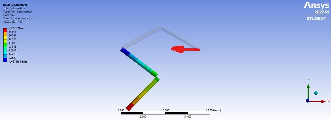

I've tried to solve smaller problem in Ansys as Static Structural. I created 2 beams in SpaceClaim as separate components. Then I added Bushing joint between the ground and the first beam and created a spring between the beams that I then changed via APDL commands to be COMBI250 element as you suggested on this forum earlier. I applied a force to the end of the 2nd beam. There is also a thing that I don't understand: when force is applied by components it's written that it is ramped and I don't understand why it should be ramped and how to make it just constant. Nevertheless, solution didn't converge on a whole time period and the behaviour of the beams (deformation) obtained from solution is very strange.
On the above picture the total deformation and the direction of applied force is shown. As I said, from a common sense such behaviour of the beams is strange. Maybe you will have an idea what is going wrong with this model?

March 21, 2022 at 5:48 pmpeteroznewman
SubscriberI remeshed with 3 linear elements and set many substeps in the Step Controls.
March 21, 2022 at 7:15 pmpeteroznewman
SubscriberI think you can have a zero length COMBI250 element. The two nodes at the end of each link can have the same exact coordinates. This may be a cleaner model for you.
March 26, 2022 at 9:51 amalpivanvik
SubscriberThank you very much! Though the result of the total deformation of the system in your file is inconsistent with theoretical results.
I've tried to make zero length COMBI elements by transforming beam or spring connections to COMBI by APDL. This approach doesn't work because Ansys doesn't support zero-length springs and beams. So I've tried to make a bushing joint between the beams with bushing formulation and then insert APDL commands same as for the spring. I've also kept the number of elements and increased the number of substeps and this approach actually worked and it's consistent with theoretical results!
