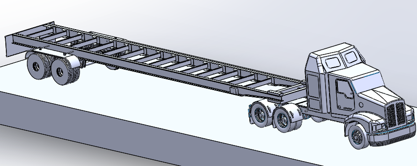

      hello,
      i'm new to ansys and i'm trynig to conduct a fatigue analysis on a semi trailer vehicle subjected to static and dynamic loads. the static load is a pressure non uniformly distributed along the upper faces of the longitudinal beams whereas the dynamic loads are the normal forces applied on the wheels due to the uneveness of the road  can anyone help me please

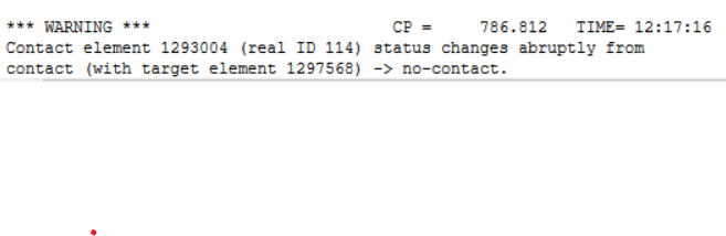

      hello, how  can i find the location of this contact mentionned in the warning, please
    • erik.kostson
      See this post on how to display a specific contact element:
      /forum/forums/topic/how-to-display-contact-elements-id-in-ansys-workbench/
      All the best
      Erik

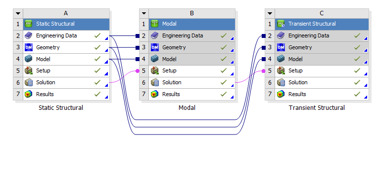

      i performed a static analysis on the semi-trailer and i want to perform a dynamic analysis using the results of the static analysis to simulate its interaction with the road  should i share the results with the model or with the setup?
      i also want to determine the stresses, the displacements, and the frequencies which type(s) of dynamic analysis should i use?

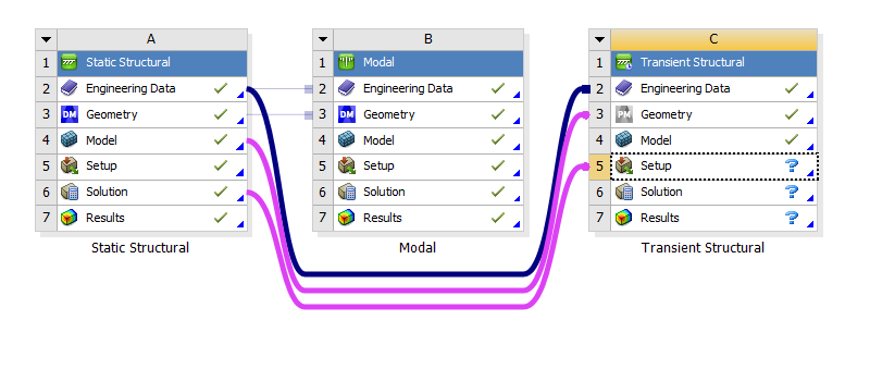

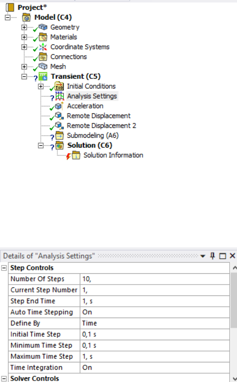

      i tried the following and i got question marks on analysis settings and submodeling. how can i fix this?

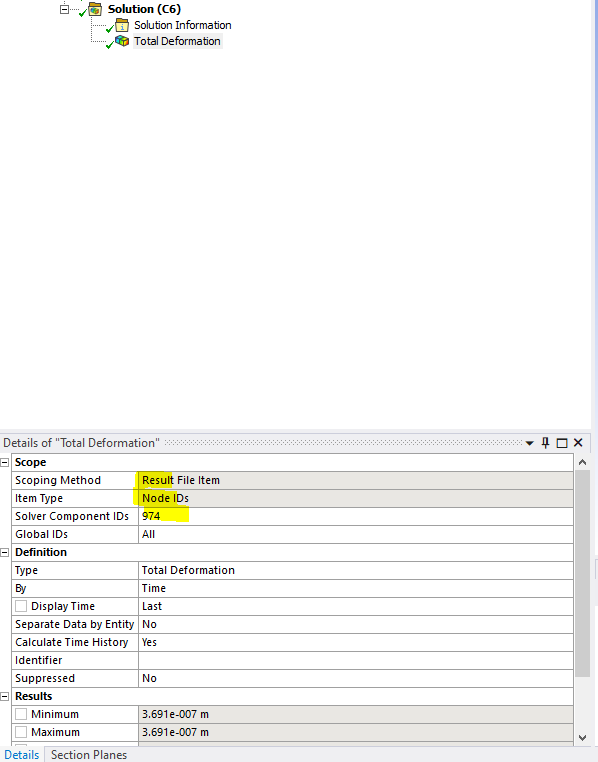

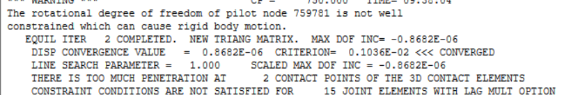

      hello, i wnat to konw the location of the error mentioned in the results file, can you help me?
    • erik.kostson
      Hi
      If the model has solved and want to check where that remote point is, just create a result and scope it to that node (say node 759781 in your case).
      To scope a result to a node (974 in this case) see here:
      You would need to replace and add the node number of interest in the Solver Comp. Ids.
      Thank you
      Erik
    • chiheb ben abdallah
      Hello, no unfortunately the model is not solved and I want to know t what the message 15 joint element with lag means and the place where there is excessive penetration

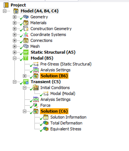

      hello,
      i want to perform a dynamic analysis where  a sinusoidal force is applied on the axles of a semi-trailer. the semi trailer model is initially subjected to static loads. first i performed static anlysis then a modal analysis to extract mode shapes and natural frequencies. in modal analysis i used static structural as pre-stress.
       the purpose of the simulation is to investigate the occurance of resonance when the force is applied. i tried a transient structural analysis  but i don't know whether it is the right choice or not. if not what type of dynamic analysis shoud i perform? and how can i know whether resonant vibrations occur or not?
