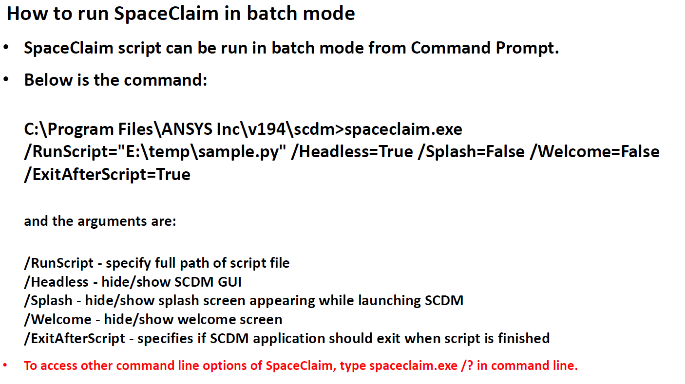

      I ve written a script in Spaceclaim to take in parameters, update the model and save the model as a new file. Now ideally I want to include that process in a larger script I ve written so I m wondering if there is a possibility to start a script using an external python script (or after opening Spaceclaim with this external python program).
      Next to that at the end of the geometry creation script in spaceclaim I want to close the active document, however did not see any code for that, so question is if there there is a command to close the active document?
    • Naresh Patre
      Hello dvleugels
      Please find below an image on how to run SpaceClaim and script through Command Prompt. Make sure that you specify the correct path of spaceclaim.exe based on the version that you are using.
