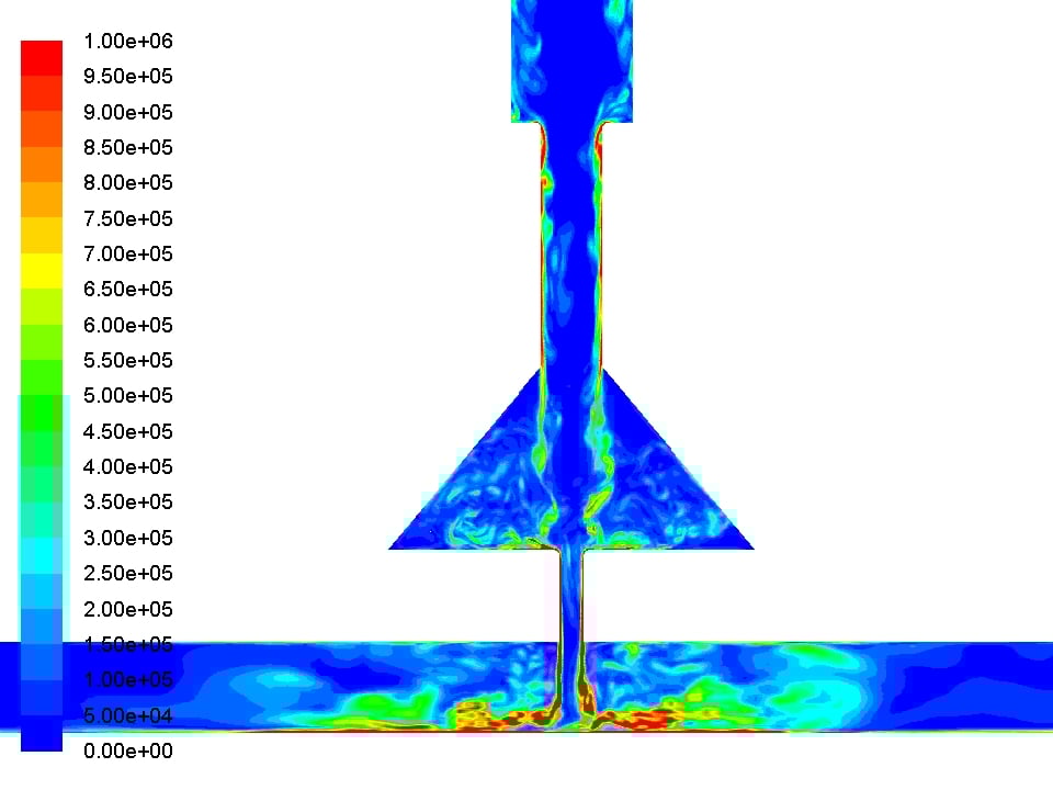

      I tried simulating shape A under different condition (II) in the past
      Condition (II)
      ?Pressure based → Density based
      ?Air Density is constant → Ideal gas
      ?Time step size 3e-08 → 1.5e-08
      ?Others are same as the condition (I)
      Even though they have the same nozzle shape A, there is a difference in the vorticity image between the condition (I) and (II).
      Condition (I) ↓
      Condition(II) ↓
      In (I), we can see small wavelength vorticity.
      In (II), we can see beautiful round big vorticity but can’t see the small wavelength vorticity like (I).
      I do not know what caused this difference in vorticity. Is it solver?
