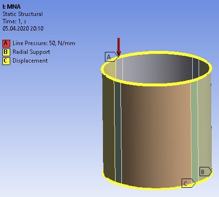

I'm trying to solve some example for MNA analysis.
It is a thin shell supported in the bottom and loded from the top.
I would like to get stability path of one particular node on the top of the shell. I got a converged solution and the maximum value of translation is similar like in example. So guess it is correct.
The chart form example I would like to obtain looks like that:
1) First question is how to retrieve tabular data with more density than it is shown by default ? For example i would like to have tabular data for every 0,05s increment not just for 0,2s substep.
I know how to retrieve those values from the chart manually by i don't how to increase density of tabular data. Because of lack of tabular data my chart in excel is very edgy,
2) Second question is it possible to draw stability path automaticly in Ansys ? I would like to obtain chart like that:
Vertical axis - load increment for example 0,1 0,2 0,3 0,4 etc.
Horizontal axis - Translation of chosen point. -

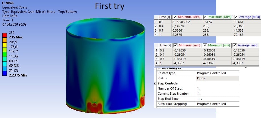

I played a bit with this values and I succeed to get chart that i wanted. I just have two more questions.
In my example I'm increasing linear load on the top ring during solution until it achieve 50 N/mm.
In my first try which I already show you with 1 load step from 0 to 50 N/mm divided automaticlly into 4 substeps the solution has fully convereged and i got stress map like this. The construction yielded just in some spots.
In the second try with 3 steps divided into more substeps at time 2,7 s load get to the max value 50N/m and collapse.
The same construction the same load but applied in smaller portions and actually whole cross section yielded. Below the last converged step with reasonable results.
Could you please tell me:
1) The unconverged fully solution doesn't mean that the solution itself is wrong. We just have to conclude that the construction is to weak and just collapse under the load ? True ?
2) If above is Yes, why solver converged the first try without any problems and the yield zone under the same maximum load is much smaller ? The only difference was quantity of substeps.
Regards. -
April 7, 2020 at 9:27 pm
peteroznewman
Subscriber1) Just ignore the unconverged result at full load, it is for diagnostic purposes only. I always pick the last converged substep to look at results. Those results can be used. A material that has plasticity can go fully plastic and there is no ability to carry a higher load. If that was loaded with a force, then there will be no more converged increments because the structure cannot support higher forces. If the structure was loaded with a displacement, then the solution can continue and the reaction force will be less after the ultimate load is reached.
2) Nonlinear models can be very sensitive to the conditions of the model. Taking large steps, the solver can sometimes jump over an instability that smaller steps will find. The best way to reduce this sensitivity is to create a small flaw in the perfect cylindrical geometry. This is often done by adding a tiny amount of the deflected shape of the linear eigenvalue buckling solution, or one of the modes of a modal solution. That makes the collapse load much lower than it is for the perfect cylindrical geometry, but the force-displacement curve will be very repeatable over a large range of load increment size and element size.
