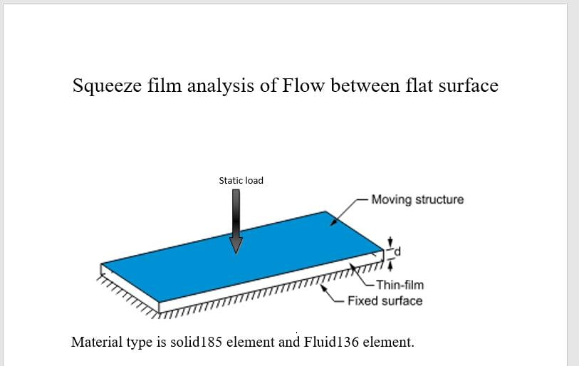

SubscriberI am working on squeeze film damper (SFD) and trying to find the damping coefficient of the SFD. I am trying with solid model, so do i get any help in this. Â

SubscriberPlease reply with images inserted into your reply that show the geometry of the device with arrows and annotations that point to the squeeze film area, the larger volume of fluid adjacent to the squeeze film area, the material specs, the support boundary conditions and the loads applied.

SubscriberJust to clarify, you have a large flat fixed surface that has a uniform fluid film of depth d and you have a rectangular face in contact with that fluid film that is going to push down on the fluid film with a static load.
You say you are interested in a damping coefficient, but all you have is a static load, so the motion will just be an exponential decay, as there is no oscillatory component. If you create a 2-way FSI transient model, you can simulate directly the motion of the moving structure.Â
- For the moving structure, what is the mass and the dimensions of the face in contact with the fluid?
- For the fluid, what is the density, viscosity, and any other important fluid properties (surface tension?)
- What is the magnitude of the load (or is the load caused by gravity acting on the mass of the moving structure)?

- Dimension of moving structure is 100mm x 30mm x 3mm
- Fluid properties are: Viscosity = 0.009 Pa.s, Density = 865 kg/m^3
- Magnitude of load is 10N. We are not considering gravity load

SubscriberDamping coefficient, c, is multiplied by the velocity to get the force, right?
c.v = f
So if you do the 2-way FSI and solve for the motion, you will get the velocity, then c = f / v.
You will find that the velocity is a function of the film thickness, d, therefore so is the damping coefficient.
Are you going to build the 2-way FSI to solve for the velocity and film thickness as a function of time?

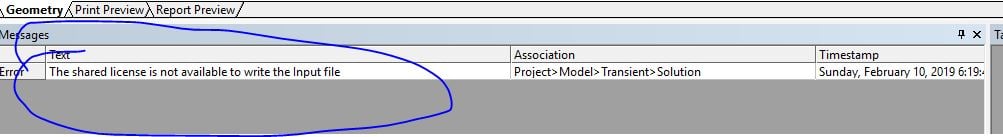

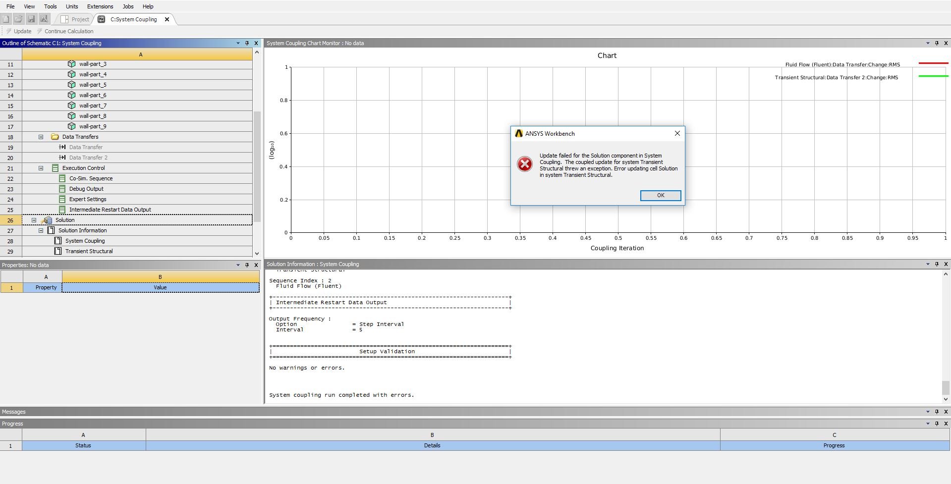

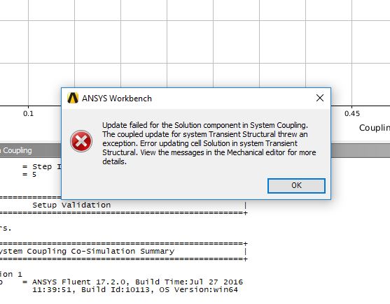

Hi, I am also using same problem to learn 2-way coupled problem. I have given all the conditions as is in video. But while solving coupled system, I am getting error " update failed for solution component in system coupling. The coupled update for system transient structural threw an exception. Error updating a cell solution in transient structural. View the messages in mechanical editor for more detail". In mechanical editor I have got the message " The shared license is not available to write the file". I am using workbench with Research license. Can you please tell me what may be the probable reason of this error.

SubscriberIn transient solution information I am getting the message "MAPDL is unable to connect to the system coupling service on 0.0.0.0 through port 50293. Please check ANSYS execution options -schost and  -scport for a System Coupling analysis and ensure that the host name   and the port number are correct".Â
Any help will be beneficial for me.Â

Subscriber@FAHIME99, this problem occurs some time due to antivirus installed in your system. So if you have installed antivirus in your system then remove it. this may work.
