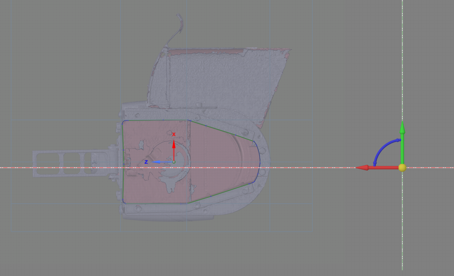

      Should the intersecting green and red line be at the center or my sketch plane or at the origin marker?   Im having issues keeping solids in alignment when using the mesh surfaces, so I have built a cube of planes based off the world origin to use as sketch starts.

      The sketch plane gets created on the center of the selected facet when using such STL files.
      If it's a surface, then it gets created at the center of the surface. You can use the "Move gird" option to move the gride center as per your requirement.
