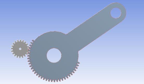

      Ok so I managed to make this new pinion (with fillet) and do a simple analysis:
      What I cant figure out is how I use a single pinion with a gear instead. I do not know how to replace the upper pinion with my original gear.
      How do I go about that?

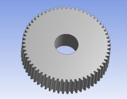

      I have already created the gear in a separate geometry:
      What do you suggest?
      Thanks a lot for your time and effort.

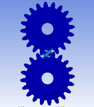

      So I managed to make this:
      I just made two planes and choosed the center distance as the y-offset. This is probably wrong as well, because as you said I get a warning that the one or more bodies might be underconstrained.
      That's a good start.

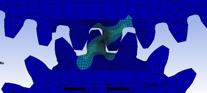

      All that blue means that 99% of the model was doing nothing.
      You can slice out a sector of each gear that includes 3 or 4 teeth around the contact point. If you do that you will be able to put more nodes into the area of interest and not waste nodes that have no stress on them.

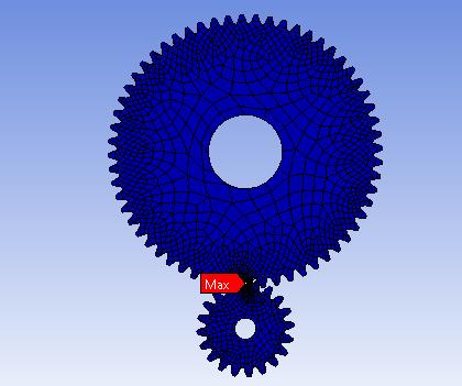

      I think I figured it out:
      I used the slice function in DM.
      Well done.
      You can also slice approx. a 30 degree pie slice about the center of each gear and suppress those solids that are not part of the contact.
      The highest surface stress in a 3D gear is at the center of the thickness. A 2D Plane Strain model can provide a good estimate of that value.

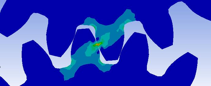

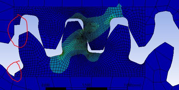

      My last concerns are these:
      Is the stress distributed correctly at point of contact? Should the stress not be largest at that point?
      And also, I can see that for some reason that some of the pinion and gear are missing. Does this affect the results?
      And lastly, is there anything I can do to verify this Analysis, maybe my hand calculations?
      Thanks!
      Here is a hand calculation website for gear tooth.

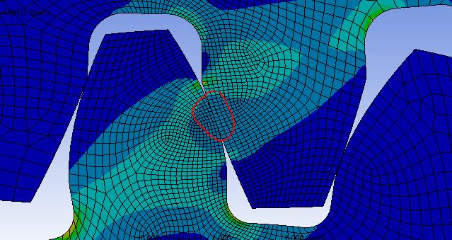

      In the bottom image, look at the top gear; see how the stress contour line between blue and light blue has a discontinuity at the slice boundary? That is evidence that the slice boundary is too close to the teeth.  Compare that to the bottom gear where the stress contour is smooth.
      Gear teeth more than one tooth away have no effect on the stress result so you don't care about the shape of the mesh there. If you follow the pie slice approach, then you won't even have those teeth in the model.
      While you are in DM doing the slicing, select all the bodies in the Outline, right click and select Form New Part. That will put all the pieces in a new multibody part with Shared Topology. That means the mesher will mesh across those bodies and you won't need any bonded contact to hold the pieces together.
      You don't show a legend in your contour plots so I don't know what you are plotting and there are many components available to plot. Some will have high values near the point of contact and others will have low values near the point of contact.   You can also add a Contact Tool to the results and insert a Pressure result to see the surface pressure at the point of contact. That will definitely have its maximum value at the point of contact.
