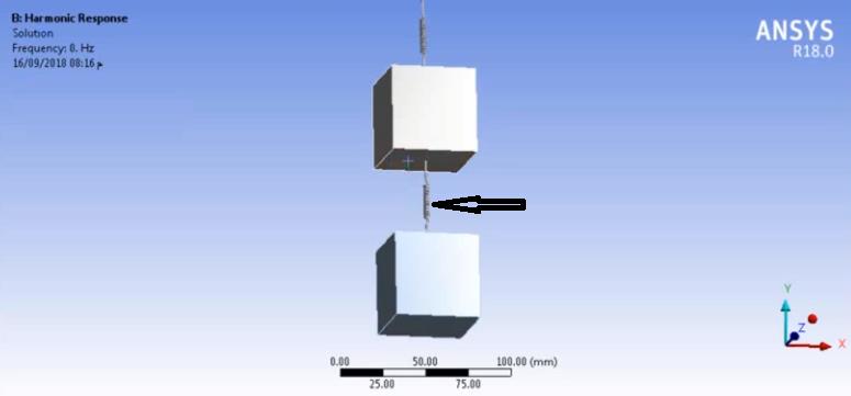

      I have 2 masses and I need to add damping value to the marked spring, How can I do it ?!
      Damping is available in the Spring Details window where you entered the spring rate.
    • Abdelrahman
      8).jpg?width=690&upscale=false" alt="">
      Enter a value for Longitudinal Damping.
      That is c in the 1 DOF dynamics equation:  m*a + c*v + k*x = F
      The Longitudinal Stiffness is the term k in the above equation.
    • Abdelrahman
      Ooh, I did not see it
      Thank you for help
