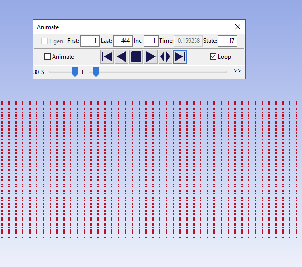

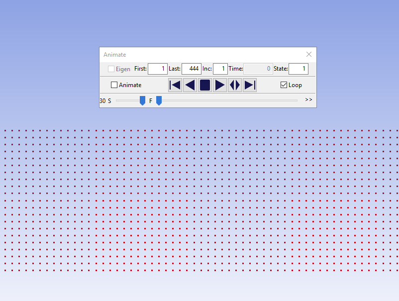

      I am trying to simulate a wave tank using the SPH method. The model consists of a contained made of rigid 3D elements, a piston made of rigid shell elements, and water modelled with SPH particles. The issue I am having is when I apply gravity to the model using LOAD_BODY_Z and a load curve of 9.81 m/s^2, the particles collapse to the ground. This is illustraded in the attached screen shots. Note that there is no leakage from the container, the particles simply fall straight down. Any help on this issue would be greatly appreciated. Thank you!

      How the wate is constriained?
      cheers, ram

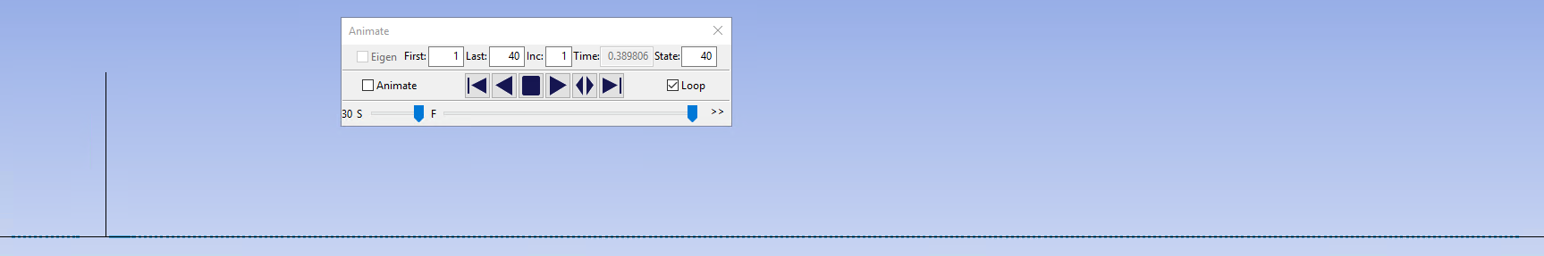

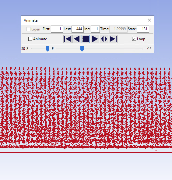

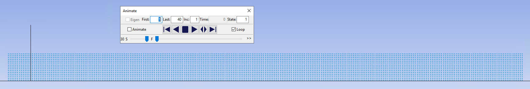

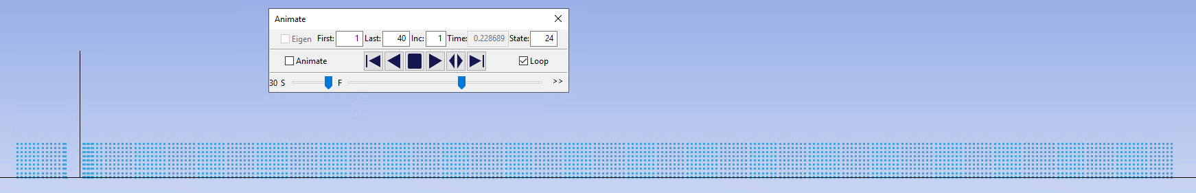

        Hi, apologies for the late reply. I have since been able to model the wave tank but now there appears to be another issue, which is the amount of particle mixing. With the piston (wave maker) deactivated, the only load which the particles are subjected to is a gravity loading, applied with the LOAD_BODY_Z keyword. In my mind, if there are no loads directly applied to the water within the tank then there should be no particle movement, but thats not the case. The particles appear to move spuradically and I do not know why. I have attached screenshots as well as my keyword input file (note that the piston is active in this file) to illustrate this. If you know how to correct this issue I would greatly appreciate a response. Also, please ignore part #6 contained in the file, it does not make contact with anything and is only there to serve as a visual aid on the wave height.
        IMAGES WITH ONLY GRAVITY LOADING APPLIED
        KEYWORD INPUT FILE
