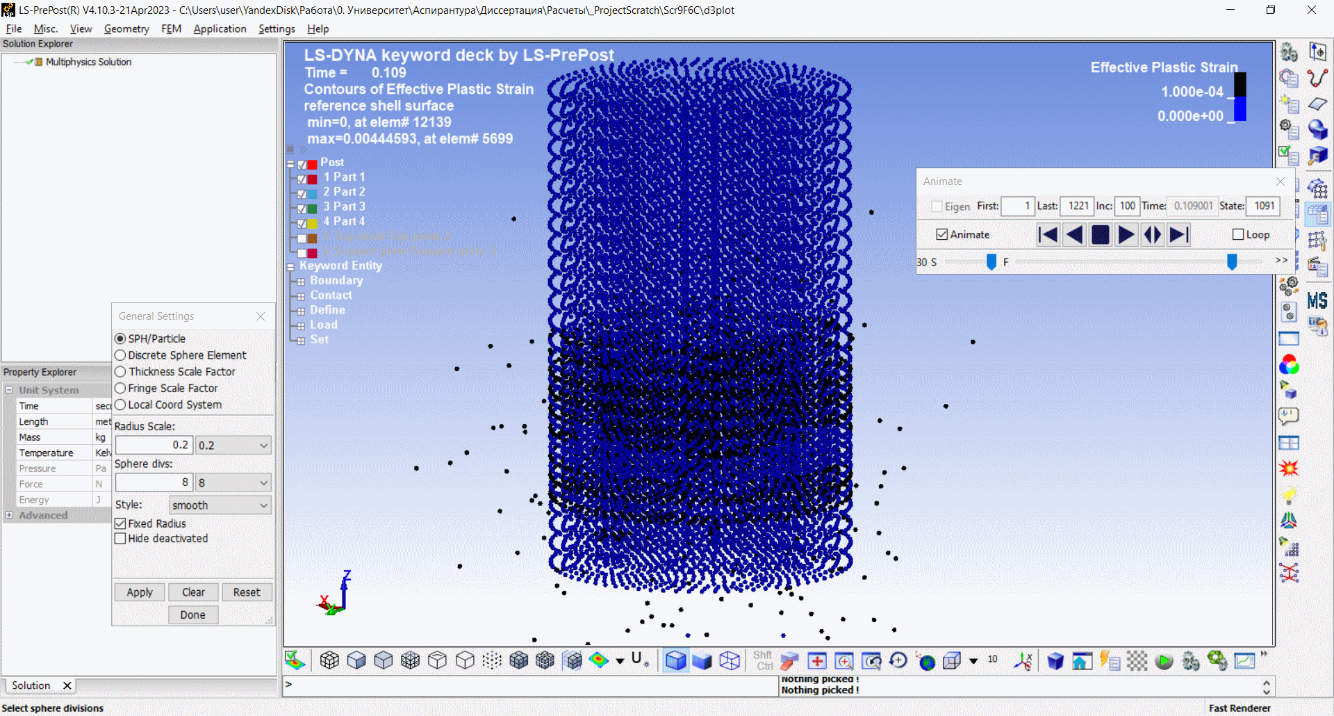

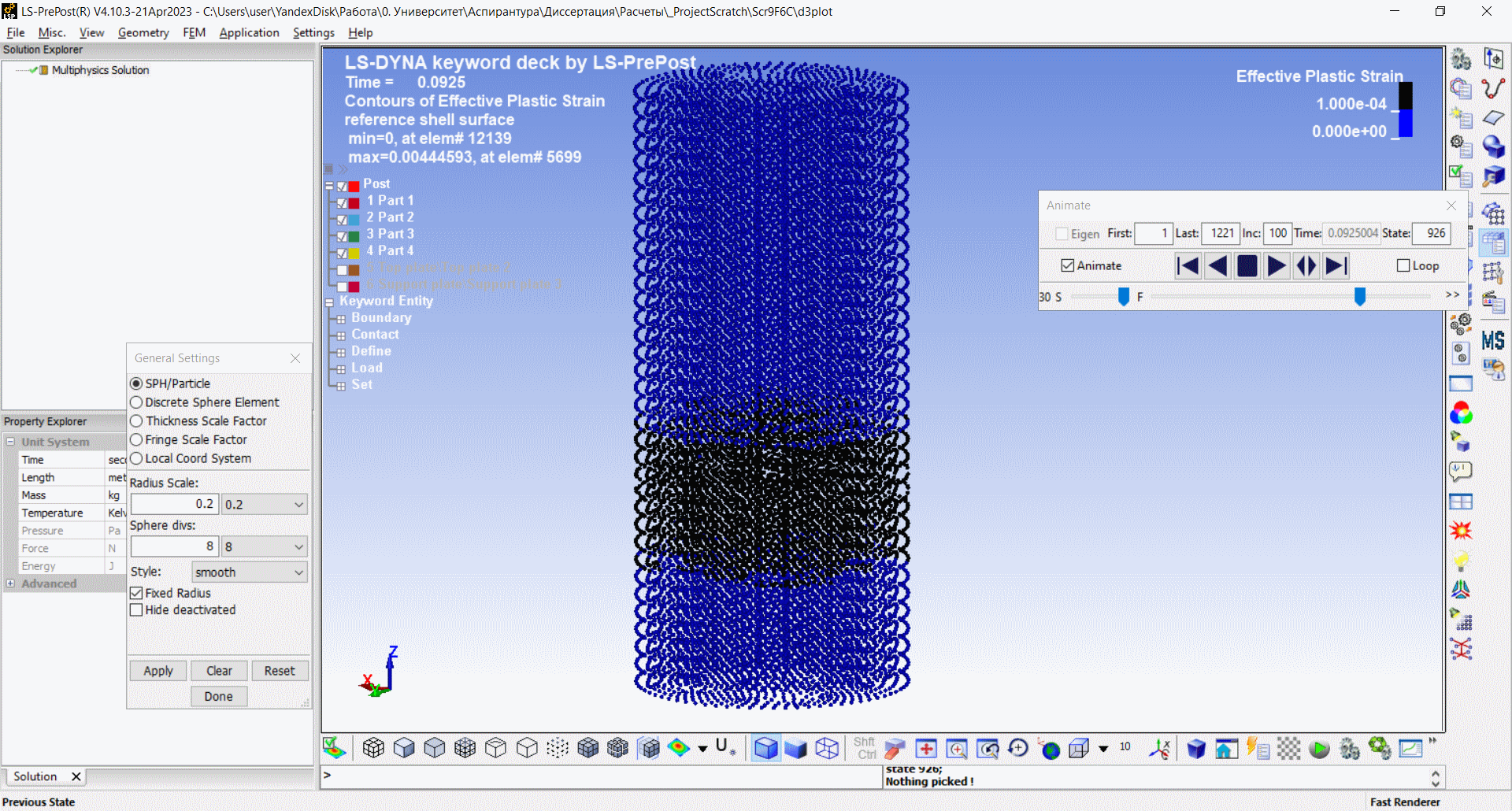

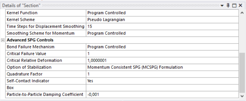

      I am trying to model uniaxial compression test of cylindrical specimen using SPG method in LS-Dyna R13.1 in Workbench. I use MAT_024 to define yield stress and MAT_ADD_GISSMO with very small strain to failure (LCSDG) to model "brittle" fracture. IN SECTION_SOLID_SPG I set IDAM = "Programm Controlled" and Self-Contact Indicator (ISC) equal to YES (1). So I hoped that destroyed particles will interact with each other even after specimen crushed.
      But when the specimen was crushed the two halves started to move towards each other and I see the penetration of the material (see figures). Therefore the particles don't interact with each other.
      Could someone explain why is that so and how can I fix this?

    • dadidal96
      Thank you for your answer!
      1. As mentioned before I've already tried to use option b (SECTION_SOLID_SPG, ISC) to include self-contact handling as you can see in the figure below. But it is not working! This is my exact question: why is it so and how can I fix it?

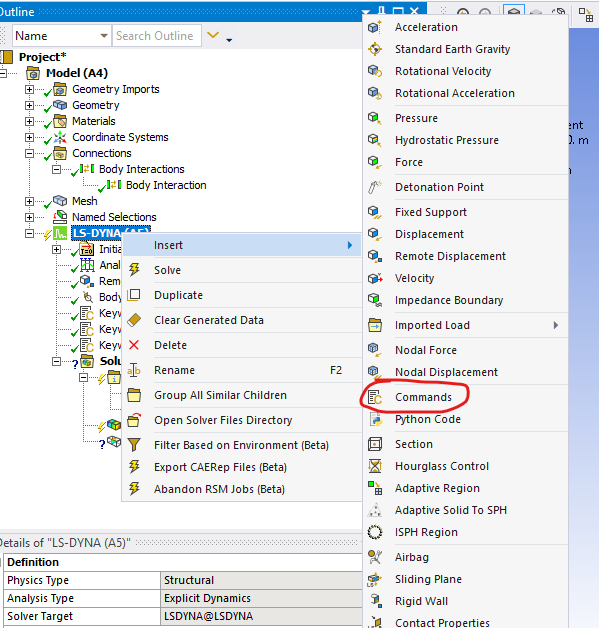

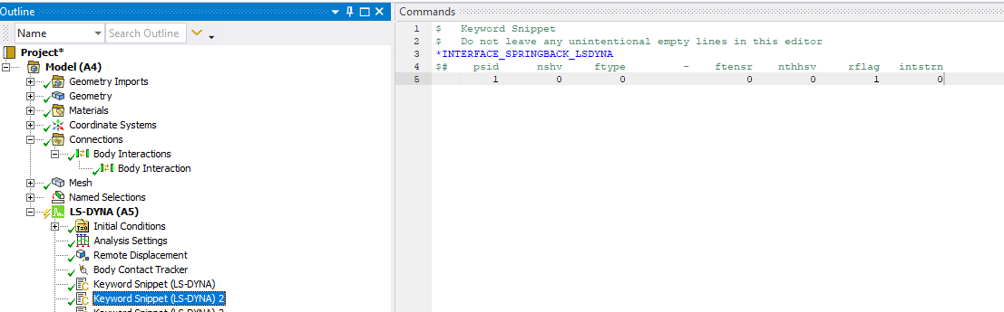

    • Andreas Koutras
      If *CONTACT_SPG is not available through the WB GUI, you can copy the *CONTACT_SPG keyword into a keyword snippet as follows.
      • dadidal96
        I added *CONTACT_SPG card to my simulation using the keyword snippet as you advised, but crushed parts are still penetrated when I use penalty factor = 1.0 (see figures below). As I understand the penalty factor is the fraction of material elastic modulus, right? A good picture I can obtain only when I use penalty factor = 1000 but in that case the initial stress inside the SPG body becomes very high. If I set penalty factor = 1e06 my sample crushes at the very beginning of the simulation. Therefore I still don't understand what is an appropriate value for penalty factor and how to adjust it?
