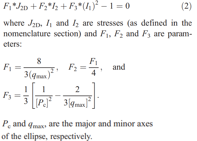

      • dadidal96
        I want to model brittle material (ice) with elliptical failure criterion (figure below), which is both temperature and strain rate dependent.
        For current step I don't need any material yielding / plastic deformations. I want to model the material with orthotropic elastisicty and failure according to criterion in Fig. below.
        If it is possible with SPG and UMAT it would be great.
        1. Or may be I can modify some special parameter in UMAT that will address creterion in MAT_ADD_EROSION when failure criterion is met? Therefore bond failure will occure because some MAT_ADD_EROSION criterion is met, but this quantity will be met because of some parameter inside UMAT
        2. Or can I set this failure criterion as yield criterion (yield surface) and use very small critical value for effective plastic strain (IDAM=1) to model material failure in this way?
    • Andreas Koutras
      Hello Oleg,
      Here are the suggestions of the developer for your problem:
      "SPG can use effective plastic strain, first principle stress, maximum shear strain or GISSMO damage value as bond failure criterion.  According the description from the user, my suggestions are:
      1.  MAT_ADD_EROSION with UMAT's history variable is not suggested. SPG doesn't use element erosion, but bond failure.
      2. User can use MAT_ADD_DAMAGE_GISSMO uses HISVN to define the history variable to accumulate damage value. Then use IDAM=0 to use damage value to failure bond. Set dtype=0, don't delete elements. As I mentioned, this way is not verified with SPG.
      3. IDAM=1 with very small EPS should work. It becomes a ductile failure.
      4. Alternative way, user can try to set the stress of material points to zero when criterion match. Then use IDAM=3 and bigger stretch to fail bond. I cannot grantee the performance since it is brittle failure. The brittle failure is very sensitive."
      • dadidal96
        Thank you for your answer. Now I see the possible ways.
        I want to use option #4 that you mentioned but with another implementation. Instead of setting the stress to zero and using of stretch to model material failure, can I set the first principle stress to an extremely high value, which is not normal for ice-like material (for example 500 MPa), and use IDAM=2 to model the failure? Will be brittle failure more stable in that way?
    • Andreas Koutras
      Hello, for IDAM=2 you can use the tensile strength of your material. Once this is reached bond failure will occur preventing the principal stress to increase further.
    • Andreas Koutras
      Consider also Option 2 which provides additional flexibility given that you specify a history variable from the umat to control the damage.
