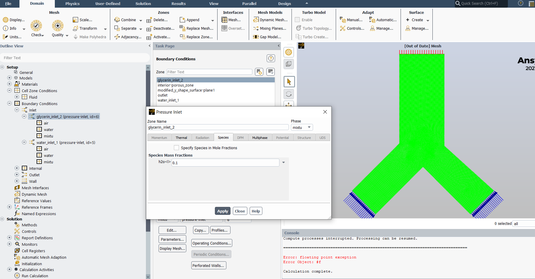

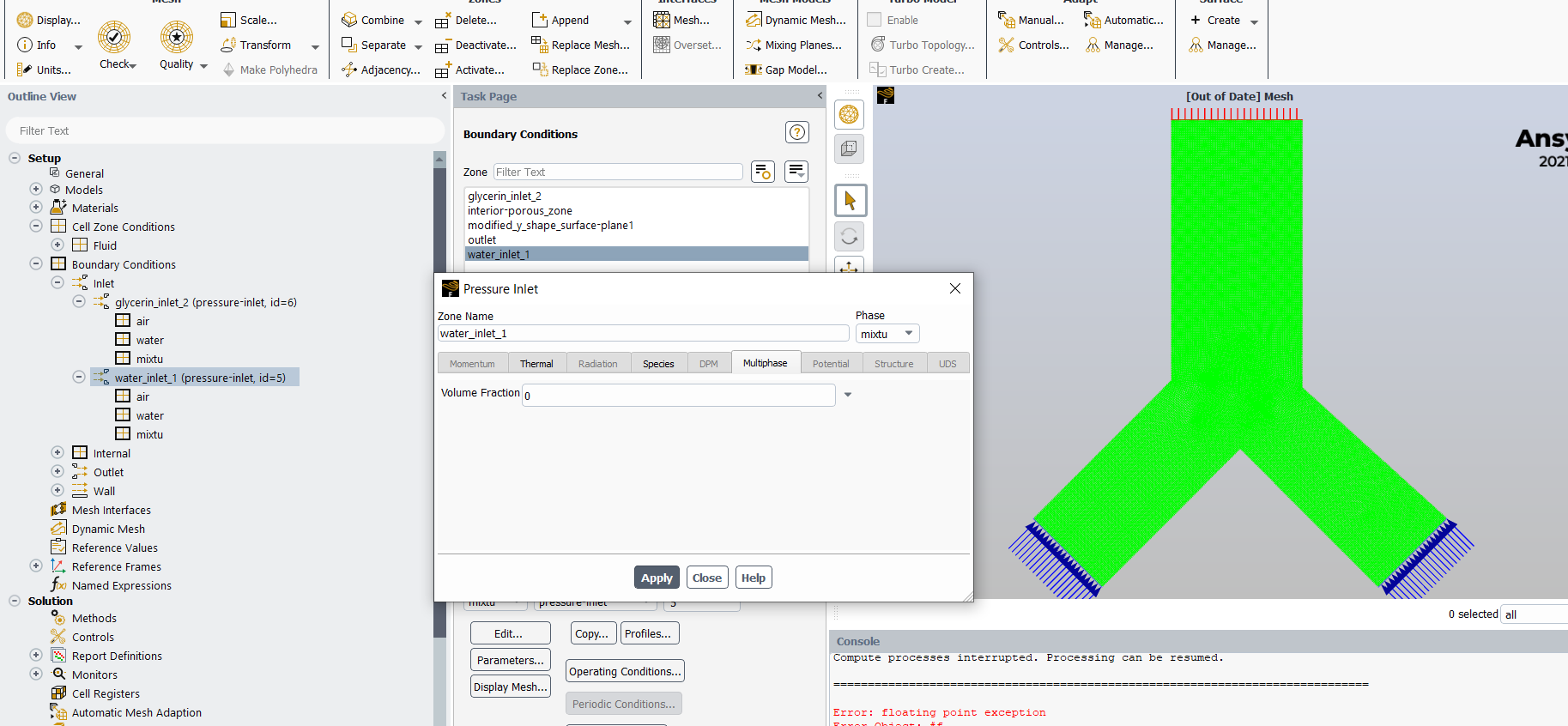

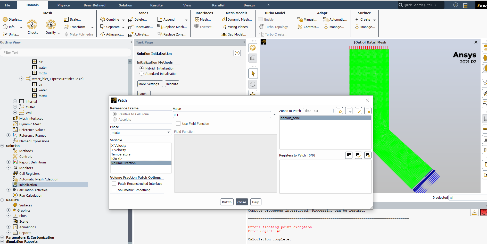

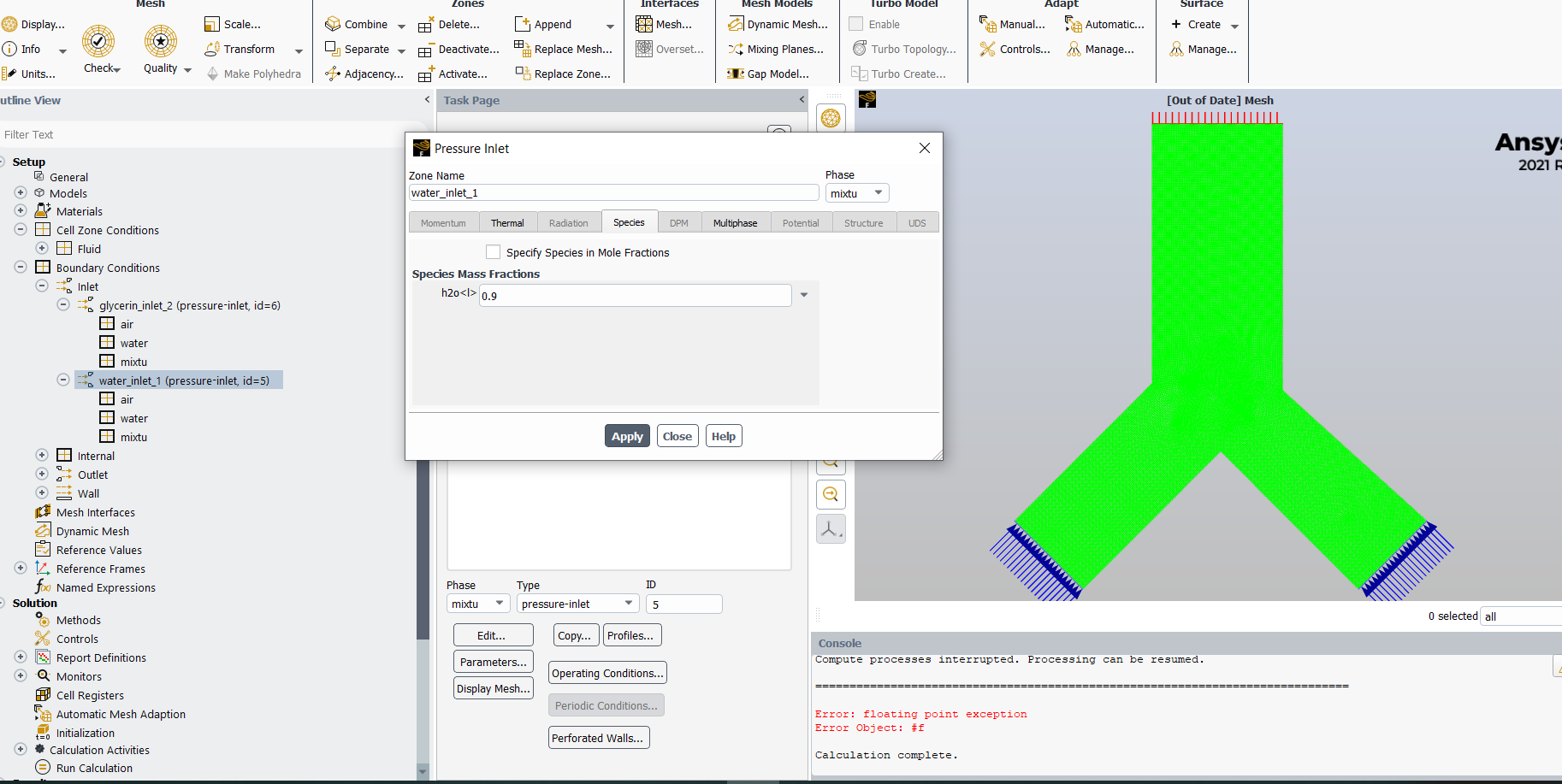

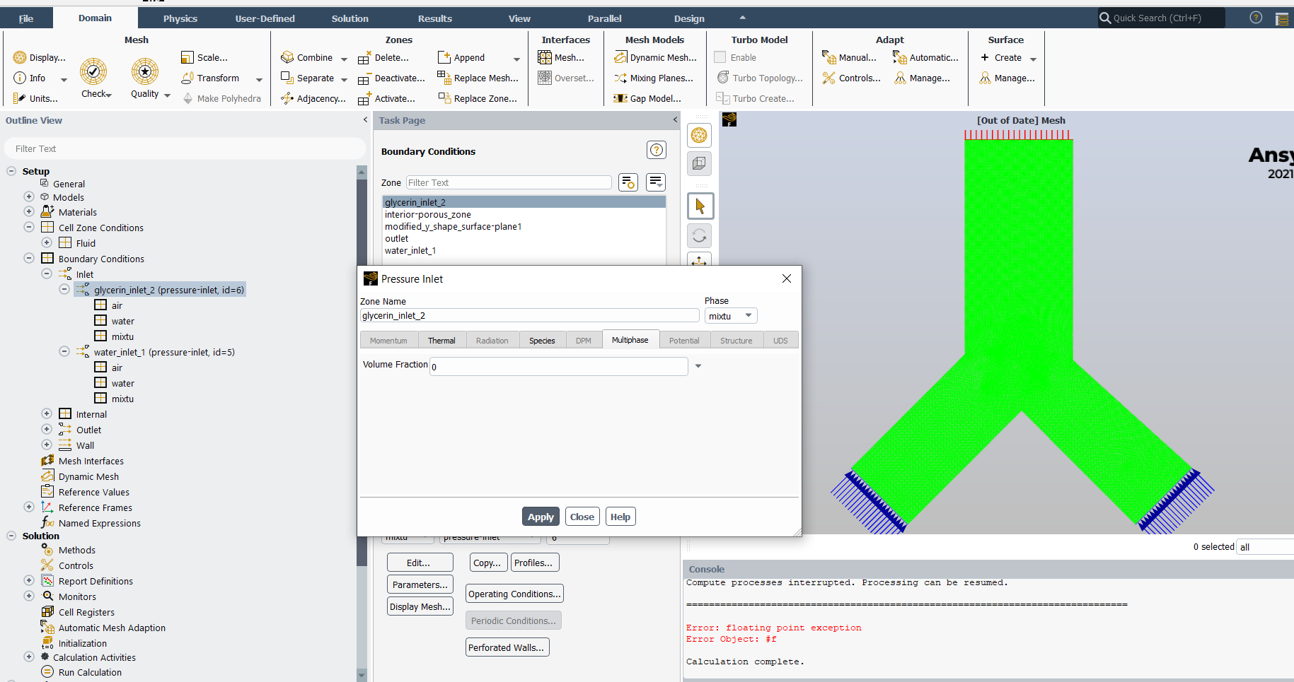

I am using the eulerian multiphase and species, transport model. My concern is to specify the value of species volume mass fraction and multiphase volume fraction at the inlet ( water inlet at left), inlet 2 (glycerin inlet at right). Additionally, while patching, I want to keep the fraction of water and Glycerin both 0.1 in the porous zone to converse the solution. I am attaching the (.PNG) file. Kindly look into it, and help me specify the value.Â
I used a volume fraction of 0.9 at both inlets and a mass fraction of water 1 at the left inlet, mass fraction of water 0 at the right. inlet. I ran the simulation and found a floating-point error.
Kindly also specify the value of volume fraction during patching

SubscriberI am using the eulerian multiphase and species, transport model. My concern is to specify the value of species volume mass fraction and multiphase volume fraction at the inlet ( water inlet at left), inlet 2 (glycerin inlet at right). Additionally, while patching, I want to keep the fraction of water and Glycerin both 0.1 in the porous zone to converse the solution. I am attaching the (.PNG) file. Kindly look into it, and help me specify the value.
Kindly also specify the value of volume fraction during patching.

Ansys EmployeeThat value should be a user input: what is the state at start? Same applies at the boundaries: do you have in reality 90% Volume Fraction? Is it correct to assume pure water at one inlet and no water at the other?
September 14, 2021 at 12:38 pmAmine Ben Hadj Ali
Ansys EmployeeDo you require multiphase model at all? Do you have pure gas or pure liquids or both states in the system?
