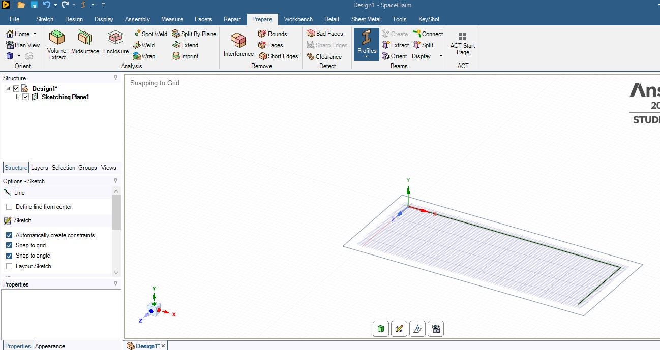

      Can some one help me to figure out why my profiles button does not show any profiles. When I click it does show any profiles (p.s: it worked before, but when I try to open a custome profile it suddenly stoppend).
      Here is a image of the issue.
    • Naresh Patre
      Hello @Raveesha
      It appears that the issue might be due to the Profile tool being added in the Quick Access Toolbar at the top left corner (see below image)
      Can you remove the Profiles tool from the quick access toolbar, then close the session and open it again and see if that helps to resolve the issue?

      This solved the issue for me. Thanks.
