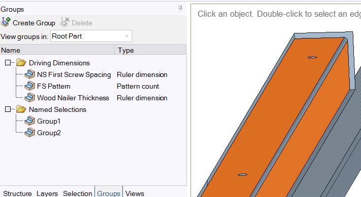

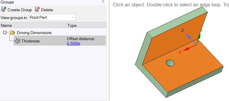

i used "offset" in "Create" Tab before to set up a parameter to change the thickness of steel angle. Below i was trying to use it and it doesn't create an offset parameter. Rather it creates a Named Selection Group. I chose the "Other Face" surface is split into three surfaces as shown below. Will this cause an issue? I am not sure what i am doing wrong.

Ansys Employeei think offset will not allow you to change the thickness. so you will not be able to create parameter for it.
please check help document.
/forum/forums/topic/how-to-access-the-ansys-online-help/
