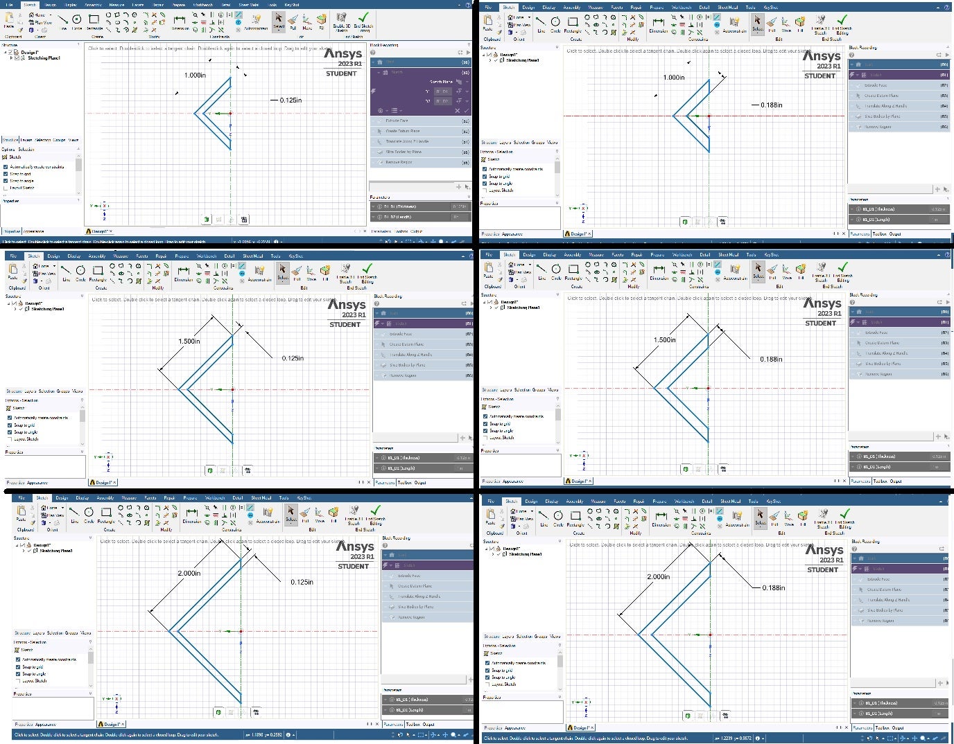

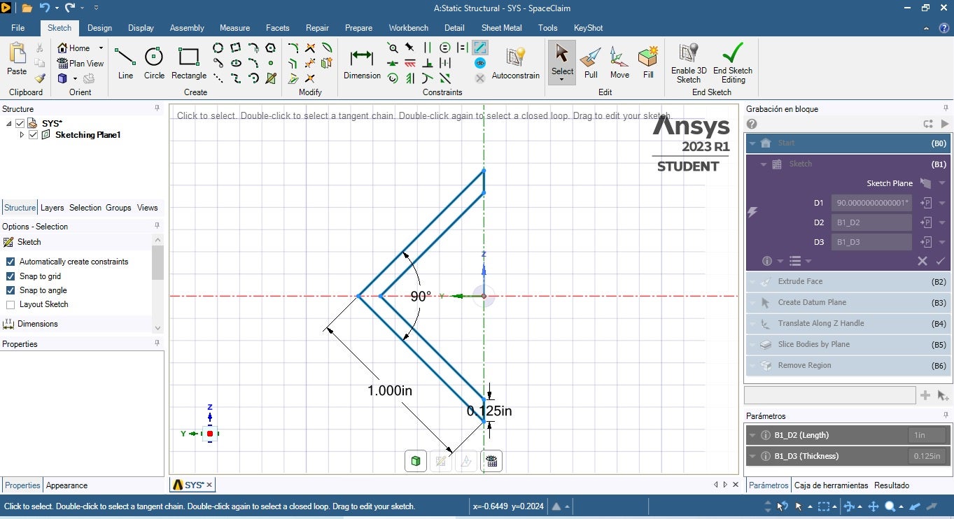

SubscriberI am making a parametric study on an angle Bar, in wich I am changing the length of its side and the thickness. At the beggining spaceclaims shows a fully constrained sketch, but later in the simulation when I see the next design points it show a distorted geometry that does not corresponds to the original. In the simulations I am using as input parameters "length" and "thickness" in the 3D model, and as output parameter the maximum stress.

Properly defining the Parameters (Can be checked using SpaceClaim via groups, Parameter Set window).
Ensuring proper constraints for the model, i.e. the angle, dimensions, etc.Â
Defining the accurate relationship of the parameters as per the user requirement.

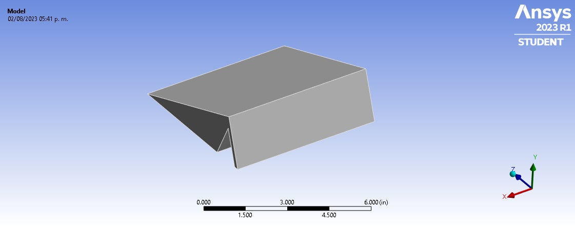

SubscriberI think the problem is with spaceclaim, because it is not keeping the constrains in the sketch.Â
The geometry should be an angle with both sizes of the same length and same thickness in both sides. The design points (inputs parameters) are the side length and thickness. But in further design points the sides are not equal, not a 90 degree angle between sides, not the same thickness.
