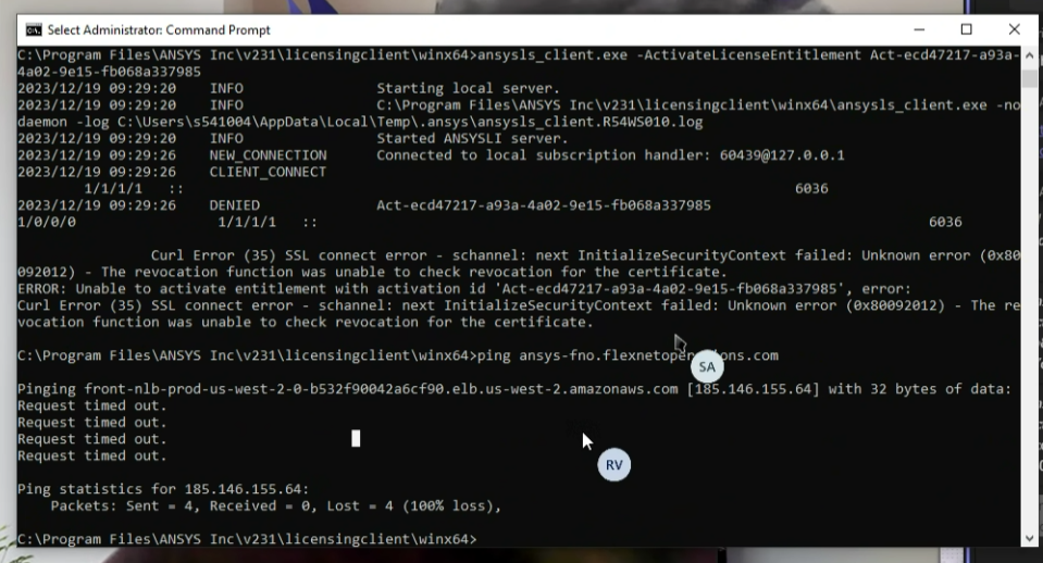

Our customer is having issue with the activation of license using CMD, Can you please assist?
Curl Error (35) SSL connect error - schannel: next InitializeSecurityContext failed: Unknown error (0x80092012) - The revocation function was unable to check revocation for the certificate.
ERROR: Unable to activate entitlement with activation id 'Act-cb83293b-61df-4043-814b-c7cff9b0e995', error:
Also "curl -v --ssl-no-revoke https://laas.fnocc.com is failing" -

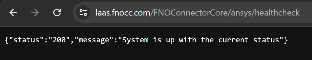

Must allow connectivity on port 443 to these sites:Âlaas.fnocc.comocsp.digicert.comocsp.int-x3.letsencrypt.orgflex1397.flexnetoperations.comr3.o.lencr.orgÂRun these commands:Âcurl -v --ssl-no-revoke https://laas.fnocc.comÂcurl -v https://laas.fnocc.comÂcheck https://laas.fnocc.com/FNOConnectorCore/ansys/healthcheck through the browserPost any and all errors encountered. -

Ansys EmployeeCan you have them run the commands and share the output from those commands?
Do they use a proxy?

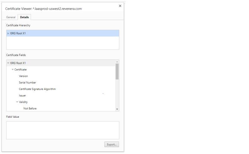

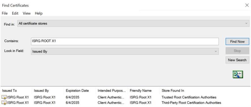

Install the latest DigiCert certificate: https://discoveryforum.ansys.com/t/h4gzdg
Make sure they have the ISRG ROOT X1 certificate.

Forum ModeratorHello Syed, did you confirm the certificates?
