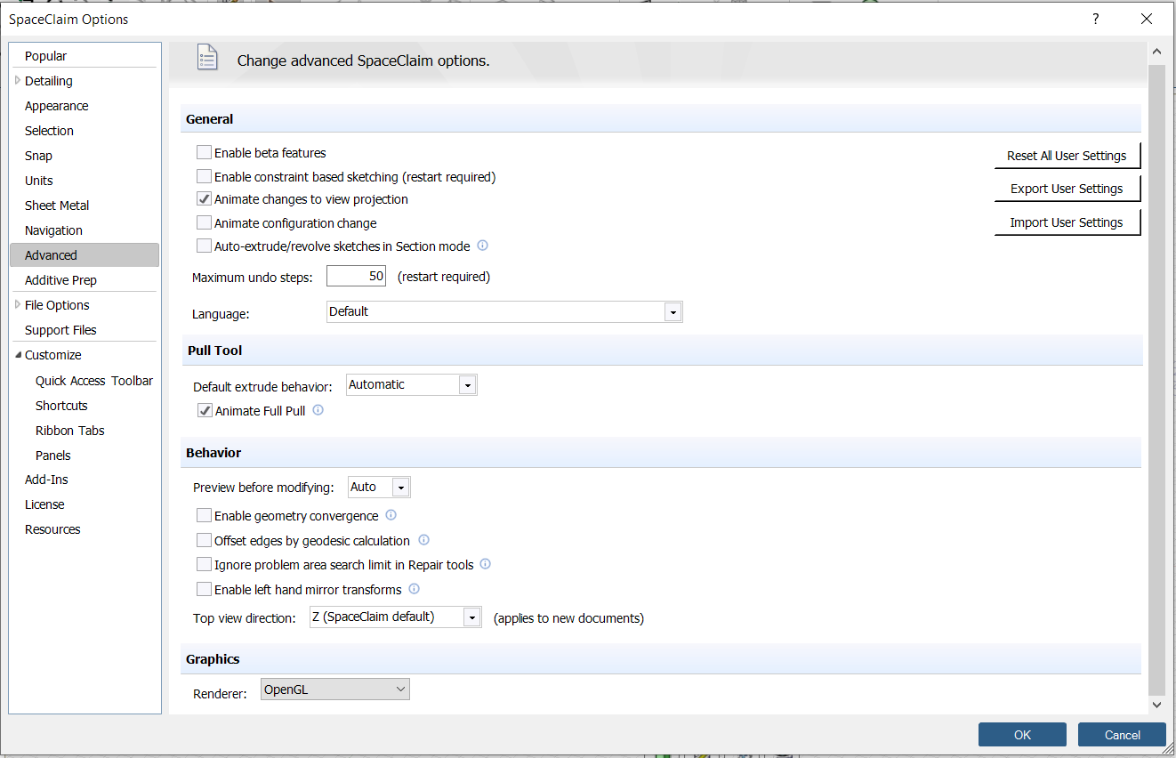

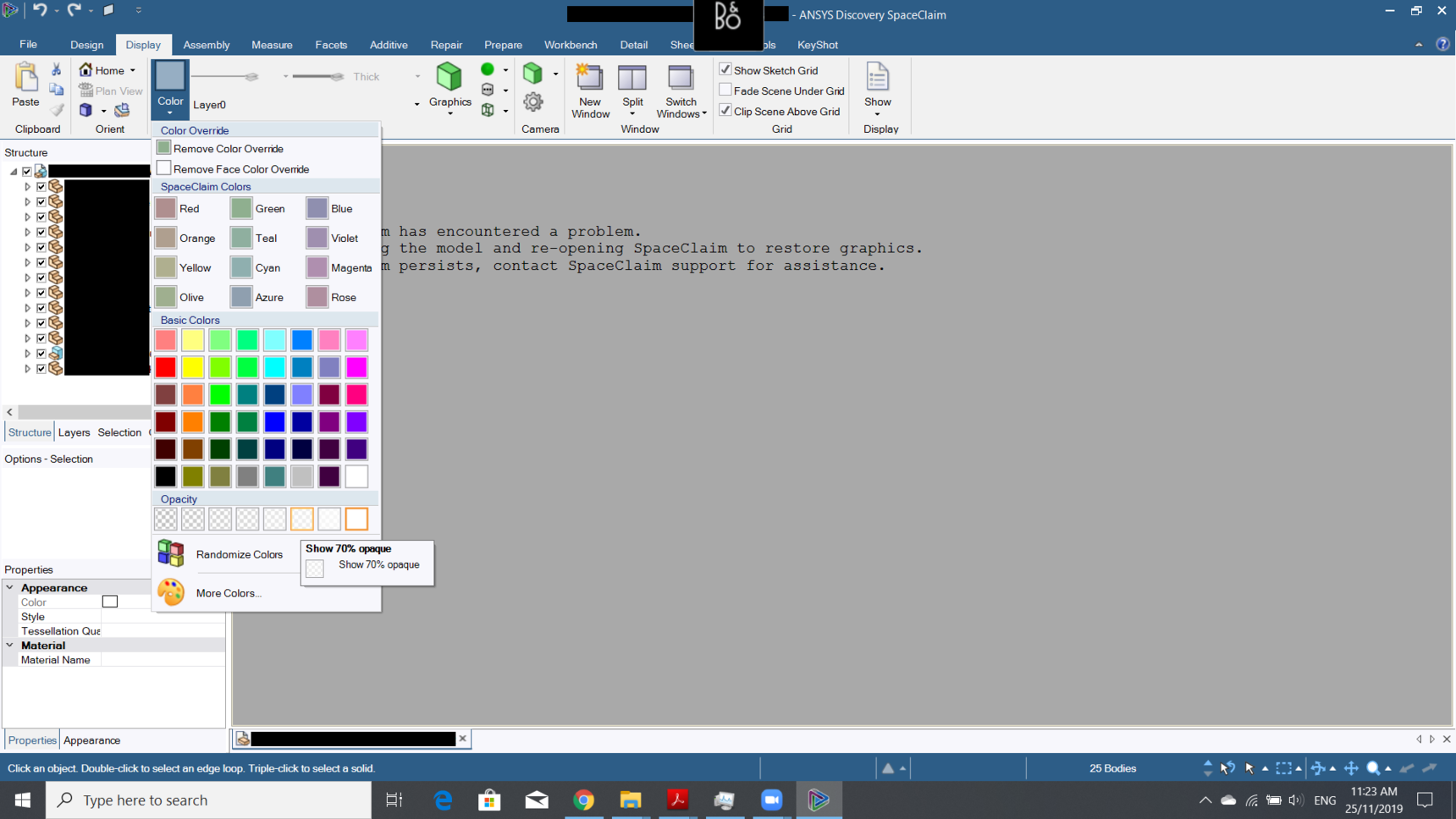

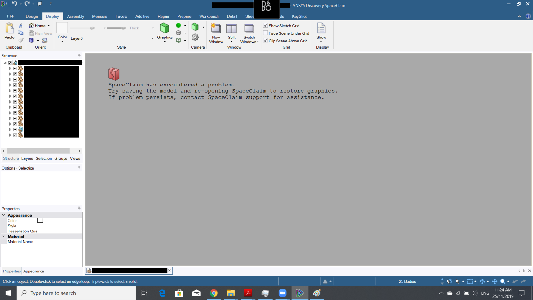

I was trying to adjust the opacity of a customer's geometry in Discovery SpaceClaim 2019 R3. I selected everything and changed them to 70% opaque, and then I got this error:
SpaceClaim has encountered a problem.
Try saving the model and re-opening SpaceClaim to restore graphics.
If problem persists, contact SpaceClaim support for assistance.
Screenshots are attached, as well as my Graphics settings. I tried both 2019 R2 and R3, and got the same error. I also tried opening .scdoc file and .x_t files and got the same error.

I'm unable to reproduce this issue with both 2019 R2 and 2019 R3 versions and with .x_t and .scdoc format.
Could you please 'Export User Settings' and share it with us?
Could you also try the same steps again and share the latest log file it creates. You will find the log file in the below default location.%AppData\%Roaming\SpaceClaim\Log Files

Forum ModeratorHello Jun
Also, can you please confirm if you have updated your graphics drivers to the latest version from the Graphics manufacturer's website? If not, please update the drivers and try again.

Thank you for your reply. Please find the attached exported User Settings file, as requested.
Unfortunately, Windows can't find the location "%AppData\%Roaming\SpaceClaim\Log Files".
Ok I will update my graphics driver.

However, I've installed 2020 R1 and it seems to be working fine now.
